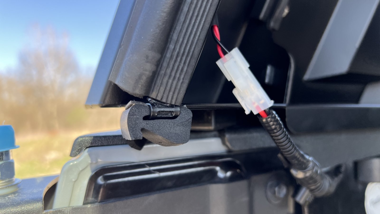

    Got my EVOa on this weekend. Only issue I have is that the tailgate hits the D rubber seal hard and it is difficult to close. I thought I saw a few posts about this in the thread about it having to do with the front to back position but all I found was one on page 65 that mentions cutting down the D rubber. Is that what everyone is doing?

    I trimmed mine at an angle for a proper fit. See the the rubber match with the hatch rubber.
    To reduce the wear (seem to work -hopefully), I close the tailgate first, then the hatch. - Open hatch first, then tailgate.

    I asked RSI the same thing a couple of weeks ago, and this was their reply:
    Adding shims below each of the rear most spacer blocks will help reduce the friction when opening and closing the tailgate.
    As a tip, shave off some of the D rubber directly above the tail gate, ensuring not to cut the rubber flap off. By doing this, the thickness of the D rubber is reduced which in turn will reduce the friction on the tail gate and make opening and closing a lot easier.

    I keep silicone spray handy and hit the gasket and top of the tailgate from time to time.
