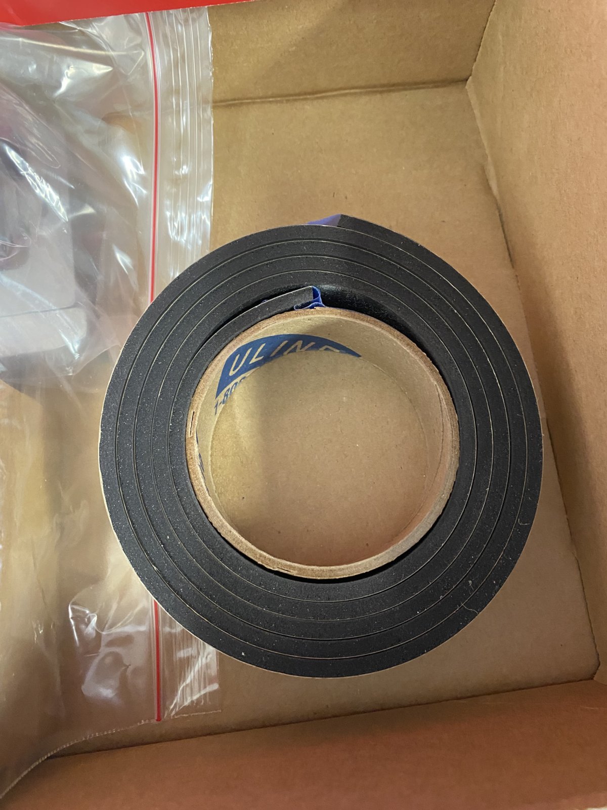

    A dumb question…. 2019 short bed with an EVOA cap.
    - the box of parts includes a small roll of flat foam gasket. There is nothing in the install instructions about this. Where is this supposed to go?
    Or is this just extra in case you damage some of the factory installed foam gaskets when attaching all the panels together?

    Just did my install two weeks back. That foam is for the portion of the bed against the cab. If that is lower than the sides, you use that foam to build up the lower portion to be level. I didn't use it (or the thin pads under the caps for that matter).
    (Edit: Clarified which pads/location were not used)

    You need to use the other pads to space the cap up so that the bulb seal along the bottom isn't crushed.
    I didn't need the flat foam to build up along the front but I did use pieces to close up the gap at the front corners.

    You are correct... The thick ones are necessary... I should have explicitly stated the skinny thin ones (that go under the bed caps).

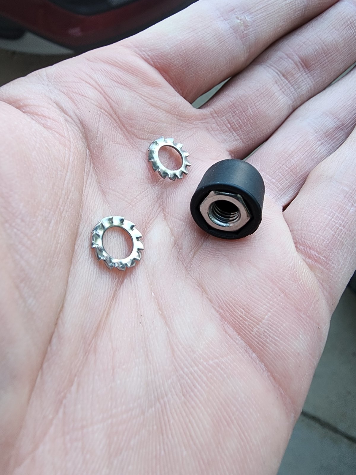

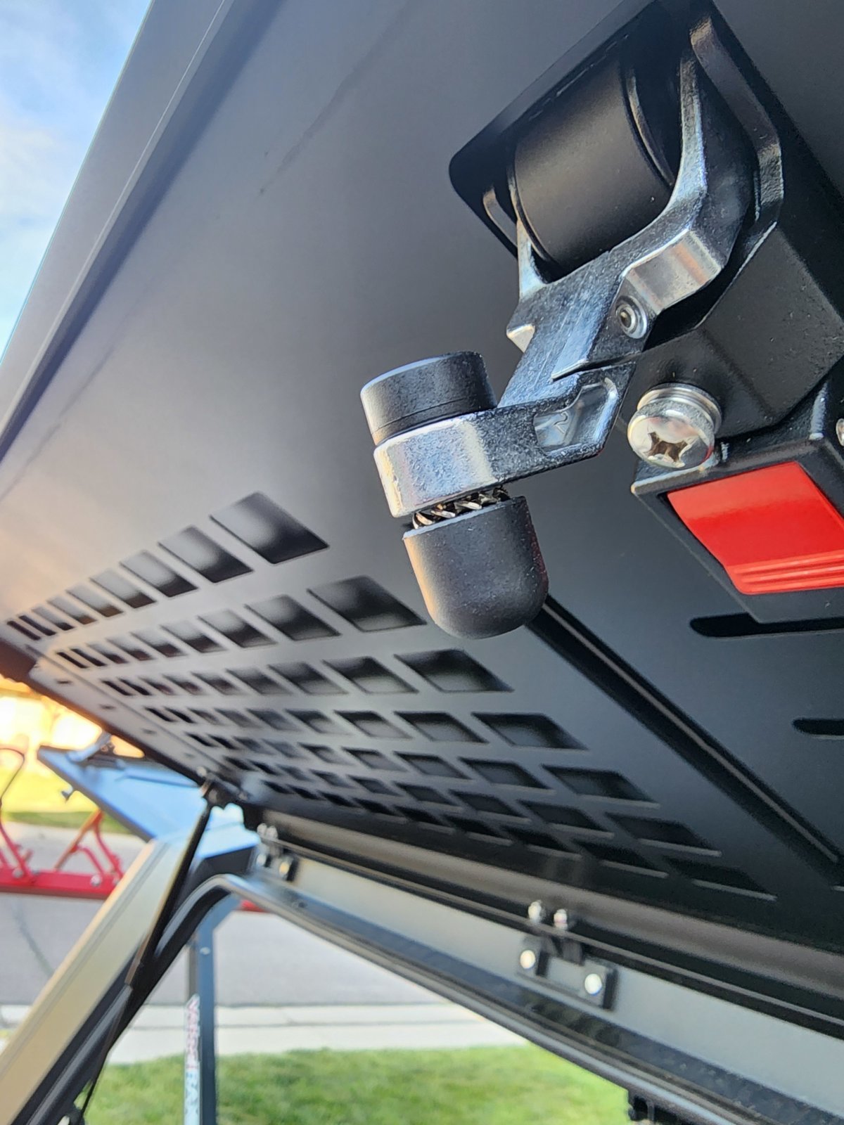

    Make sure you check the covered nuts on the inside of the latches also. Found parts in the bed I did not know what they came off of. Finally discovered last night and now need to get another nut as I only found one.

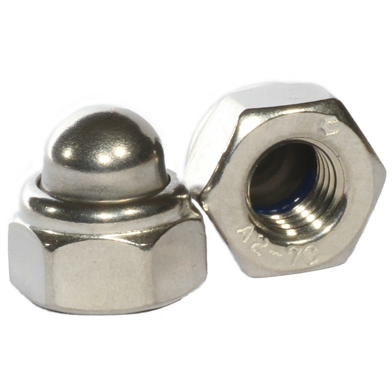

    I replaced those stupid caps with dome nuts, because the plastic caps kept falling off. Be sure to loctite them, or they'll back off too.
    TacomaWorld2023 likes this.

    I’m having the same problem. Luckily, each time the nut and washer has fallen in the bed, but it’s a matter of time before I lose it.
    May have to try a split lock washer.

    Lost a couple of mine as well. What size dome nuts did you go with? I need to do the same.

    I don't remember the size, I just pulled one of the nuts and brought it into the hardware store.
