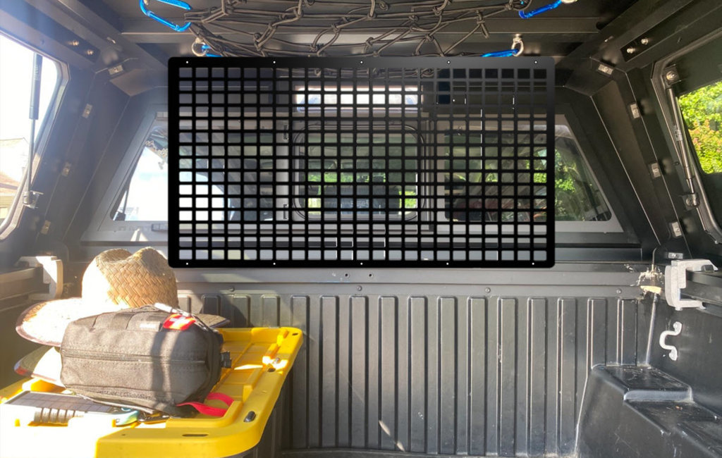

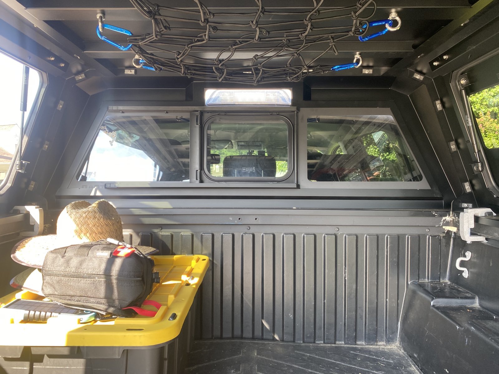

    I actually went ahead and designed a custom molly panel using OnShape (free CAD software) and Xometry (rapid prototyping).
    The order from Xomertry ran me ~$250 and will arrive in a couple weeks, power coated black, standard steel.
    It will bolt in using the existing hardware for the roof/ back panel interface with the assistance of a washer a spacer.
    The bottom hardware is spaced same as at the top and will required some minor drilling/ hardware into the inner lip of the bed rim.
    Here's a taste of what it will look like....

    If it was a little taller, you could use the existing threaded inserts, just below, that are there for the non-existent 3rd gen rear bed rail.

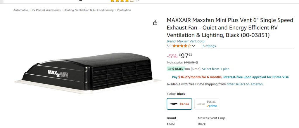

    Yes. You could certainly install a Max Air fan.
    You'd then need a separate power source such as a Goal Zero to power it.
    But hey, now you could run a fridge off of the Goal Zero.
    There. I just spent $2k on ventilation.
    I just keep going until I realize I can't convert the back of my truck into a Sprinter Van. Then I make a spreadsheet of my Sprinter Van build. Then I do a calculation that shows My Sprinter Van build minus the resale value after 10 years is equal to 30 nights a year in a $300 a night hotel.
    After all that, I grab a pad, a bag and sleep in the back of my truck under my topper.
    I then wake up in the morning beaming in self congratulations for all the money I saved by once again not acting on any of my wild ideas.
    A few weeks later, I repeat the entire process.
    Didn't know Max Air Made a 6 inch. Wish it was black.
    https://www.amazon.com/MAXXAIR-Maxx...s=maxxair+fan+mini&qid=1725457970&sr=8-1&th=1

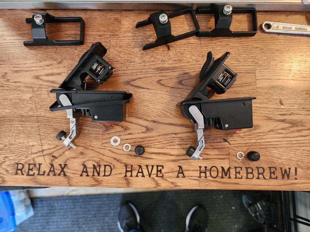

    Anyone have issues with the new style latches? I noticed the other day I can just pull open the side panel when it is latched and locked. It even popped open while driving with nothing in the back. There is a replacement set on they way that RSI got out quickly and clearly stated would not have the issue.

    Received and installed the replacement latches. They are a little more firm when securing. All of them have the longer threaded stop and have changed over to a standard lock and flat washer setup. On the original set, only my rear hatch had the longer stops. Much more adjustability on the gullwing doors now.
