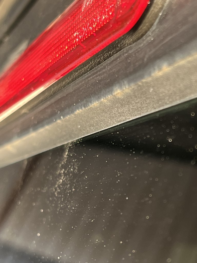

    My other claim that I sent inIMG_6584.jpgAll around the back glass is starting to get rust spots. I’ve contacted smartcap and they’re looking into what to do next.

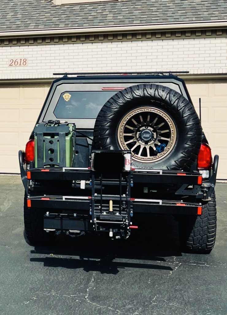

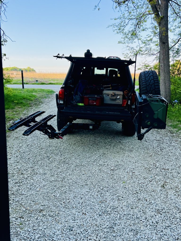

    Yes I am using a 6” drop extension to clear the tire. It also gives me the option to not open the bike carrier swing. I can just open it and it’ll clear the tire holder swing.
    This is a picture with both swings opened:

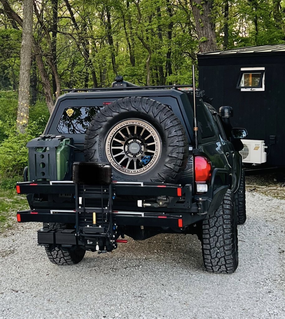

    This is closed:

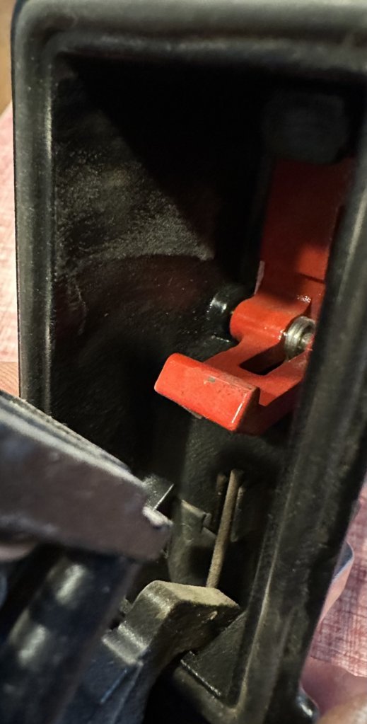

    From what I understand after dealing with 4 total sets of locks (2 replacements for the original red-button locks, and finally a set of the older model locks) is that the defect with these red button locks is that the manufacturer applied too much paint to the inner red latching mechanism, pictured. I've heard some people have disassembled these and used a file to removed the paint and restore the angle needed to latch.
    I went through hell on two separate multi-week trips fighting with these locks. First one lock would begin to pop and eventually each gull wing door was popping completely open, vibration/speed/terrain was irrelevant, so I had to strap them down to my decked D rings with a loaded bed. You can imagine the frustration.
    Both gullwing doors swung open at highway speeds on separate occasions, nearly damaging the panels.
    My advice - Until RSI gets the manufacturer to fix the issue and produce working locks - just request the old style locks. They're solid.
