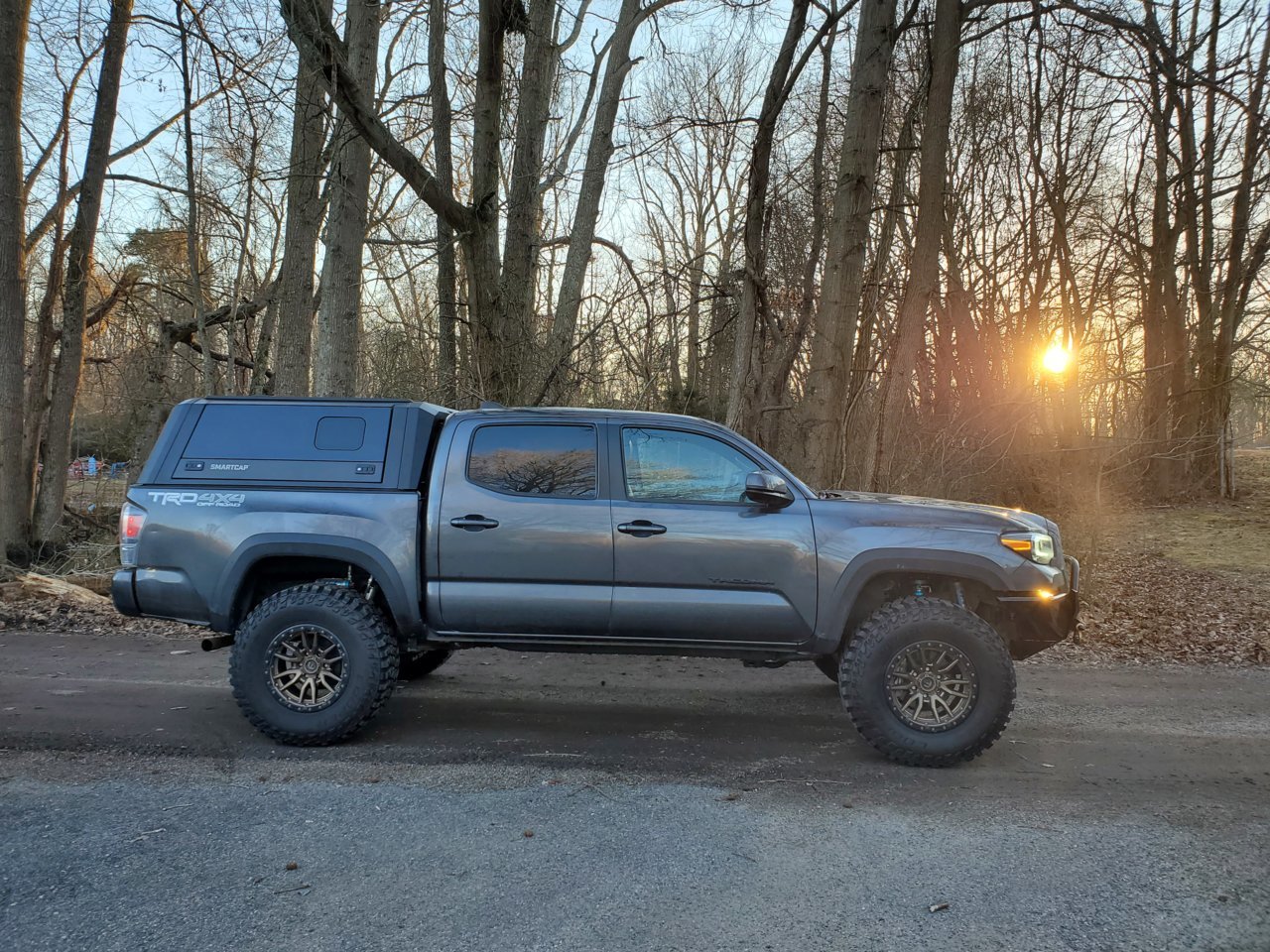

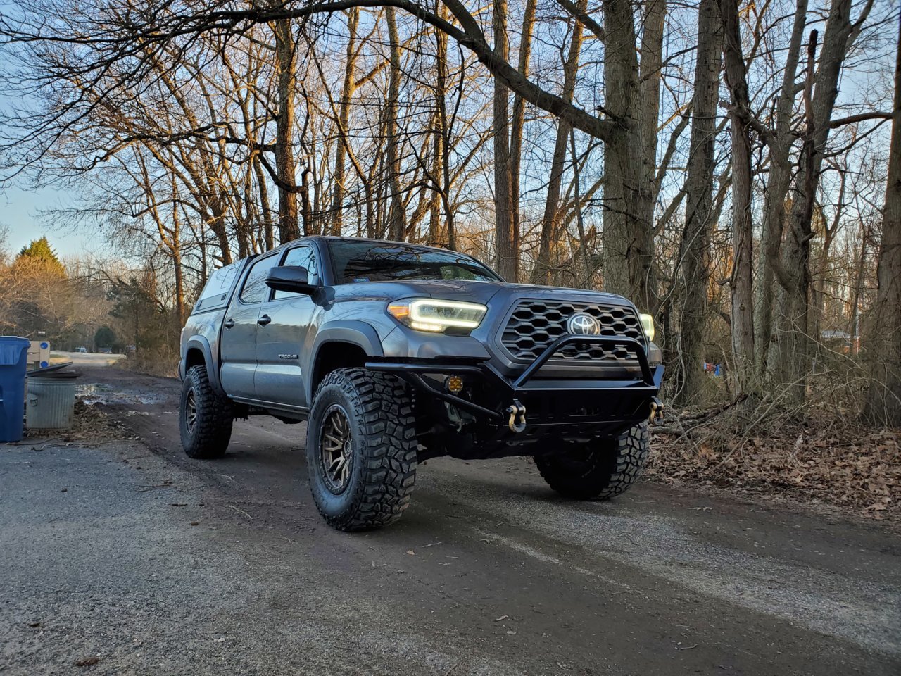

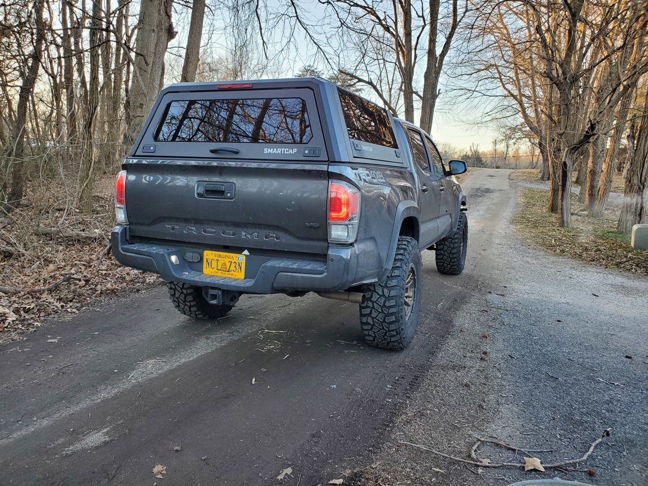

    its finally on!
    only issue I had was trying to fill the gap on the top of the bed rail, and my 3rd brake light doesn't work. need to get a tester and find out what's wrong.
    other than that love the look.

    You are also missing a tail light, driver side, lower. Check that Y harness they sent. Remove it and at least get your tail light back.

    yup, a buddy just noticed that as we were driving home. is that a known issue from RSI then?

    It seems to be, I got my cap about 10 days ago and same issue. A couple people here have posted as well.
    The Y harness they supply is 2 wires instead of 3, it fits onto the back of the bulb socket, and essentially cuts out the tail light when you install it. I haven't reached out to them yet.

    gotcha, i figured when you said that initially before i even realized it that it must've been the last batch that came out bad
