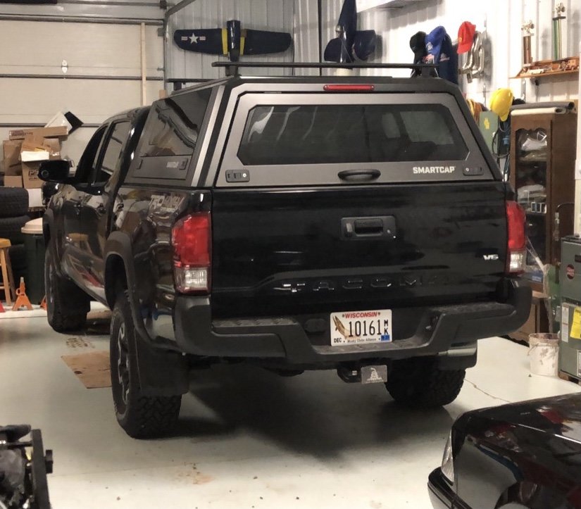

    Just finished installing my RSI Smart cap and a 2” lift 5100s all the way around and a wheelers off-road 2” AAL. Before any settling I have exactly 2” on all 4s and 1” of rake. I’m expecting it to settle some. I used the 4th setting on the front shocks. Needed new shocks since I had 134k miles on my truck. Anyone thinking of getting the smart cap it will drop your back end like a half inch so plan accordingly if you get a lift. I got my smart cap from off road alliance. They were pretty good to deal with. Took a few months to get it but that wasn’t their fault mostly a supply chain thing.

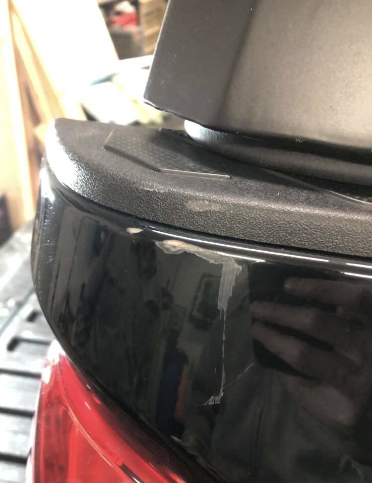

    Well My dad and I put mine on and scratched the hell outa the side of my truck. Definitely wishing I would have had one more person. It’s not overly heavy just super awkward when your trying not to drag it and ruin the gasket. 3 people would be good 4 ideal.

    Definitely at least 3, mostly because once the cap is over the truck the people on the sides can no longer hold the cap straight up, they are holding it out.
    Also looks like you need to move it back about 1/2" or an 1" even. I've found it pretty easy to turtle it on my back while someone outside keeps it straight and adjusts. I'm not hulk either, 6'2"~ 190lbs.

    Ouch man. Sorry to hear of this. That really sucks.

    I’d like to move it back but the front gasket is just sealing on the front bed rail . It’s not very wide up front and I even got the seal the required 1/8” from the edge of the cap. So note to others don’t go any less than 1/8”. It’s not bad where it sits plenty of seal on the tailgate. It’s pretty much right where my tonneau cover ended too.

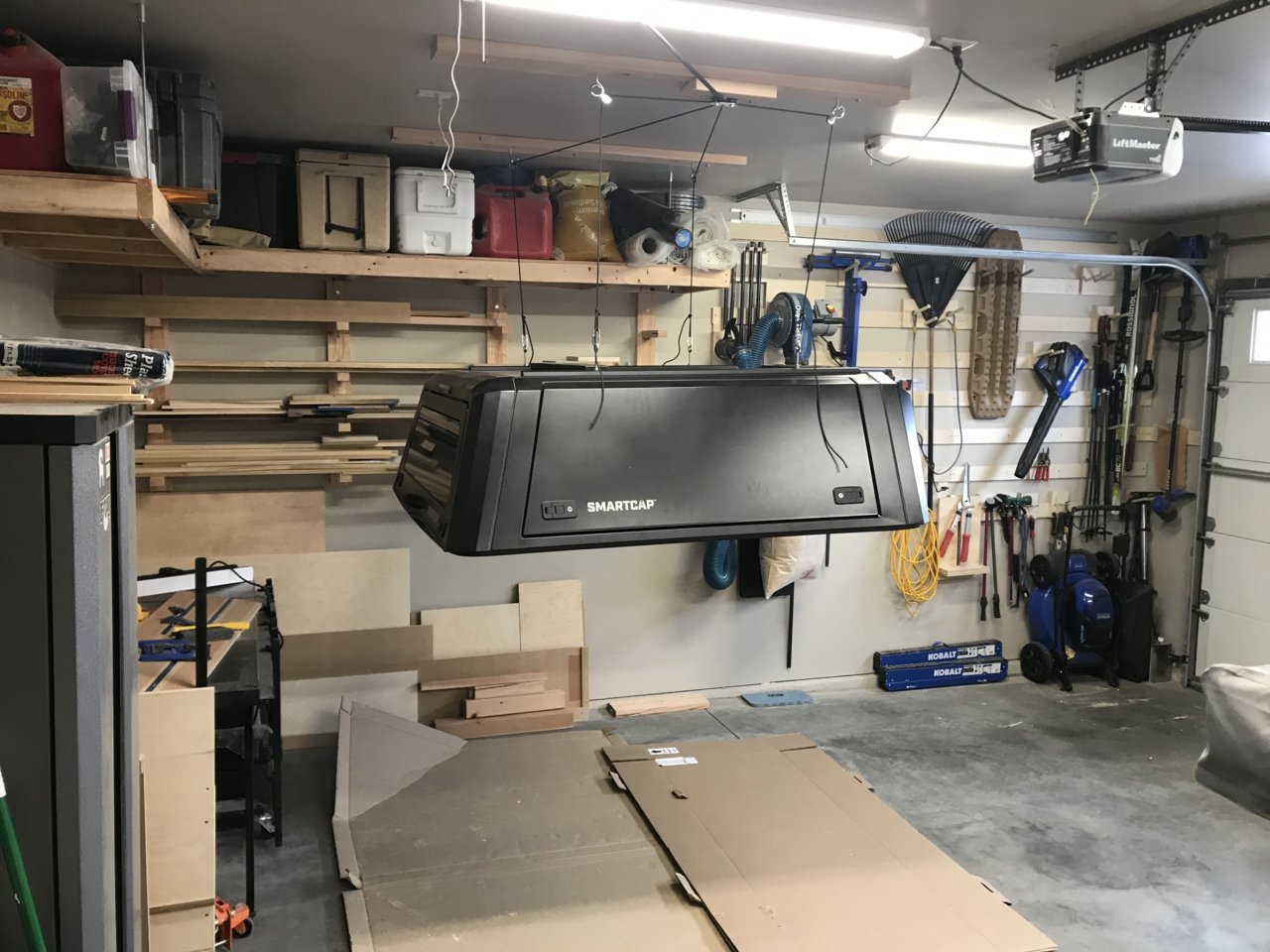

    It’s possible to do it with one person with the right gear. I used my harken hoister to get it in place.
