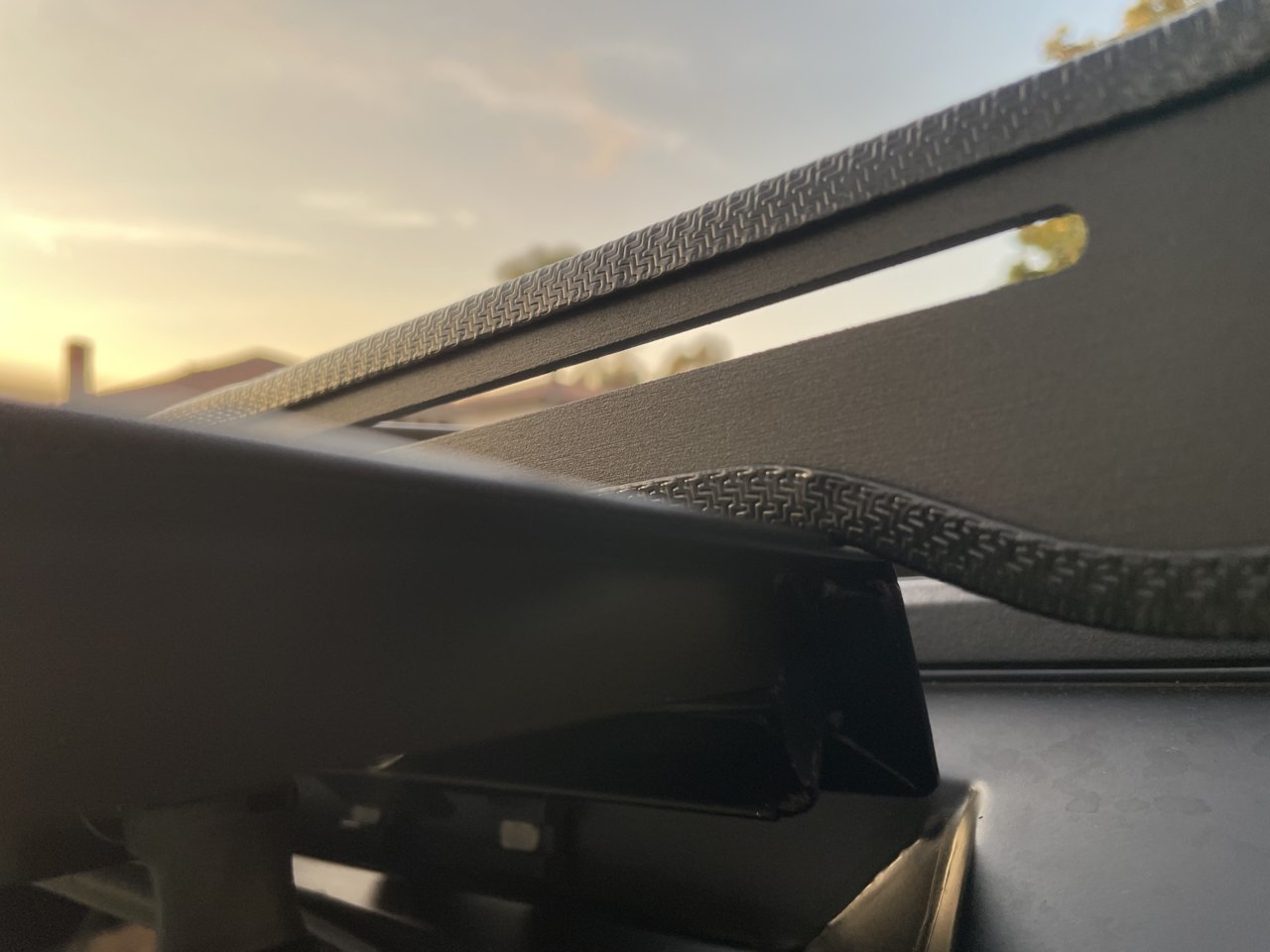

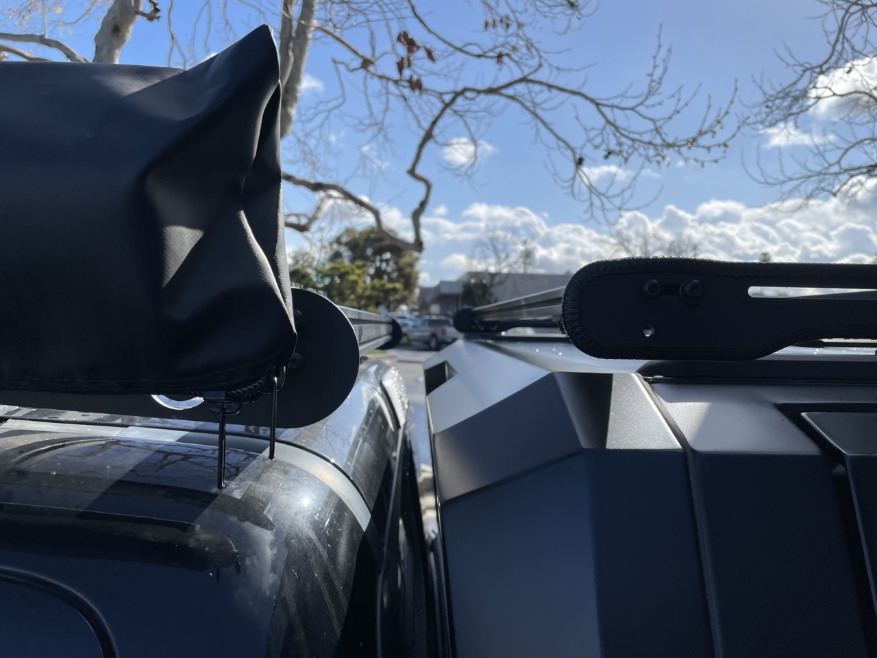

    The cap alone sits a little higher than the cab. The prinsu rack comes with mounting feet, but I ordered an extra set that are about 1/2 in shorter. I wanted that top line to be a little more even. Over all I’d say about an inch taller. I also added rubber door edge guards on the outside frame of the prinsu rack. The side doors on the smartcap hit it when opened.

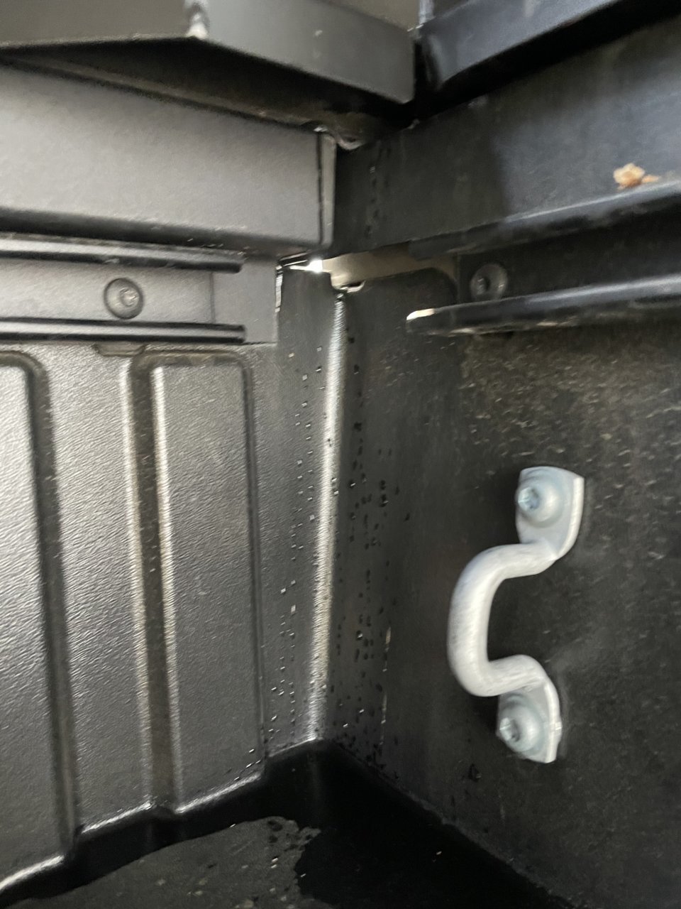

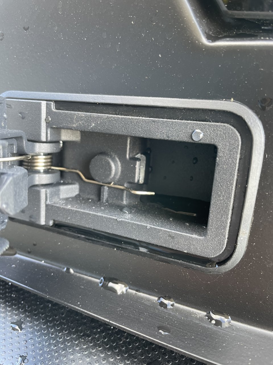

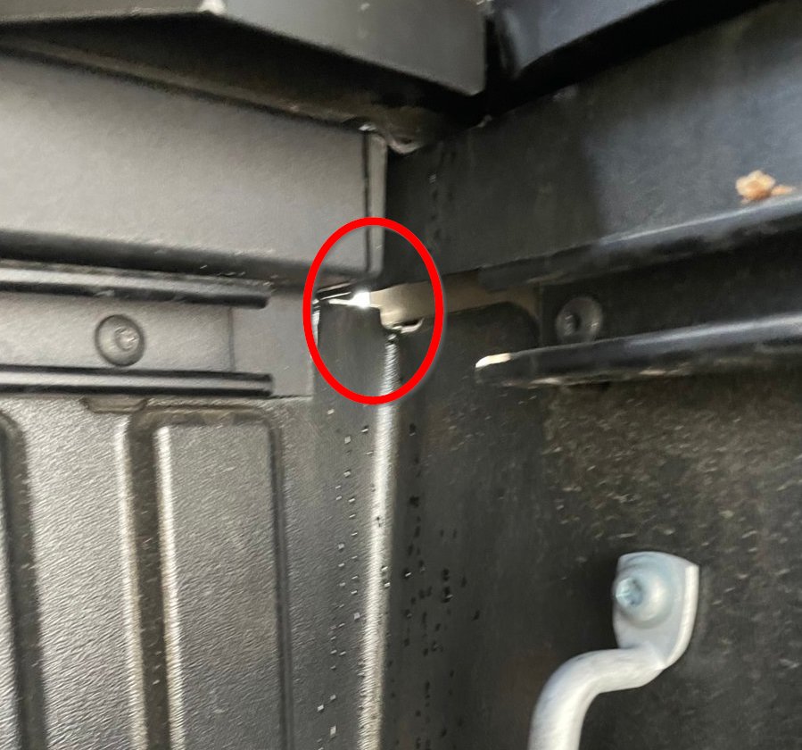

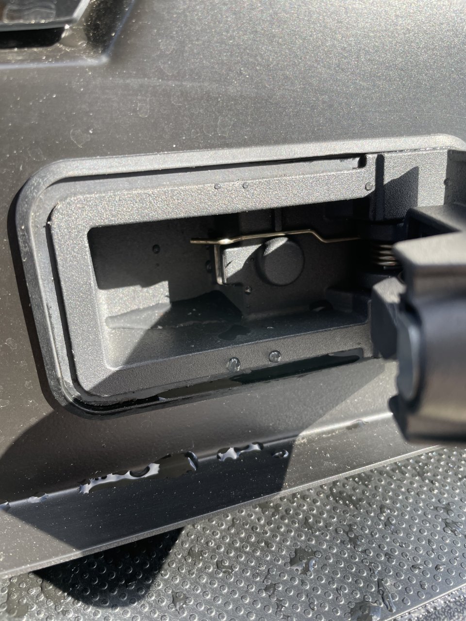

    After some rain last night I was able to find where I need to do more water proofing. I also found water in the locks which maybe why some are finding their locks to freeze in the cold.

    Fill in that gap! I can see small drops from cap to bed, that that hole means major water coming when driving.
    Good photo showing the issue.

    62541-04010 and 62542-04010. These are OEM factory bed rail plugs. Should help that corner.
