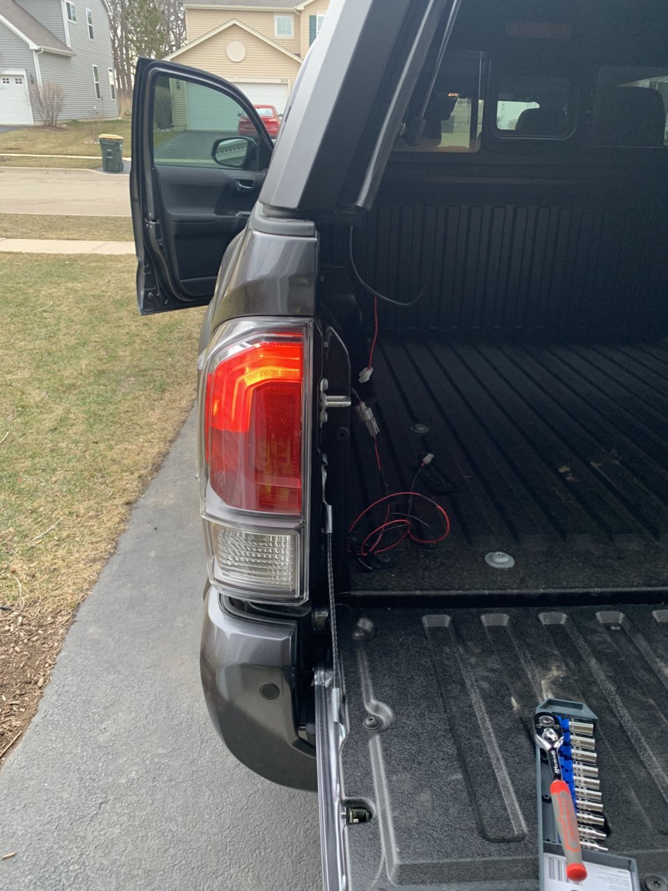

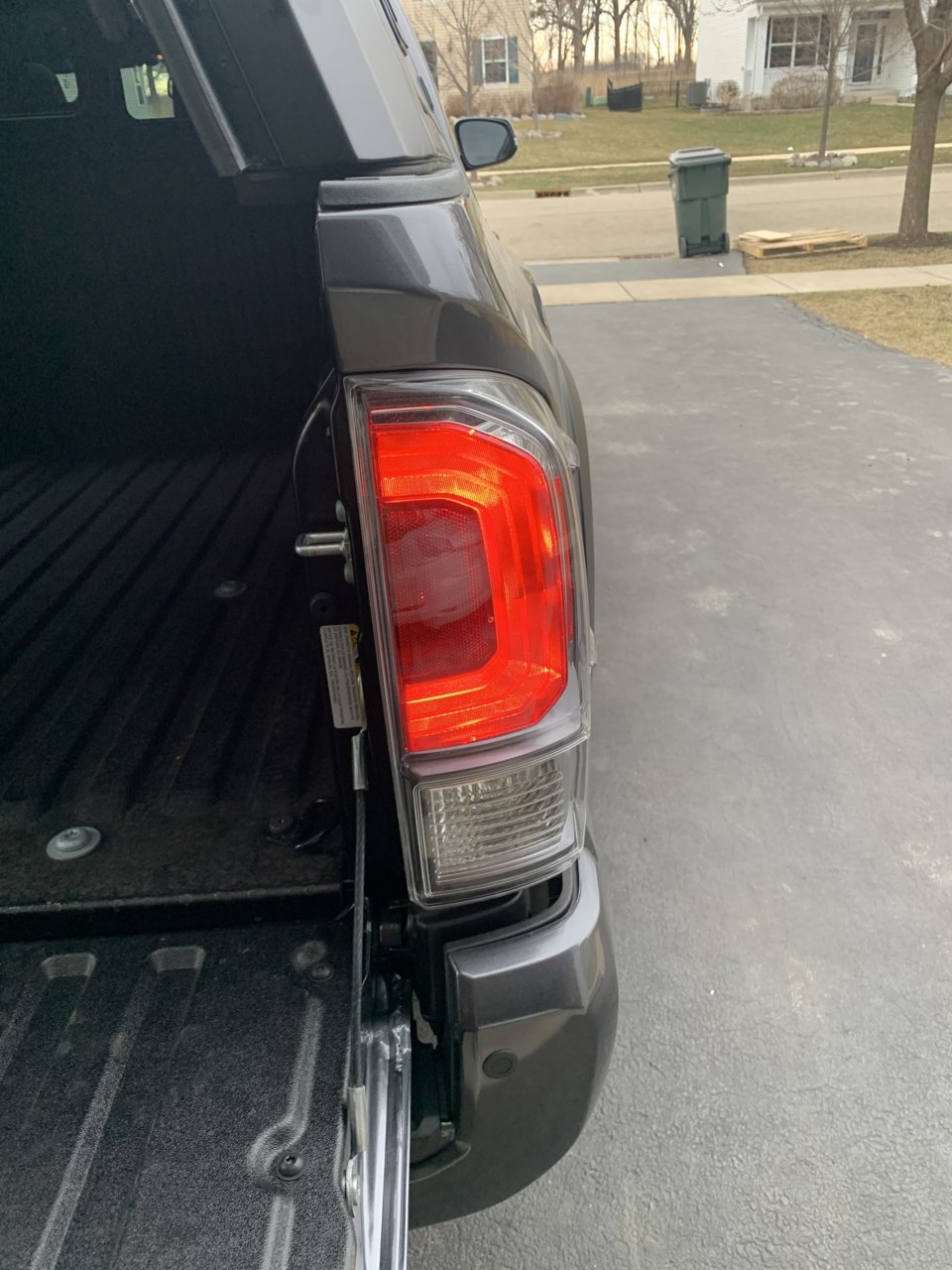

    I wish I came to this thread before I wired up my cap, would have saved me a lot of time...seems like bad batch of wiring.
    I just received it last week and spent way too long troubleshooting until I found that the polarity was swapped in the two pin connector like the rest of you. I swapped the wires and got the third brake light to work but now the lower brightness of the tail light doesn't work (like when the headlights are on or after you lock the truck). I verified that the tail light works fine with the harnesses removed but I'm at a loss for what the &^%# is going on now.
    I've tried checking the resistance in the harness (thinking there was too much voltage drop) but it seems fine with the multimeter. Could it be the third brake light..something else? Has anyone else run across this?
    I've reached out to @OffroadAlliance.com (where I purchased) and hopefully will figure something out.
    edit: added pictures for clarity

    The harness they provided you is 2 wires. The harness it taps into from the factory is 3.
    When you installed the new Y harness you essentially bypassed that lower bulb.
    I provided pictures of this when I found the issue on my harness as well.
    RSi supplying harnesses at all is relatively new and they are not sending correct harness for properly tapping into the Tacoma.

    Thanks for the quick response. I just came to the same conclusion. I'll go hunt down your post to see what you did but I suspect that I will need a new harness with the third pin in the triangle connector. These guys (RSI) seem pretty good at fabrication but the wiring is ridiculous - how can they keep selling a product with this sort of known issue??
    edit: @OffroadAlliance.com got back to me very quickly and processed the issue with RSI. According to RSI the third wire in the harness is only required for trucks with LED tail lights. Still two separate issues with one wiring harness....

    I haven’t resolved it yet, I purchased the cap through a local company because they offered free install.
    I reached out to them about the wiring, they responded that they had reached out to RSi and were waiting for them to reply. They called me late last week and asked me to swing back by so they can resolve it.
    Easy solution is to just tap that 3rd wire, which is what I imagine they will do for mine. If I did the install myself I would have just done this so it was complete without waiting on a replacement.
    As for how they keep selling these with a known issue, in their defense they providing the harness is relatively new. Basically these caps were all out of stock most of Q4 2020, when they started shipping again they included this harness. I assume they received a bulk of them from whatever supply chain they are using and didn’t realize they had bad harnesses until they all went out.
    I’m pretty confident this is a short term problem and is as early adopters are experiencing the issues.
    It doesn’t change how I view the product. Them going from no harness to providing a harness at all shows me they are trying to add more value to their products. If we had to receive a funky batch before they ironed it out for future buyers it doesn’t bother me much.
