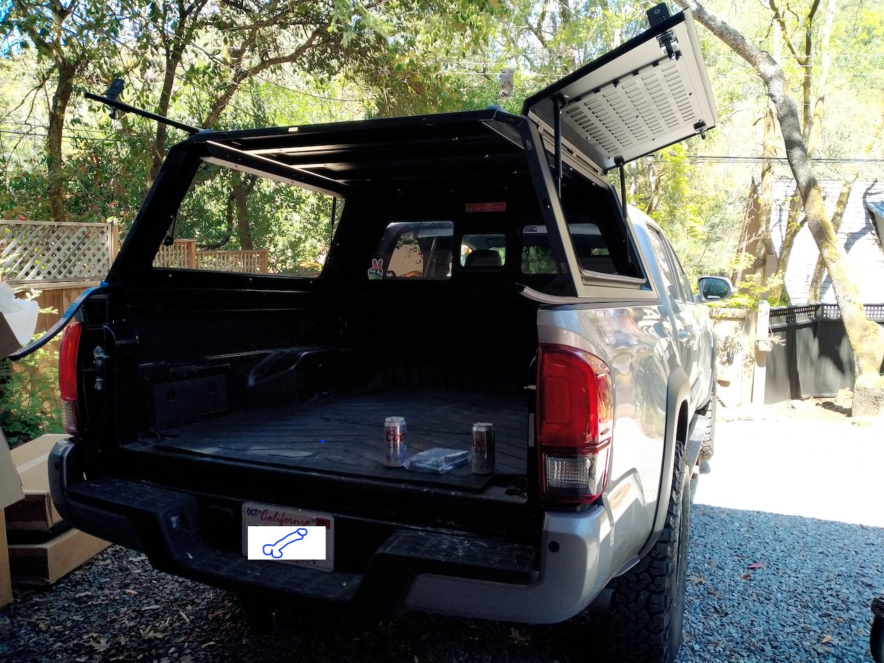

    Forgot to mention that if you only have your wife to help you like I did, it helps to not attach the back panel (or un-attach like I had to).
    Made the shell that much lighter but also less awkward to lift and place.
    We placed just the front two corners on the back corners of bed and I jumped into the bed and he-manned the shell towards the cab on my back.
    I'll also add that the back panel was SO much easier to then fasten as I wasn't hunched over this time placing those silly grommets.

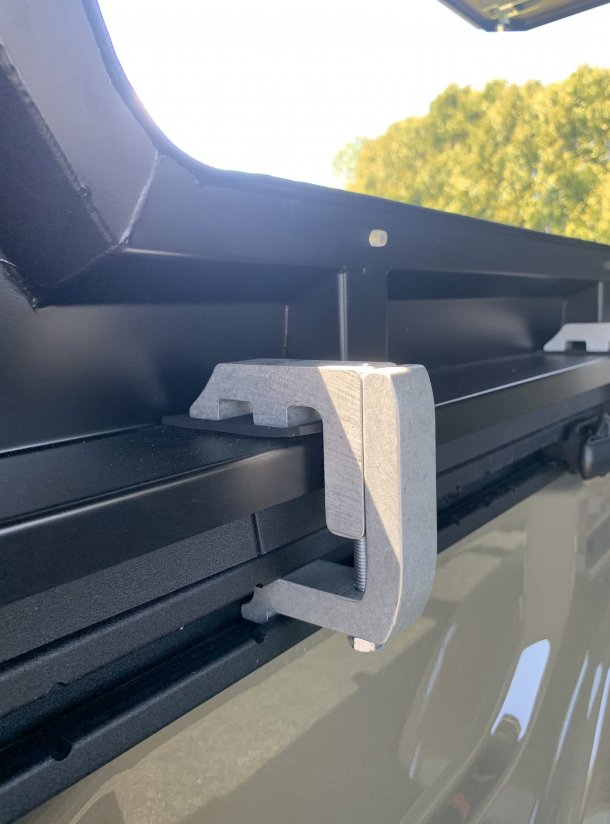

    My OCD has caused me to still dwell on my bending rails. Looked at how RSI attaches to other vehicles and noticed that the Gladiator has a similar bed side rail system to the Tacoma but comes w/ a different clamp.
    I'll try and reach out to RSI about testing out these clamps as they appear to grab more of the metal and farther in as opposed to our bolts that pull down due to being closer to bed center.Screenshot_20210402-032609_2.jpg

    Bedrail clamps.
    I measured twice and places those think rubber blocks right at the clamp locations. When we lower the cap into place, we had to pull the rubber seal's edge to avoid pinching.
    The toque was just about 100-inch pounds (108?). I have a little inch pound beam torque wrench. It felt like it took forever to snug down, but a little at a time, moving back and forth.
    The rail is straight; the cap is snug.
    It's off as there are 8 blocks; the two extra go to the end of the bed, near the tailgate.

    Thanks Tom - I've see pics of the long bed version and it seems like the rails aren't being affected like the short bed ones.
