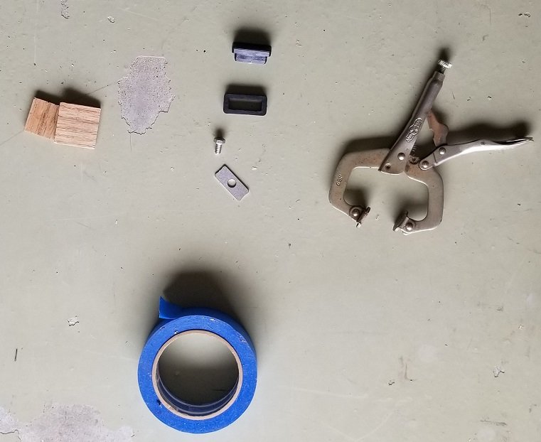

    Fill the cooler, invite buddies over. Swivel pad vise grips and blue painters tape helped. I had a small woodblock cut from the wooden surround of the cap that came in handy and a big mallet (tapping roof into the side panel while holding with my knees). Solo assembly sucked, so a couple of buddies.
    Side panels take time to get inserted. Tap tap tap tap, back and forth up and down the panel.
    Panels are in heavy plastic sleeves. Lift and slide the panel out, roll, and knot on end—giant trash bag for styrofoam (box with). Layers of cardboard will save your knees. I keep flat sheets for when changing oil, which helps keep the floor clean.
    The photo has wood scraps for the swivel pads to prevent scratching, blue tap helped keep the end panel in place when starting clips as it was getting a clip-in, wiggle side panel, next clip, other side, wiggle, install, back. Four clips to hold the roof panel, then one at a time to start the side panel. Cardboard saves your knees.
    When you get stuck and frustrated, take a break but don't skip a clip take your time.
    Oh makes me appreciate I didn't skip leg day (lots of squats and burpees) at the gym.

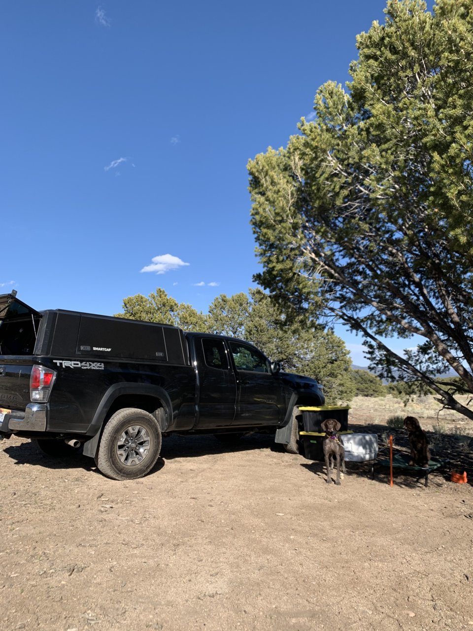

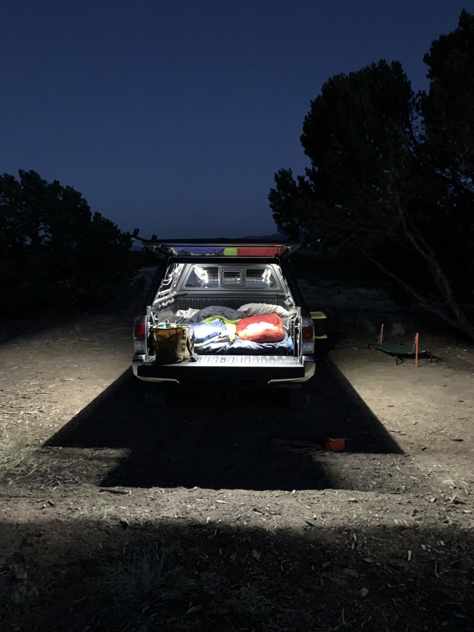

    Took the EVOa out for a trial run this weekend! As expected some condensation on the inside when closed up but will be making a magnetic bug net to help leave the tailgate window open. 4F5F2AD2-433E-467B-9C2B-4E5A1645A31D.jpgF73855DC-03DF-49FC-8A08-6F3E49170308.jpg

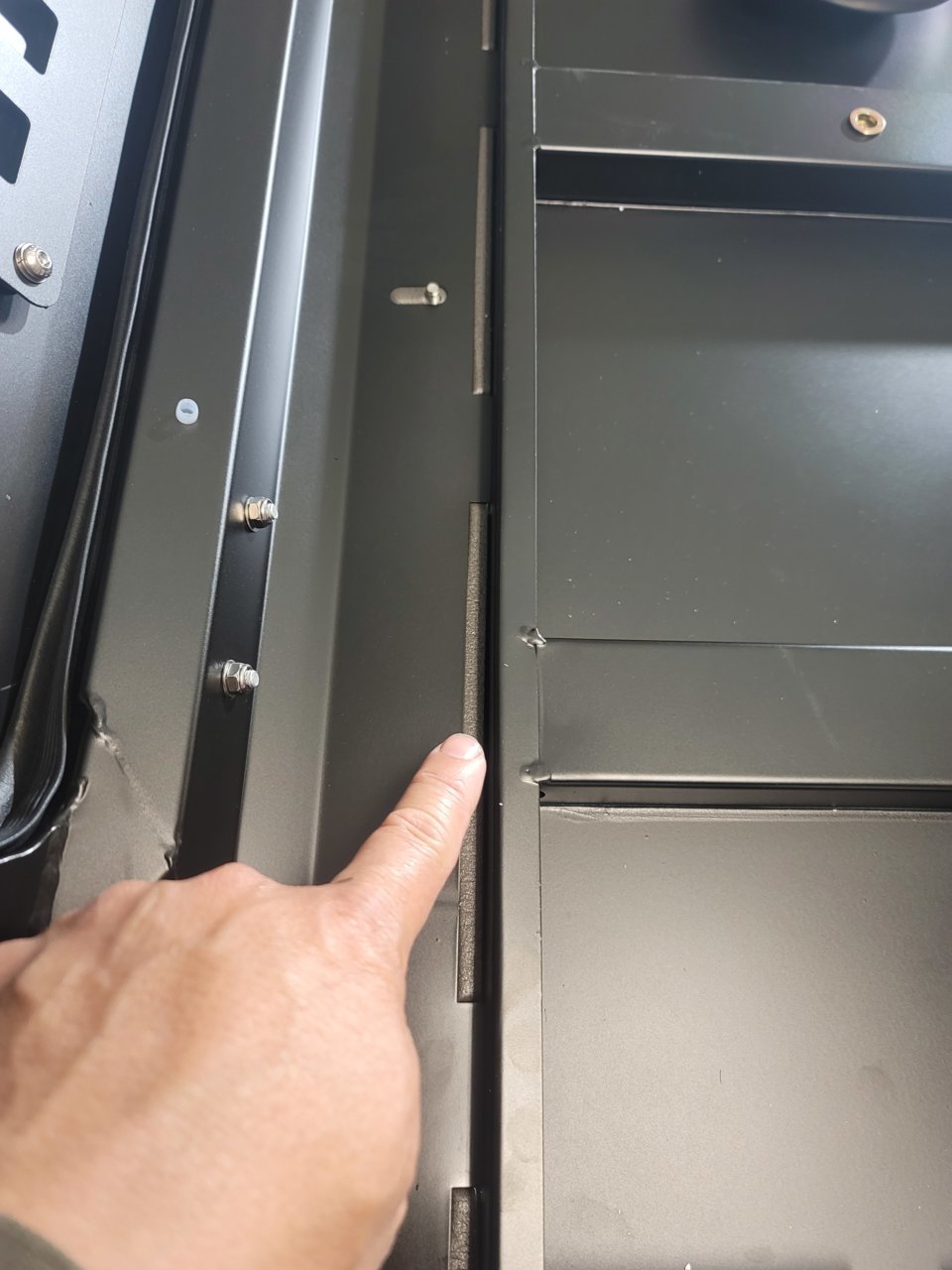

    Installing my cap today. Is this small gap suppose to be here or should the side panel meet flush to the top when you assemble?
    I tried holding the panel vertical and taping with my hand but doesnt seem like the side panel wants to go in anymore.

    Make sure the tabs are started and tap with a rubber dead blow hammer

    Yes
    FYI - driving with the rear window open will wear out the struts much faster than normal

    Car seats
    I’m guessing they want it open to sleep and reduce condensation at night...
