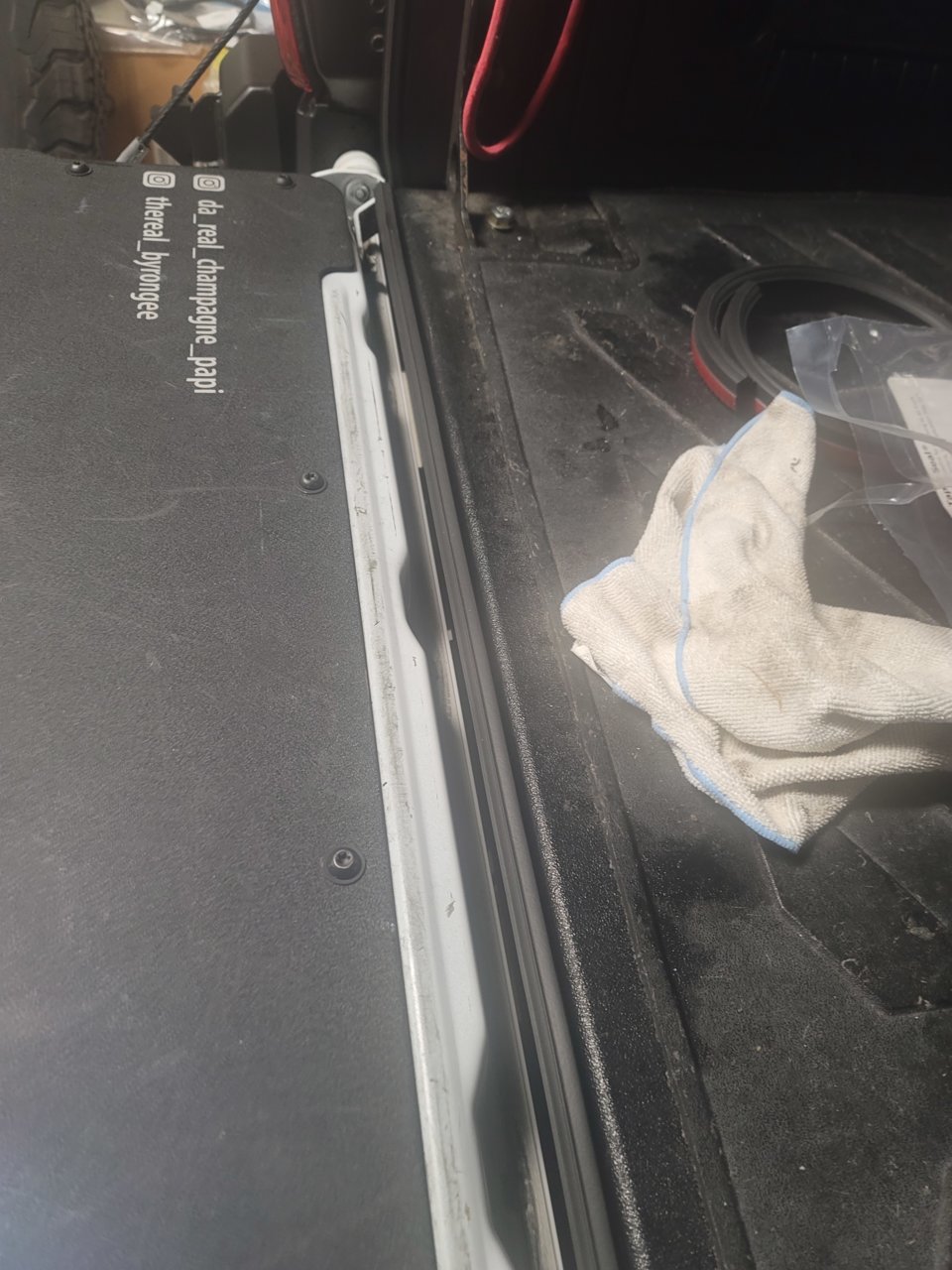

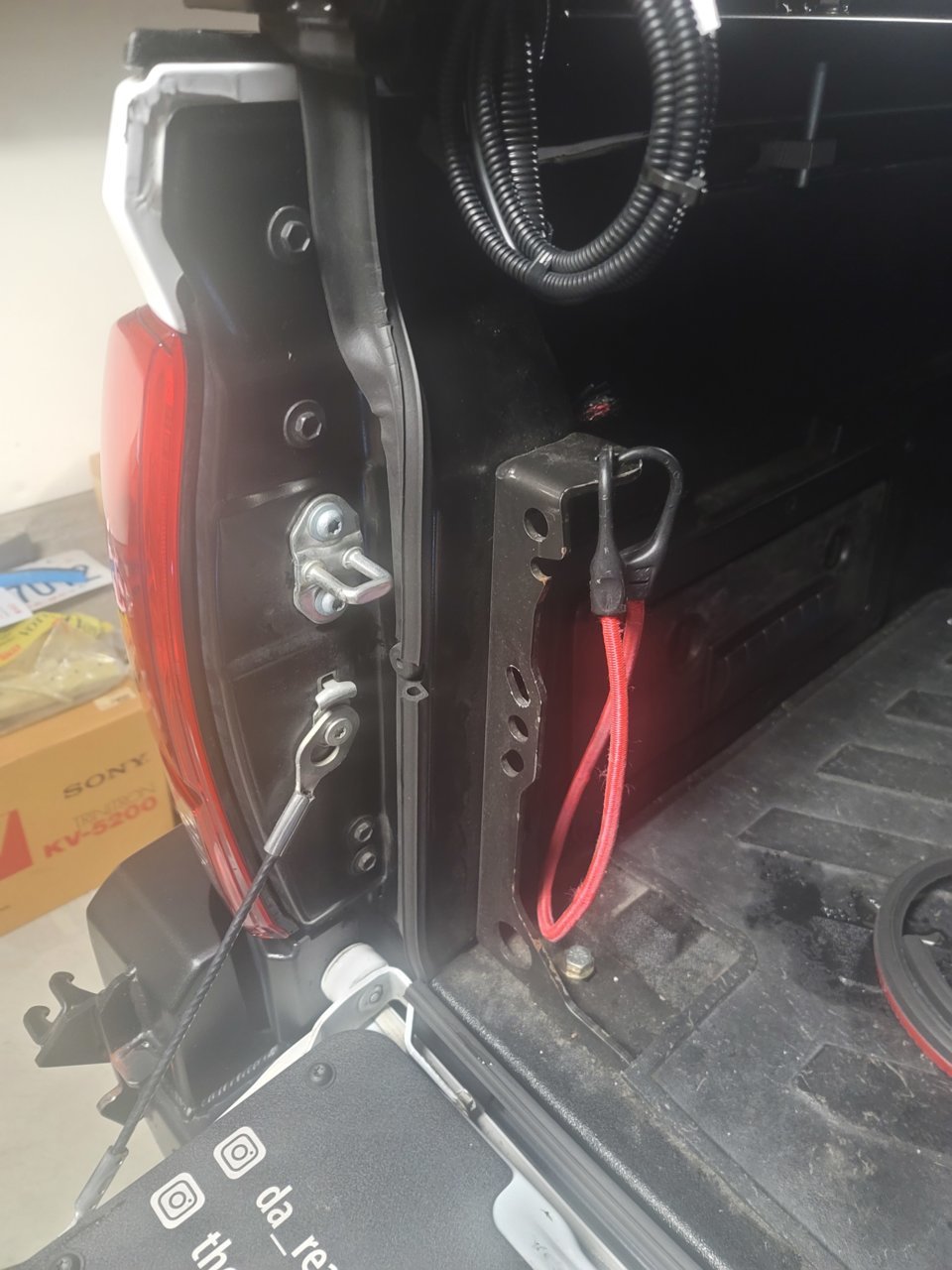

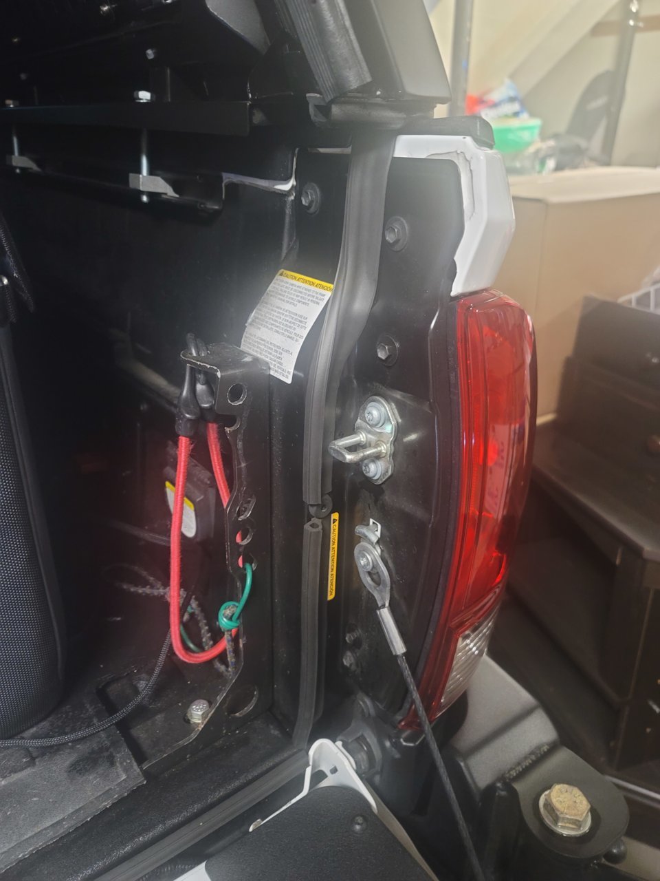

    Yes, i just started putting from the rear and work my way forward. Came out super easy.
    I used high density weather striping under the bed caps and ran a bead of chauking where the composite bed meets the bed cap (had to remove the rails to do this). I also removed the header rail and ran wearher stripping un that as well. I used butyl tape to fill in the gaps between the header rail and front besides.
    I used a tailgate seal to seal the sides of the tailgate and had enough left over that i ran it across the bottom of the tailgate also. I still need to run some butyl tape on the lower edges by the tailgate where my bedside supports are.
    I realize it will never be totally water tight but hoping to keep most of the wayer and dust out.
