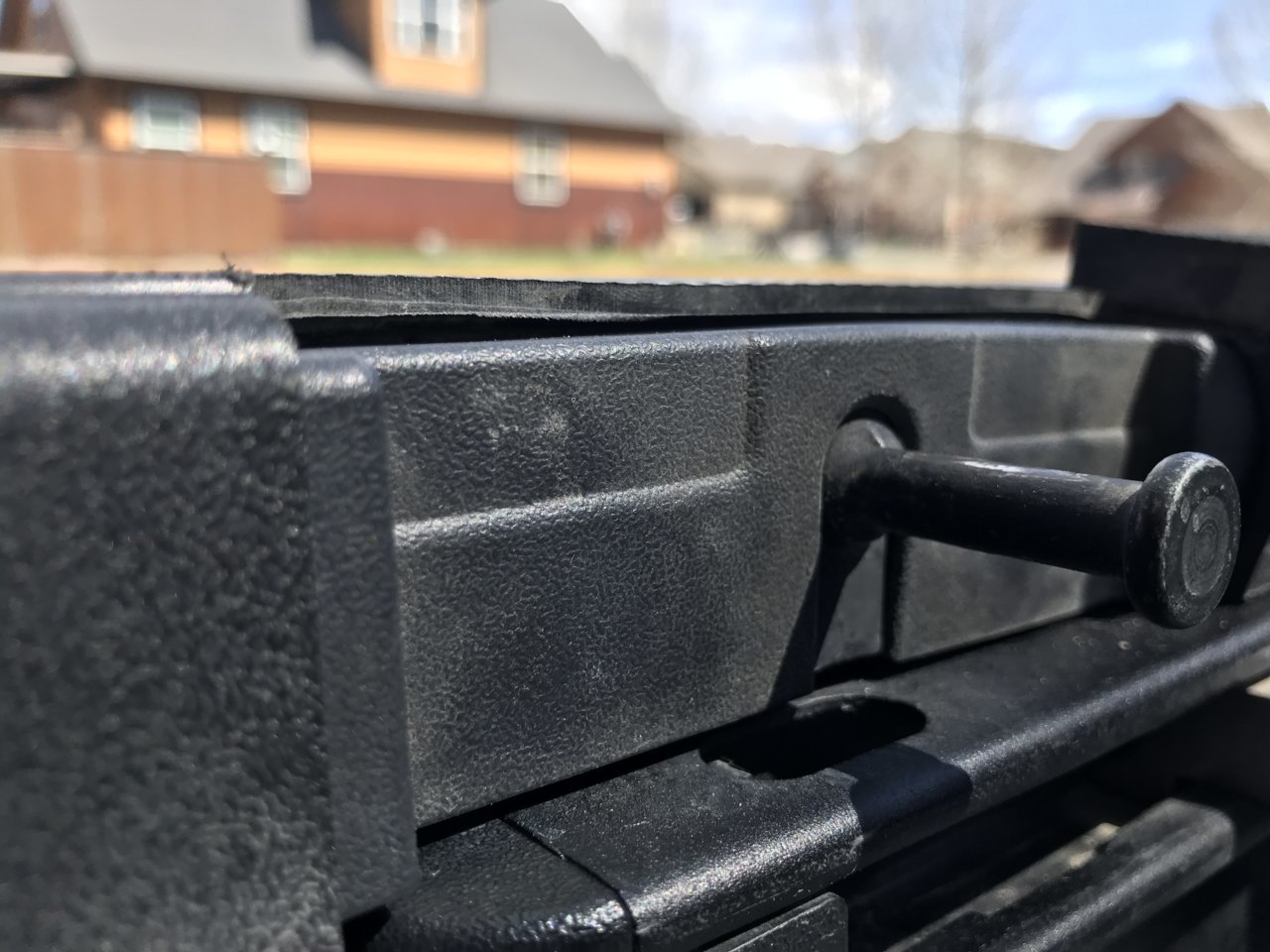

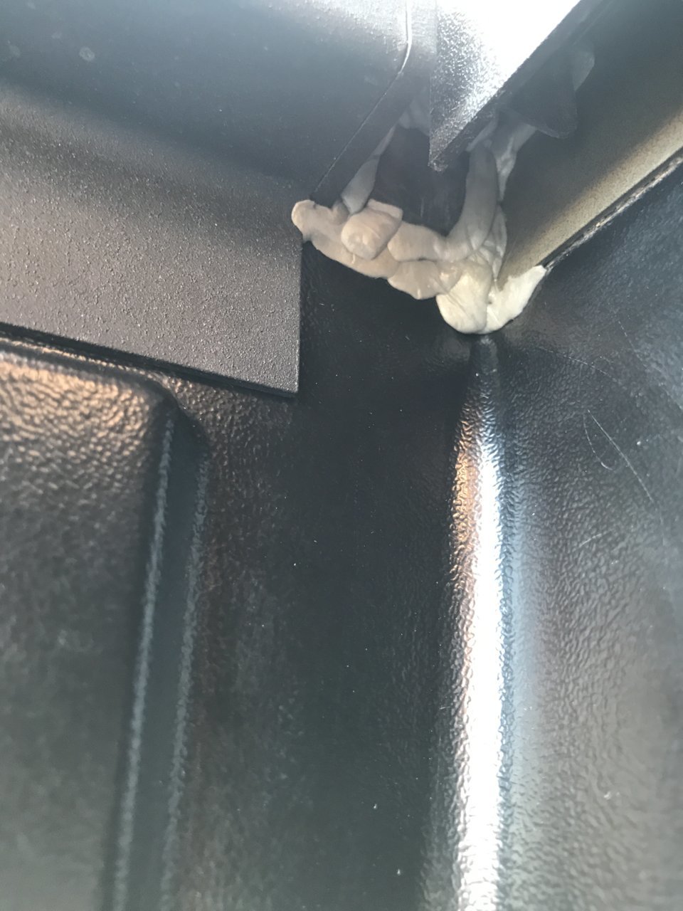

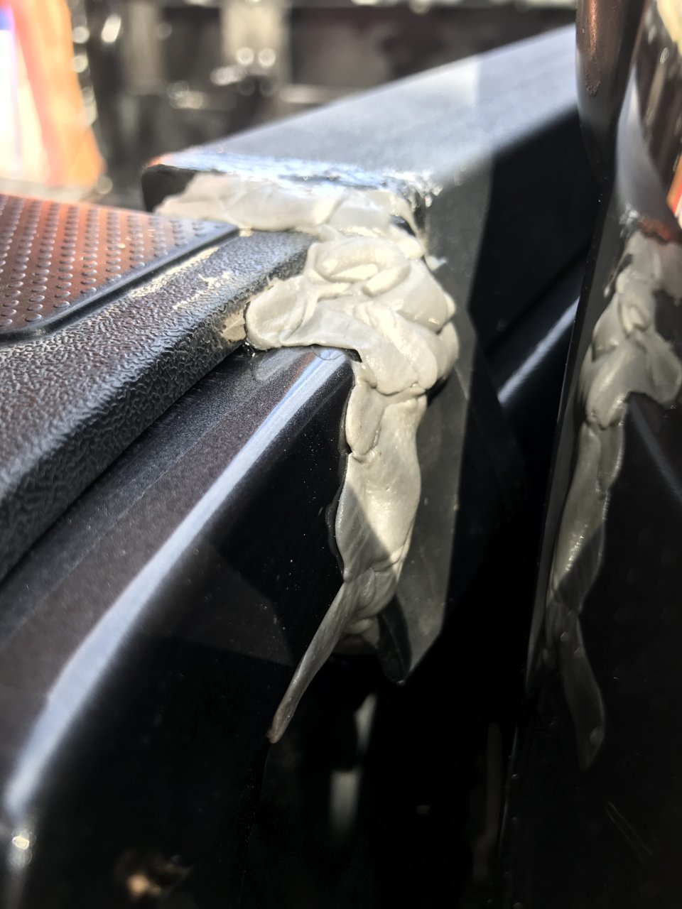

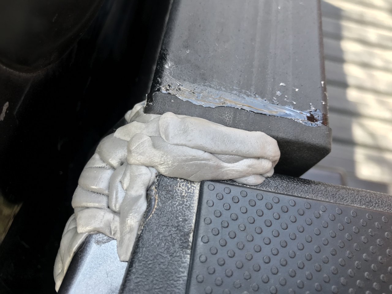

    Here is my progress sealing up the truck bed while the cap is removed:

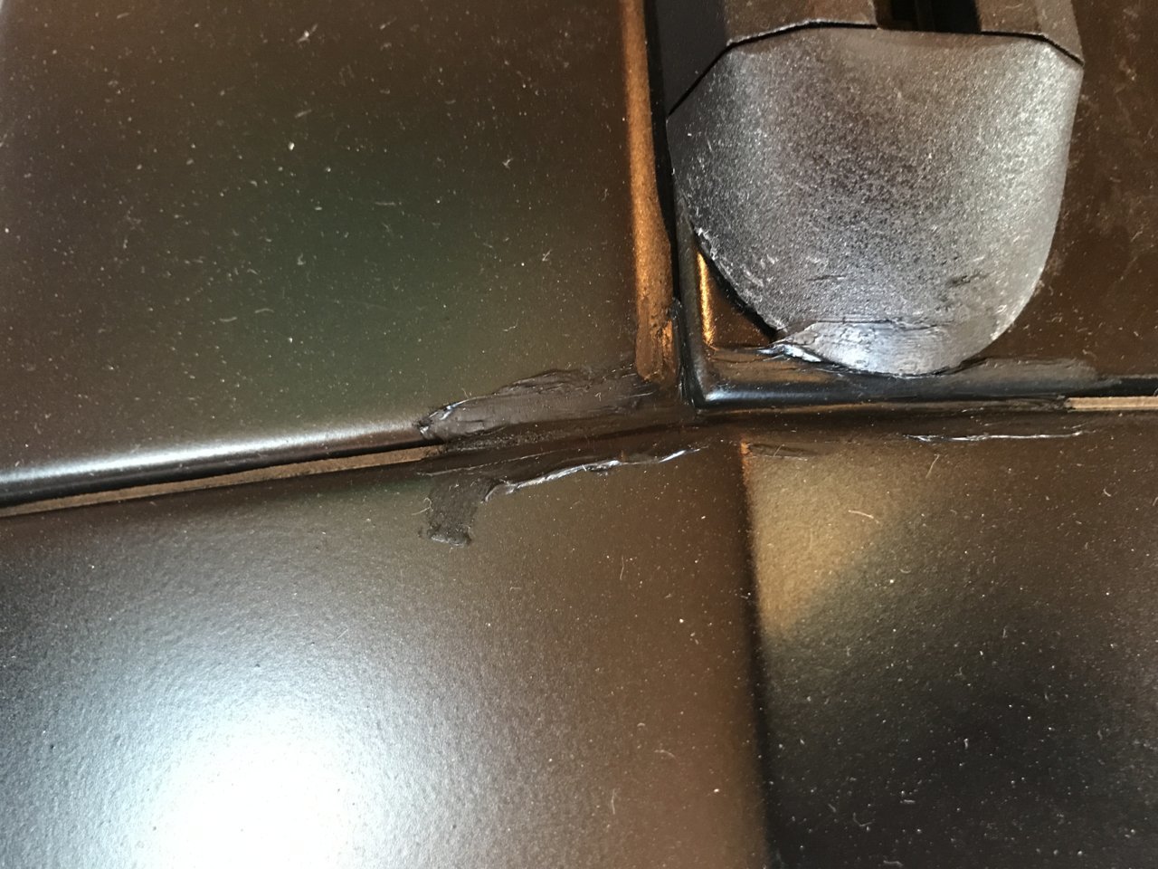

    I siliconed each corner where the cap meets at each panel, because the rear was leaking, as well as the front now. So I preemptively did all 4.

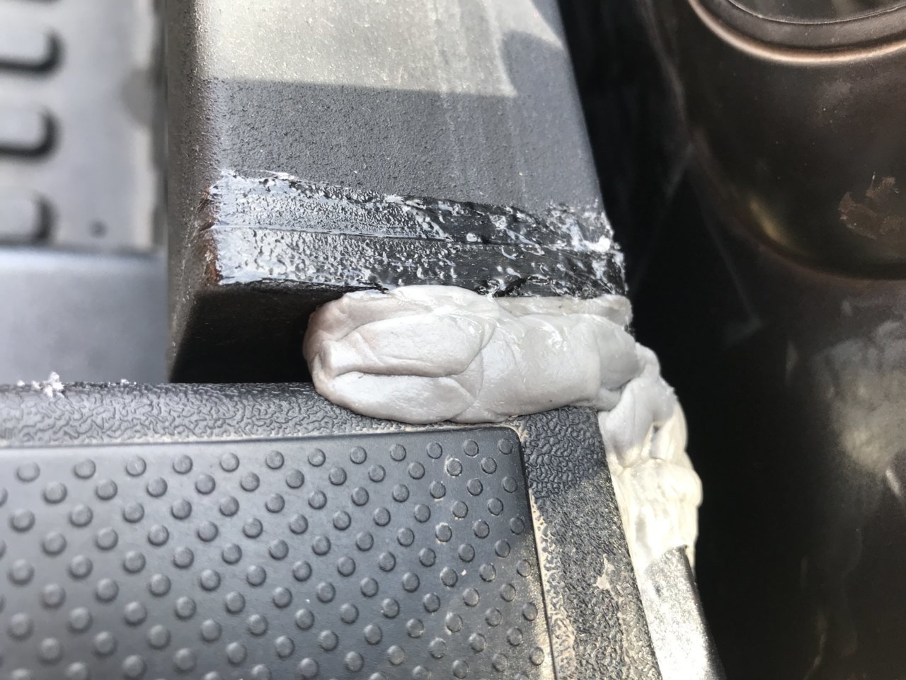

    This photo shows the plastic rails, which I ran a bead of silicone underneath from the front all the way down the back.

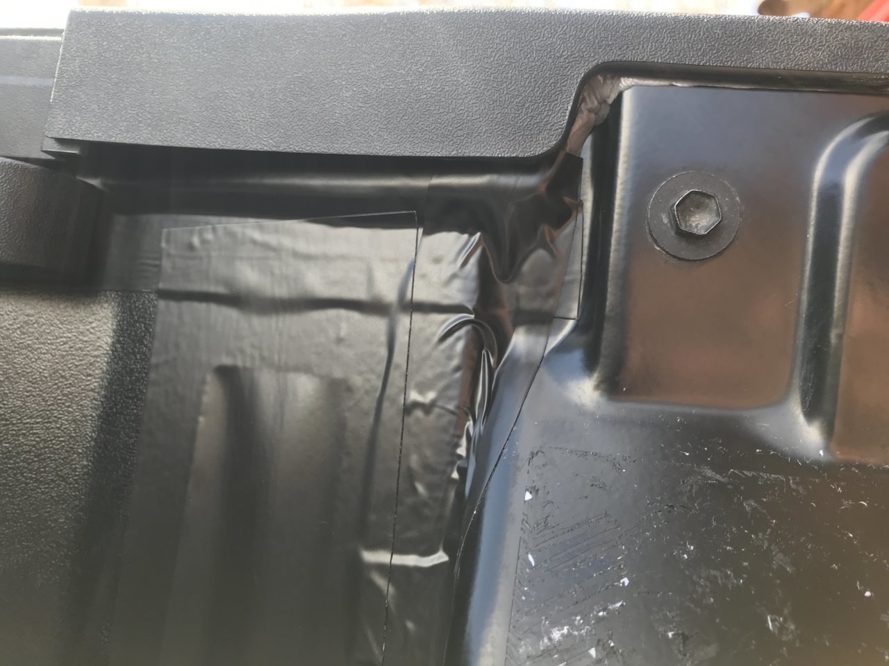

    The Butyl tape is interesting, my first time using it. After removing the front bar and then the plastic fill pieces, I cleaned everything and went to town with butyl in the corners. I then reinstalled the plastic caps (that came with my tonneau) and then filled around them again with more tape.
    Then I ran a bead of silicone underneath the front bar and reinstalled it.
    I used the tape again in the rear of the bed, near where the tailgate meets. I shoved the BT inside of the gaps and then covered it with the waterproof tape.
    Inside view of the corners
    I also ran some silicone right by the BT in the corners because the front bar had these tiny lines in them and I wanted those to be sealed up as well.
    I think I have sealed most of the holes and have a good idea of where the water was leaking in from. Before I reinstalled my RSI cap, I wanted to see if there were any other suggestions.... Thanks
    EDIT: should I run silicone on the INSIDE of the bed where the mounting rails are(the rails used to tie things down) do these leak at all? Mine have a bunch of tiny rocks in them, I think from the leaks from the tops of the plastic bed rail covers, but wanted to be sure. I can always do this while the cap is installed. But might even be easier to do if I removed those accessory rails and cleaned and then sealed them. But this might be overkill...

    what made you decide to leave the tonneau cover attachment points on there? they look like they would get annoying.

    You know, I asked someone (forget who, maybe the RSI rep) and they suggested to just leave them. I also wanted to have the option to use the cover if I ever wanted to change my set up. They really aren't in the way at all. But not as clean looking as it could be.

    21' DCSB OR
    Love the write up and appreciate the photos to go with it. What silicone seal did you use?

    I thought those would help. Even myself to make sure I am not missing anything.
    I used this stuff called Lexcell. Its like a clear silicone type thing. I heard its better.
    I am getting anxious to get the cap reinstalled and water tested! I will update when I do. Until then, waiting to hear from any other members if I missed anything.

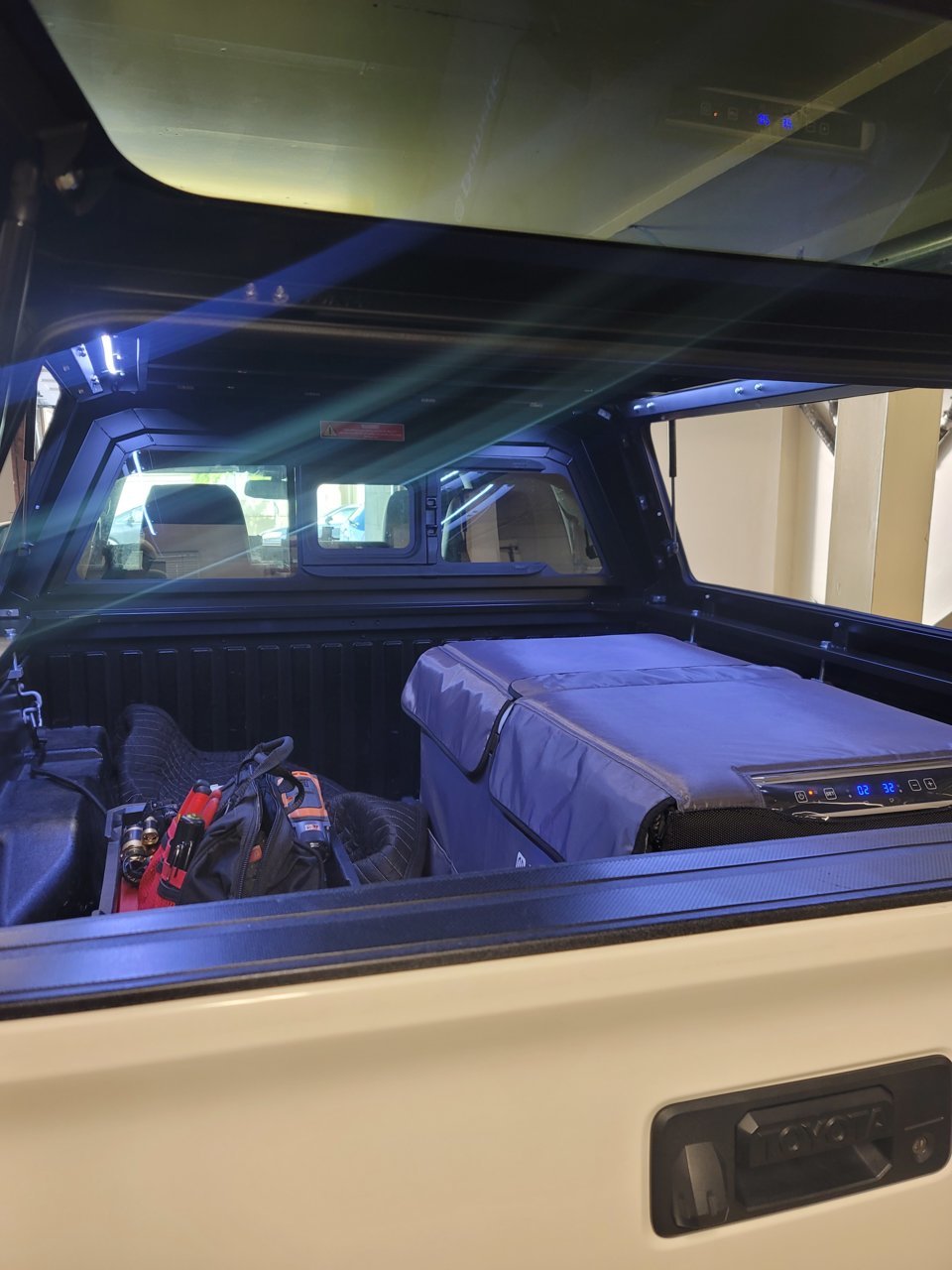

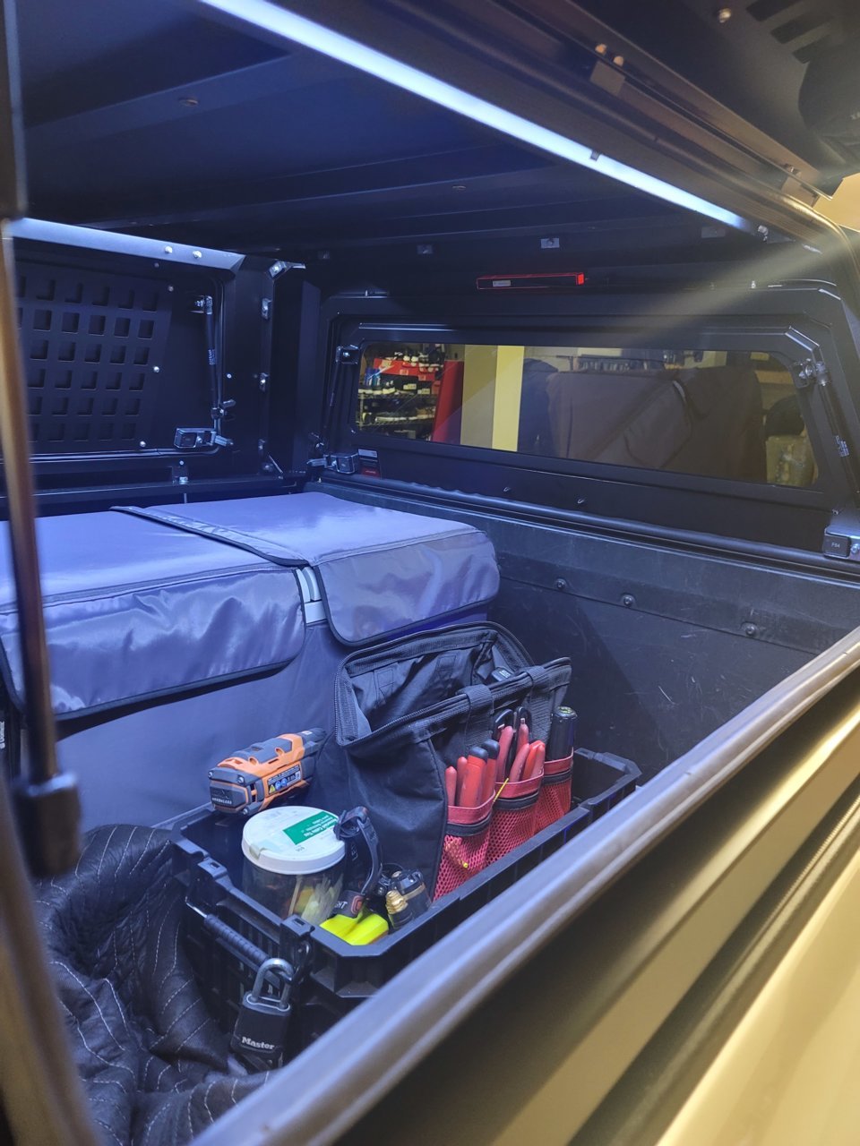

    Just finished installing my lights in my canopy. I used a deustch plug for lights just in case i needed to take the canopy off. Ran the power wire through an existing whole with the 3rd brake light wire.

    What’d you use to secure your LED light wires. In need of something to secure to the cap without drilling.

    If these are the Matt Gecko lights the LEDs come with adhesive on them.

    I just used the double sided tape that came on the back of the LED light strips. On the ends of the strips I used a drop of gorilla gel glue. If any of the strips start to fall I will use the gorilla gel glue to reattach them.
    To secure the wires from the LED light strips to the power source, I used these with some zip ties:
    https://www.amazon.com/XHF2018-Adhe...rds=zip+tie+mount&qid=1619040760&sr=8-2-spons

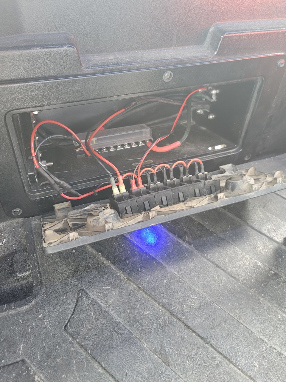

    Where did you tie in the power for the strips? I would think tieing them into to the bed lights would be a decent fit.

    I set up a aux fuse block and switch in my rear cubby. You can probably tap the bed lights since the led strips take minimal power.
