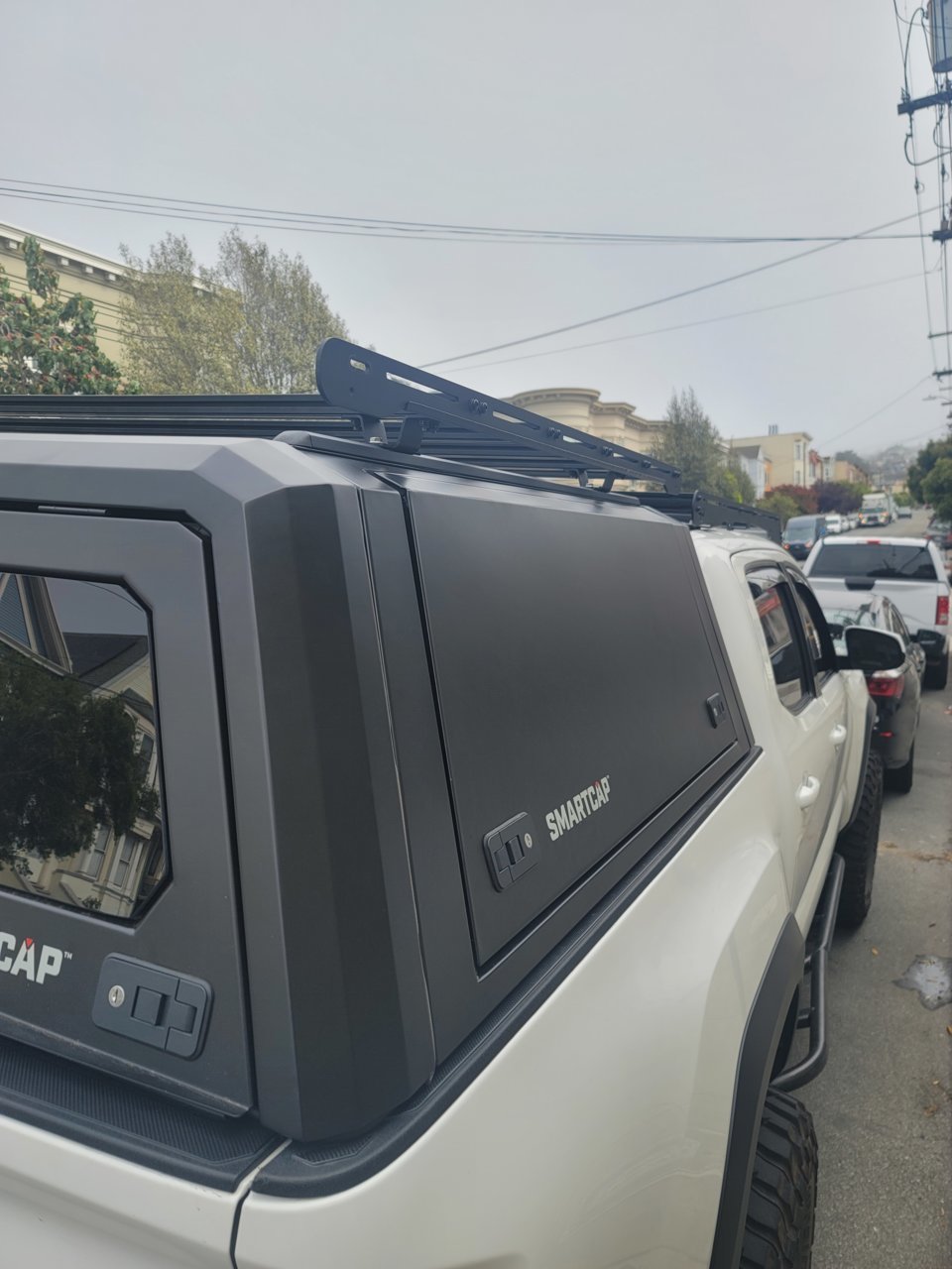

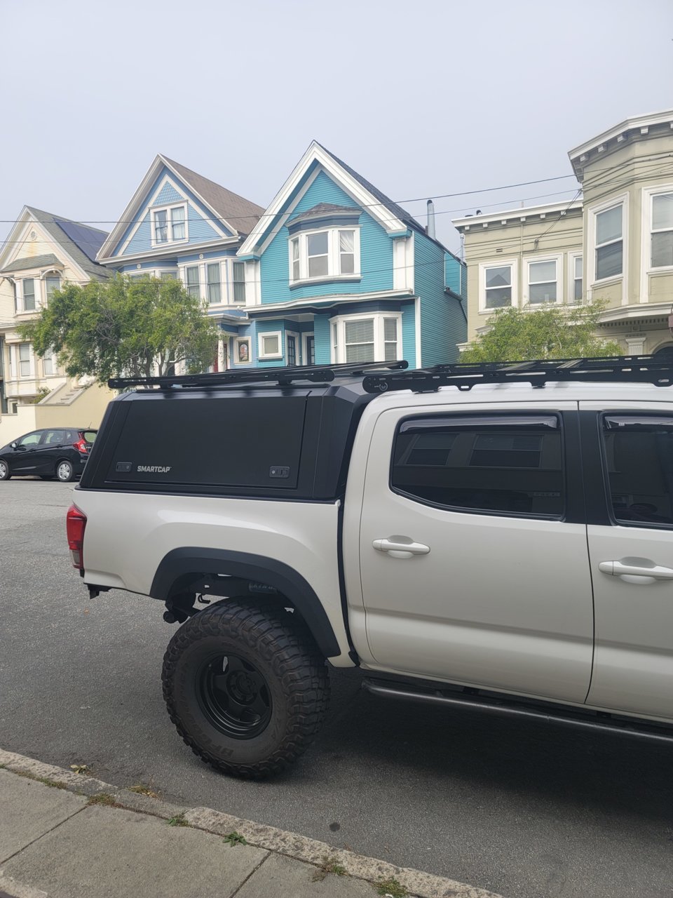

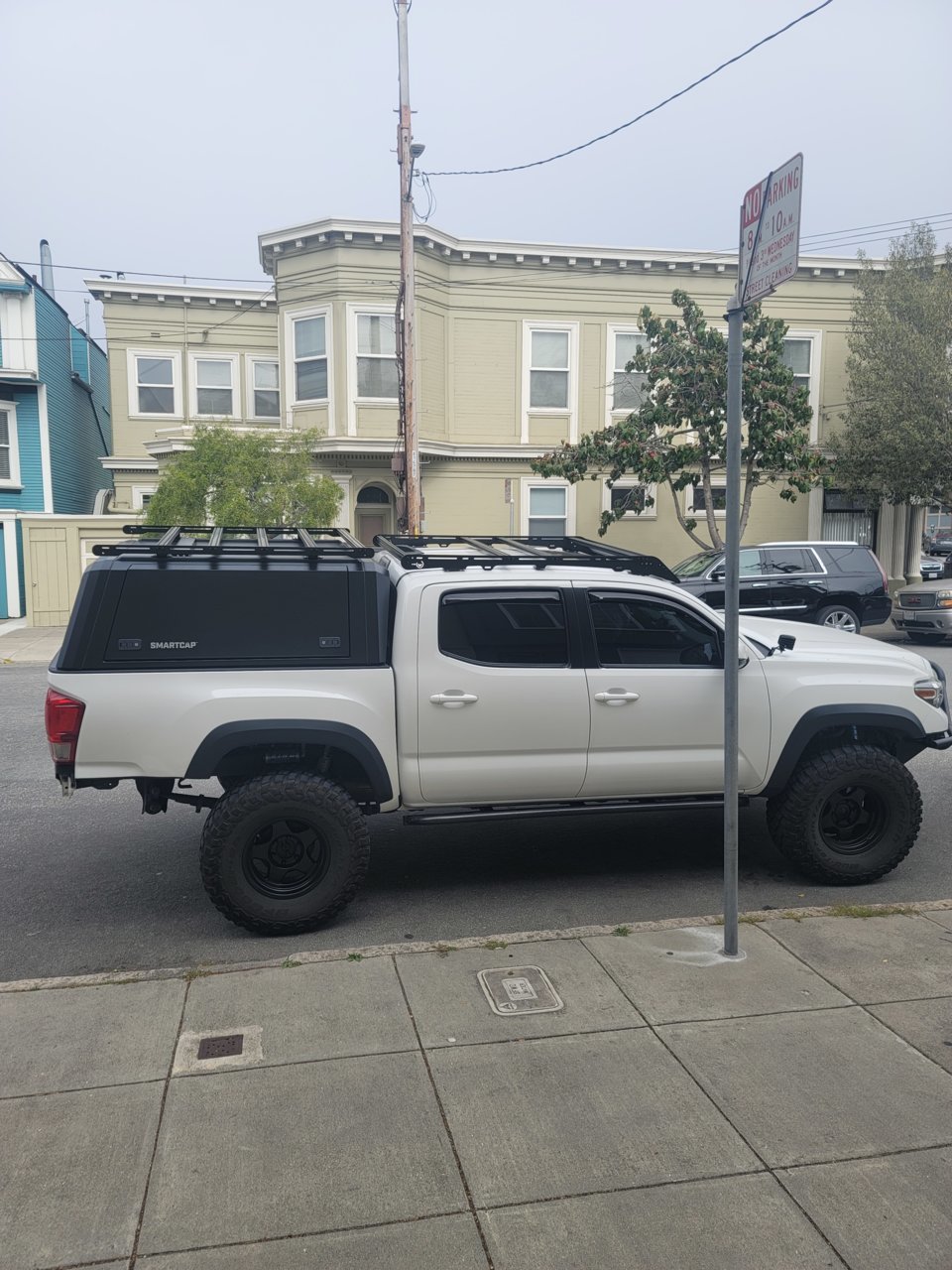

    Finally got my prinsu mounted to the rsi. I had to put some fender trim on the bottom side of the side rails because the side doors wont clear the rack.
    Can't wait to get the tent mounted up on the rack.

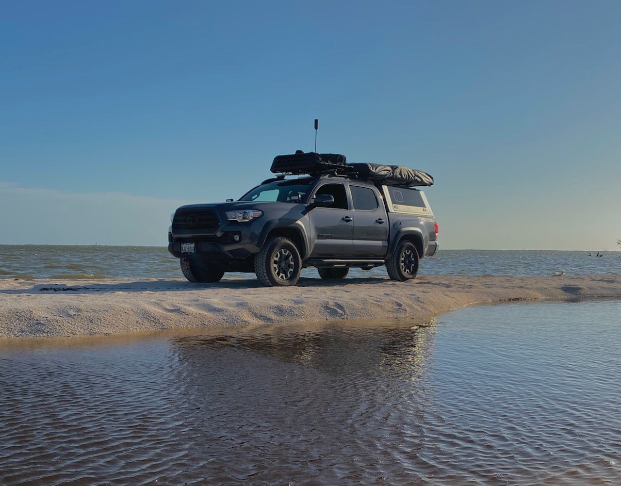

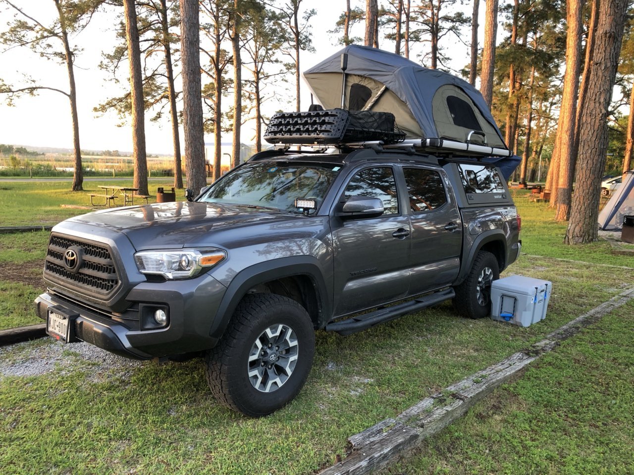

    Smartcap in use near Cape Canaveral FL and Spanish Fort AL

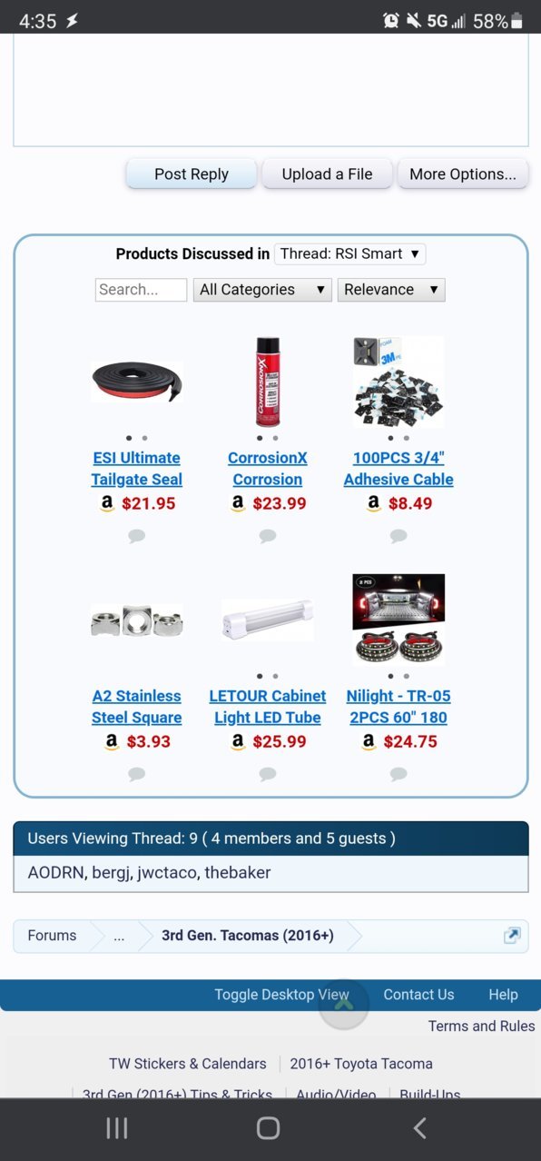

    Look at the bottom of this page. The A2 stainless square nuts are what I used to mount my prinsu on my smartcap.
    The products discussed in this thread appear on the bottom.

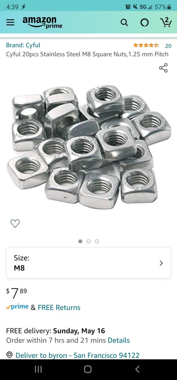

    I actually ended up using these:

    Duh! Should have looked there, Guess I'll have to drill out the feet to accept an m8 since the m6 isn't as wide.

    Also forgot to Thank you for the help, and for anyone who cares the uptop ex Bravo feet holes are big enough for m8 hardware so no drilling required.

    Glad you didnt have to drill. For anyone wondering, i had to drill my prinsu feet to fit the m8.
