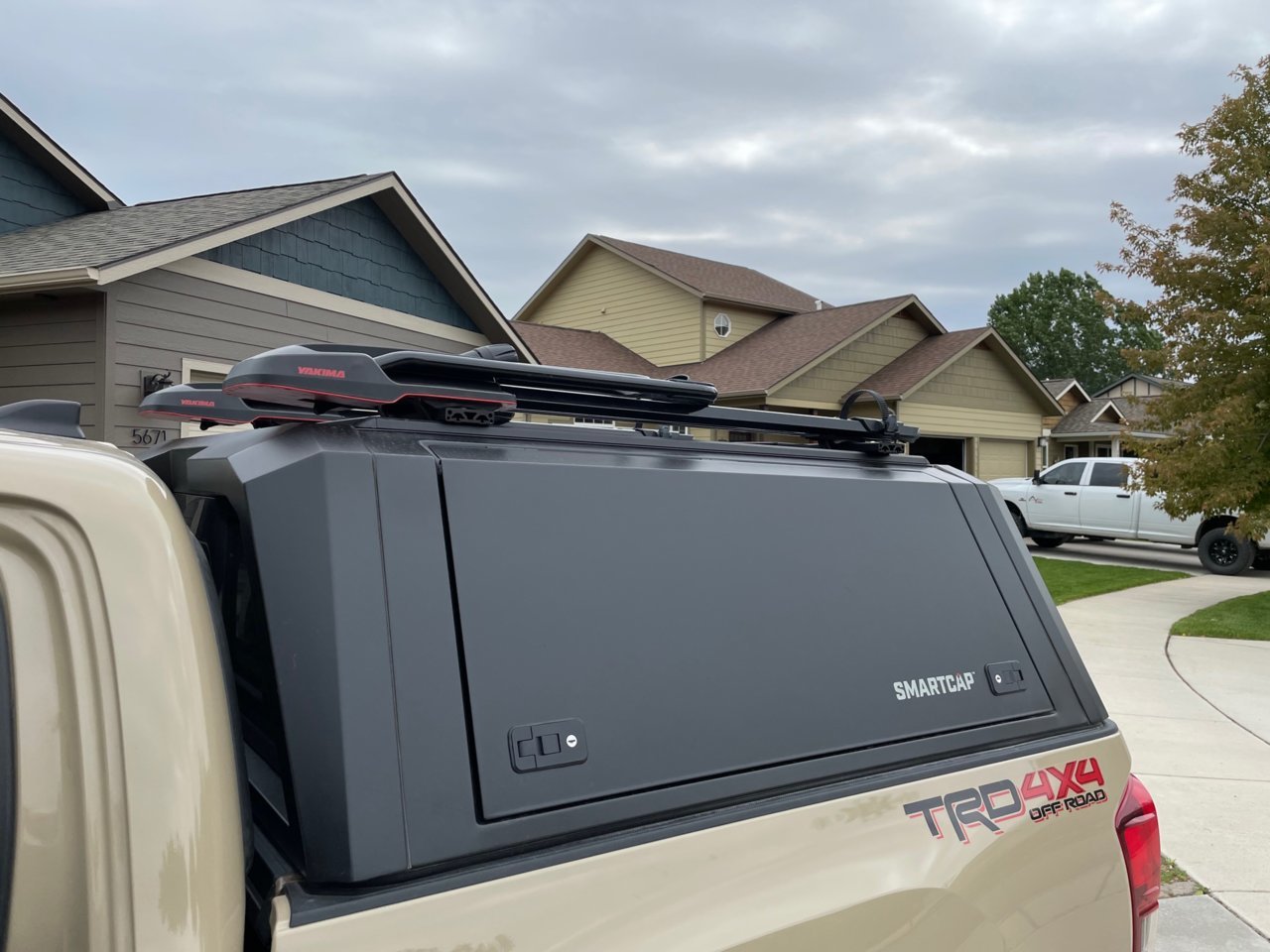

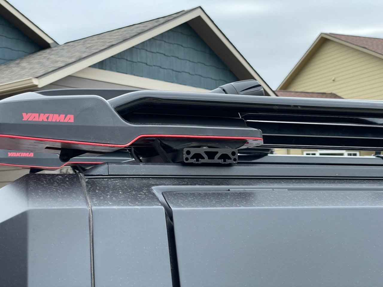

    Where’d you order from and how did you attach the bars? Any load stress placed on the tracks mounting the aluminum directly?

    The load is spread out over the 3" width of the rail, I think that's more than enough to handle almost anything. The bars themselves are heavy for their size. I drilled two 5/16 holes through each 8020 bar to mount to the RSI rails. I do have the 8020 extrusions with the T-slot down, so the top is perfectly flat. I did this because I didn't actually need the T-slot and I added rubberized plastic inserts to the T-slot so that the contact between the RSI rail and the 8020 bar is on the insert and not completely metal to metal.
    I ordered the following from 8020.net
    SKU: 2110
    15 Series Standard T-Slot Cover
    SKU: 3075-Black-FB - Cut to 42.5 inches
    3.00” X .75” Smooth Surface T-Slotted Profile - Two Adjacent Open T-Slots
    I bought the hardware from Amazon
    M8 square nuts
    https://www.amazon.com/gp/product/B07RNZSQ6H/ref=ppx_yo_dt_b_asin_title_o00_s00?ie=UTF8
    M8-1.25x30mm cap screws
    https://www.amazon.com/gp/product/B07ZF68XHB/ref=ppx_yo_dt_b_asin_title_o08_s00?ie=UTF8
    I had some lock washers on hand and would recommend using them or Loctite.
    The biggest downside is 8020 is very slow for custom items. The anodized items are anodized after being custom cut so the lead time is about a month maybe a bit longer.
