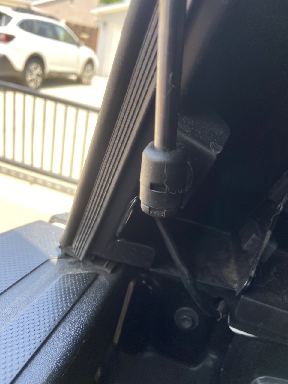

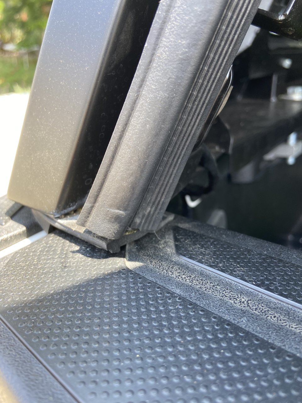

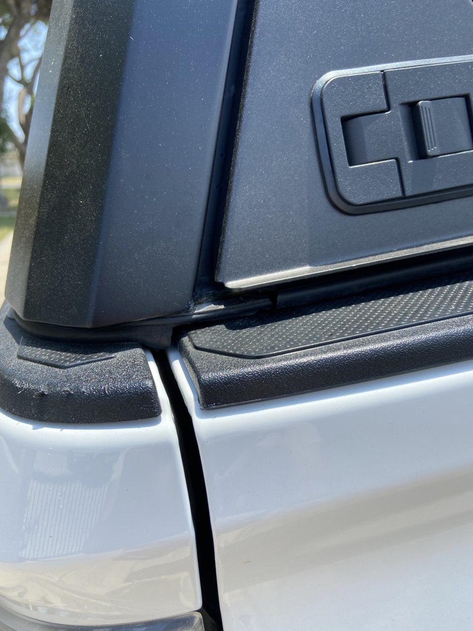

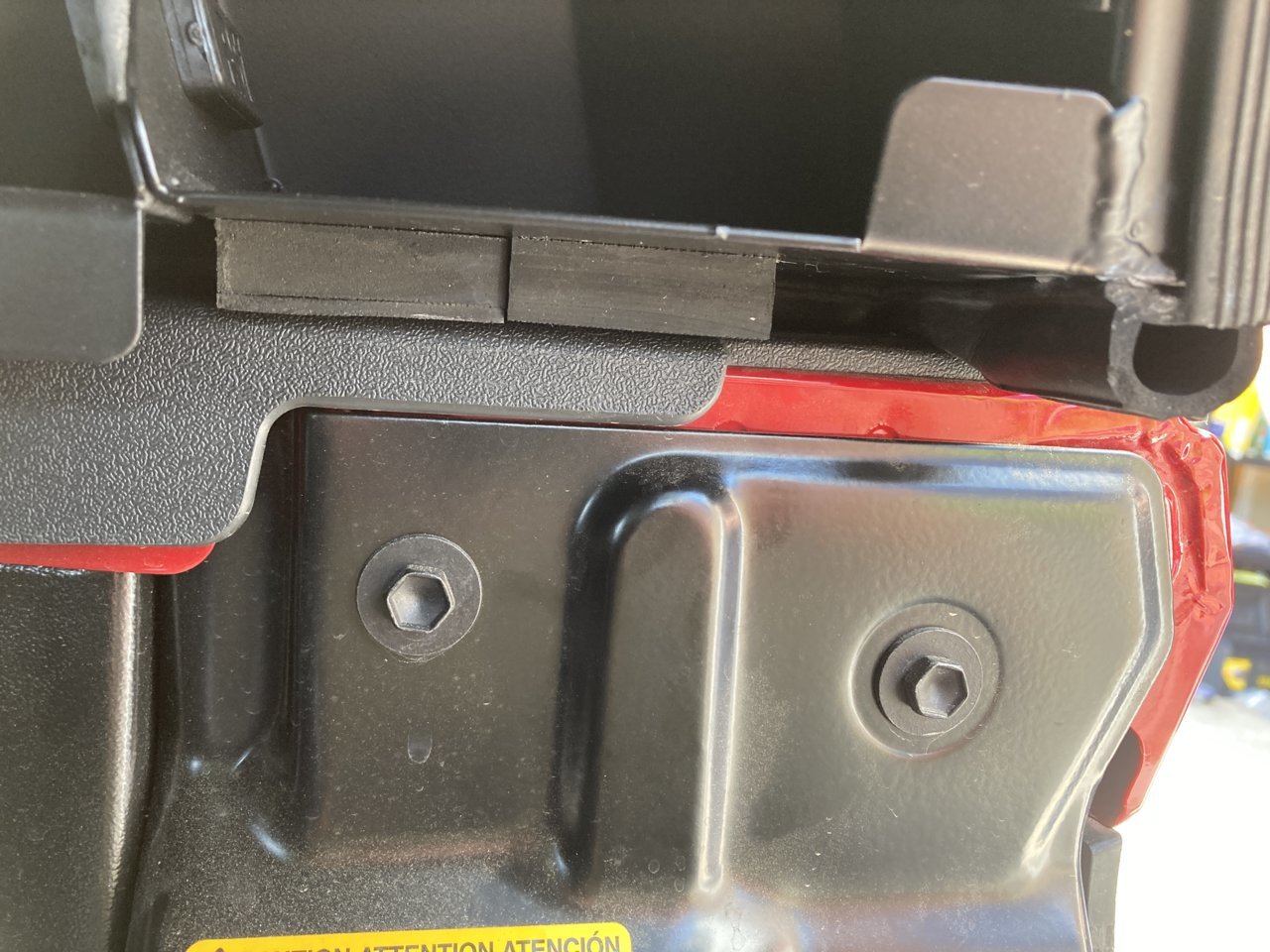

    Anyone with an RSI Smartcap have issues with the tailgate closing due to the D seal on the edges of the cap where it meets the tailgate and if so what was your solution to fixing it?
    I did use the rubber blocks which came with the cap and also used less then recommended torque setting for the cap (80 IN-LB).

    I ended up trimming the seal so that when the tailgate closes it doesn't interfere with it. When I wash it the water drains straight out the back.

    Thanks, I’m still trying to resist the trimming of the seal but I might do it as well, for now I used an additional
    Rubber block close to the tail gate right next to the one I had there before (total of five rubber blocks on each side now) it seems to raise the cap just a bit to where the seal doesn’t not rub as much as before, also applied more super glue to the seal.
    I ran into a Jeep Gladiator fella with a Smartcap on and he recommended me not to use the RSI recommended torque setting for tightening down the set screws, he told me that he used the recommended torque setting and broke all of the set screws, what was your experience with that, did you use the recommended 108 IN-LB, any issues/recommendations?

    I did tight and a quarter turn past. On the center ones they will bend. I did them almost to where they started to bend. I also put a rubber washer underneath the steel washer so that it wouldn't slip around if it did. Seems to work. I also use the rubber blocks and they seem to be better in the corners but in the center they don't do much. I've done some pretty good trails and it hasn't moved. I also have bed stiffeners which I highly recommend. The composite bed moves all over the place.
