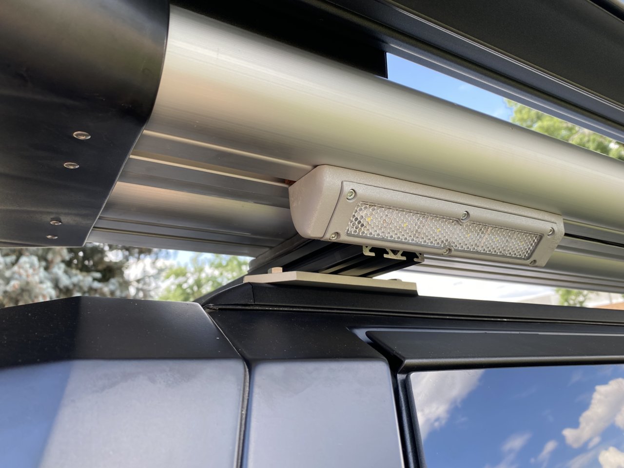

    Later today I'll be working on some black 80/20 as tent support crossbars... Rod holder will rest on those with rubber bushings to allow for bed/cab flex but keep it from bouncing. So far so good with this cap... love the look.
    One note with setup- the passenger side cap windows would open up so fast and basically hit the rod holder and lights I have mounted below... I took off one of the struts and the window now opens slowly and holds level with rod holder now- I'm sure I may have to replace the struts a bit earlier now, but its nice that its not banging on anything in use.
    Also- the branding stickers come off very easily if you don't like the "smart cap" text on the cap.

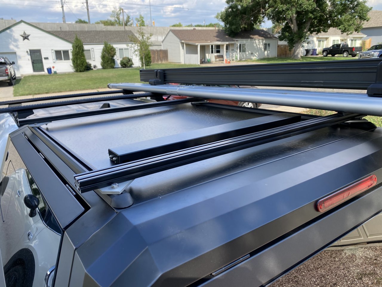

    Got the 1”x2” 80/20 crossbars installed today, super low profile and will eventually join with 80/20 bars mounted under the rooftop tent base. Mounted to 1/4 aluminum T plates.
    Just have to add end caps for the 80/20 and we’re set. Crazy solid. So impressed with this cap.

    Nice! What rack do you have in front? Do you have a side view pic?

    I did the rhino rack tracks in front. Rivet and bolt down for the tracks and some rhino rack crossbars up front on cab top.
