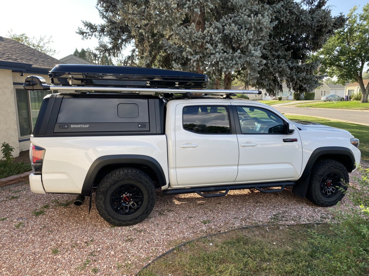

    Tent is on the cap. Ready to go.

    Looks good. You got a pic with the tent down?

    Here ya go
    I mounted the tent with 3” risers off the 80/20 crossbars on the smartcap so it can clear the rod holder. The Riversmith rod holder is mounted to both of the truck cab crossbars up front.
    For both the tent and rod holder I have supporting rubber pads points to independently allow them a 3rd support position to rest on, neither is hard mounted to both the cap and cab to allow for proper flex between.

    Looks great! curious where you found the t plates with the corners trimmed (or did you trim em?) And do you have them mounted in just one channel of the crossbar?

    I used these joining plates. 2 M8’s hit the smart cap nuts on the track, and off center the joining plate hits 2 T-nuts on the 80/20… so on the 80/20 it hits the center hole and either the left or right hole on 2”.
    https://parco-inc.com/product/10-s-5-hole-90-degree-joining-plate/

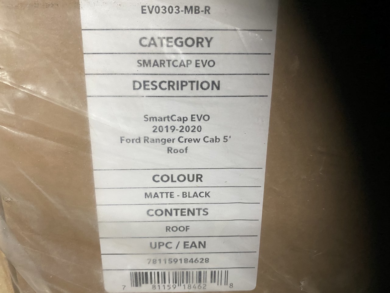

    I received my SmartCap today. A bit confused the information on the boxes states the following:
    EVO303-MB
    SmartCap EVO
    2019-2020
    Ford Ranger Crew Cab 5' ????
    Is this the right cap for my 2018 Tacoma double cab?

    The outside of my box definitely said Tacoma on it... I would have to assume that isn't the right one man, super sucks. Should be # EV1303-MB for 6ft or EV1302-MB for 5ft.

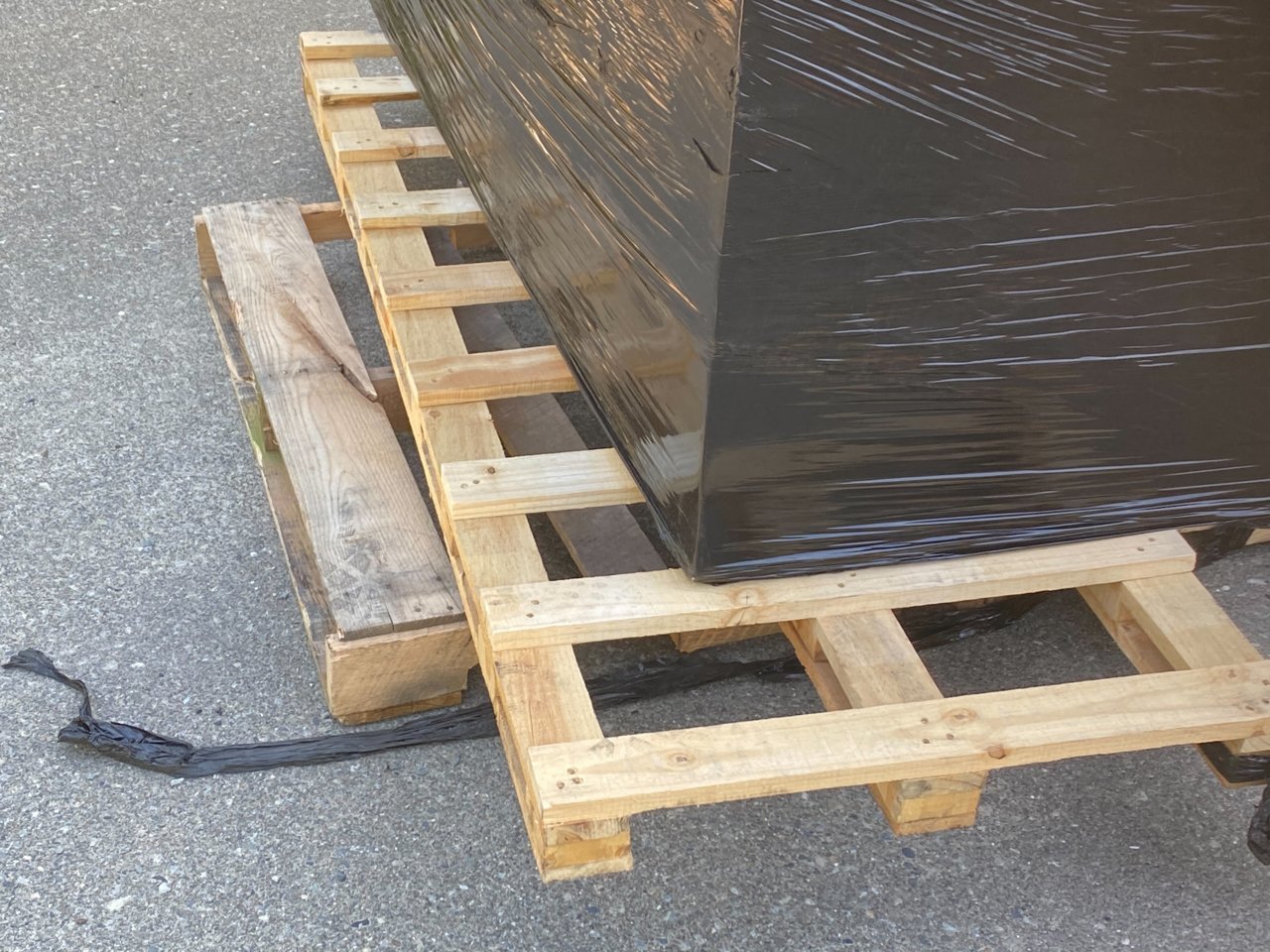

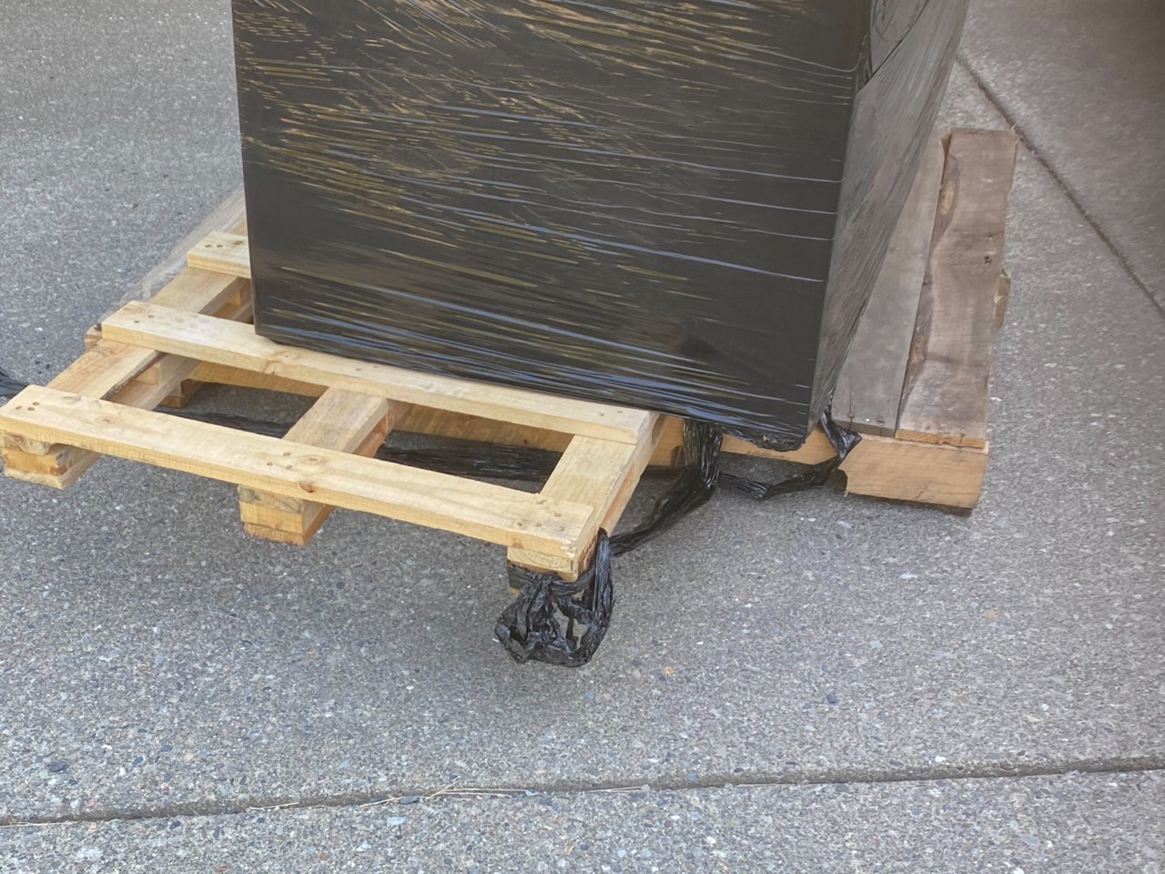

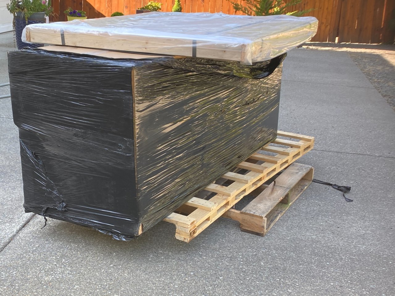

    I hope so because so far it's been a Debbie Downer.
    You'd not believe the condition of the delivery. Here are a few pics...

    I would say no, just checked mine I took a pic of the box it was
    EV1302-MB-FKB
    2016-2020 Toyota Tacoma 5'
    I hope you ordered from Offroad Alliance they are Great to deal with

    RSI shipped the wrong one. We'll get it back and get another Tacoma cap shipped ASAP.
