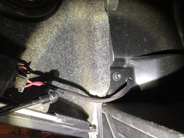

    With the help of my neighbors, I was able to install the cap today. Put it together yesterday and finished install today.
    Im stuck on my last step though. I can't figure out how to connect the wiring harness to the brake lights for the 3rd brake light. Does anyone have any feedback on this? Thanks!

    This is from my LEER, hope it helps/gives you an idea...

    Thanks Mike
    I just called Off road alliance and they told me specifically that the wiring harness doesn't have all the included parts to install. I kinda thought something was missing or off. It didn't make sense to me. (unless he didn't know what he was talking about - his name was chris)
    So I am tapping into my brake lights and wiring it up myself instead. I have the ground just now. Which wire is the power wire for the brake light, is it the blue wire? Thanks

    If you get stuck on this I’ll pull the taillight off tomorrow and verify which wires were tapped. In the past when I’ve wired them in myself I’ve skipped the brake light and just ran a new wire from my truck battery (with an in-line fuse) to the light. You do run the risk of forgetting to shut the light off and draining the battery that way though...

    Yea, I'm Chris. And the caps are all missing the adapter wire per our RSI rep about a day ago. And it's not our inventory, it's all inventory apparently. Regardless, it's basically a trailer wiring harness adapter or so our rep described it to us. Personally I think tapping into your brake lights is the easier solution like you mentioned on the phone.

    Hey Chris, and everyone else reading,
    I ended up tapping into my tail brake light wire (Blue wire (1)) and grounded it to the existing bolts that are't supporting anything. It took two minutes. Brake lights working!
