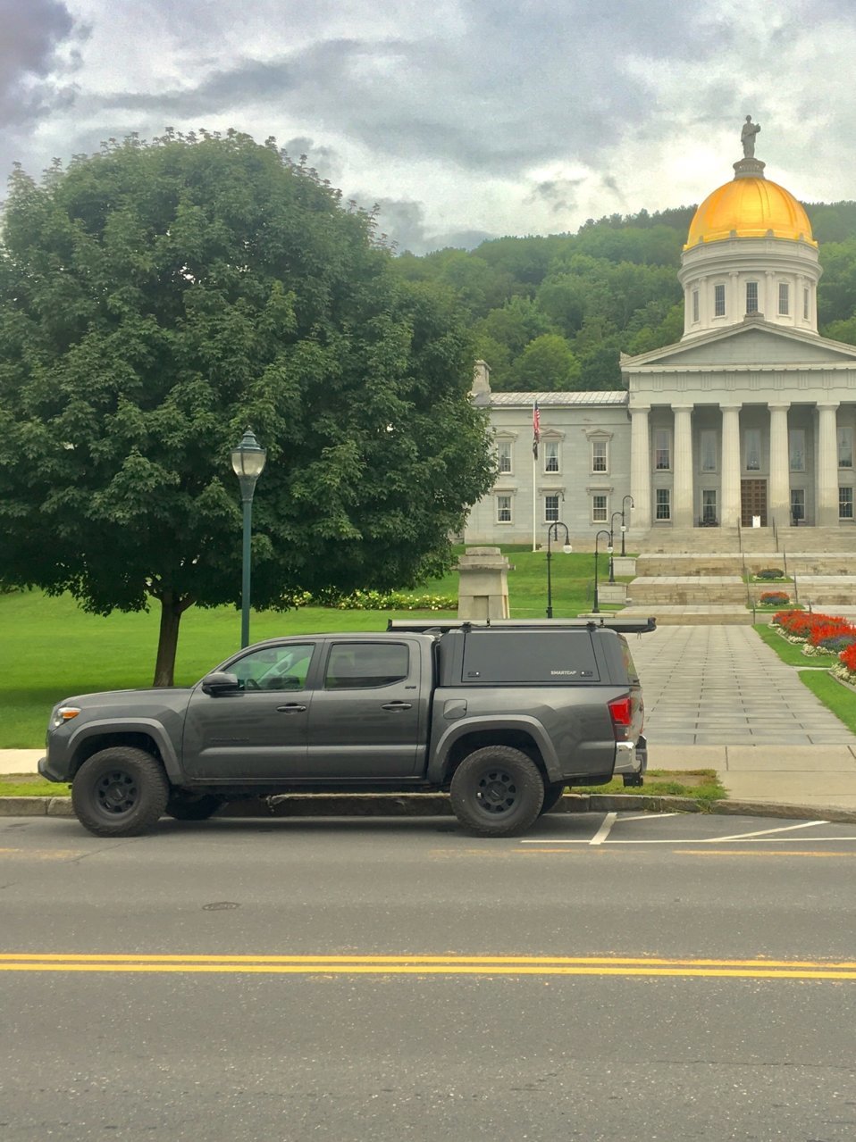

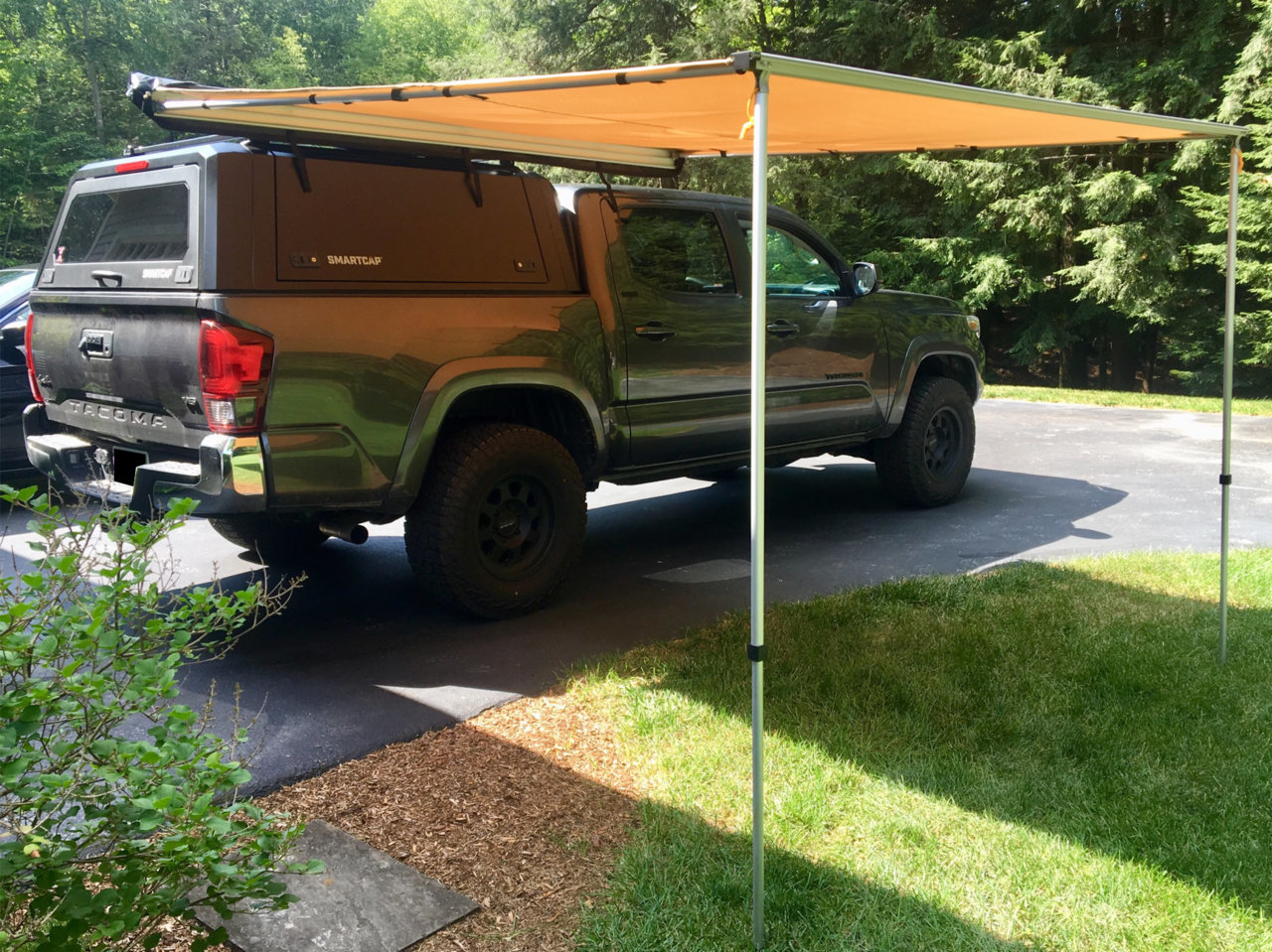

    Finally got around to uploading some pictures of the RSI Cap on my '18 Short Bed. Awning is the $99 Napa special.

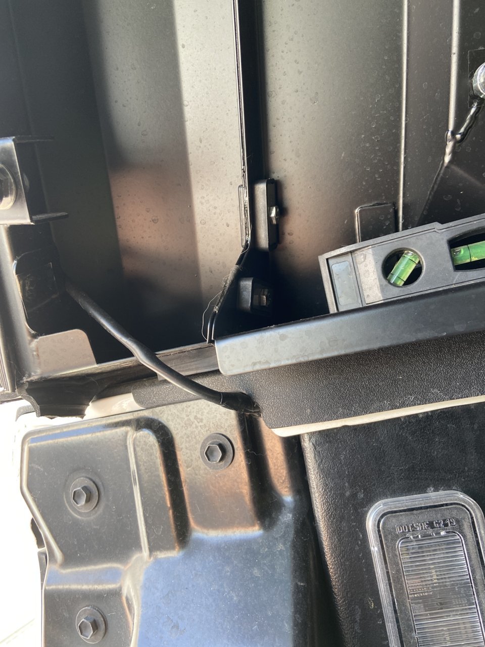

    Mine also came with a wiring harness for the brake light. Everyone including the shop I bought the cap from, told me to drill through the bed and run the wire.. no need to do this.
    If you bend back the plastic that sits on top of the bed edges, there is a hole that fits the RSI harness perfectly (you're then able to run the harness/cable out to the tail light). I'll upload pictures today/tomorrow if you want.

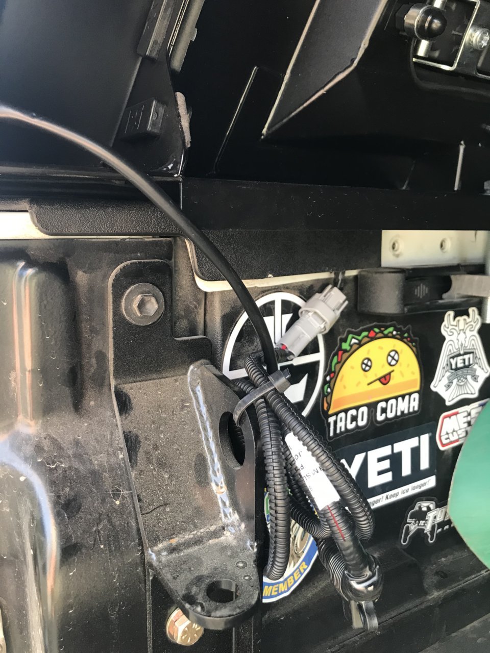

    Thanks folks. I forgot the obligatory pics :)
    So I have the wires coming out the top of the bed as noted above but the extra coil of wire zipped to my bed stiffeners is going to bug me eventually…anyone have ideas on how to tuck them away?

    So I ran the wires at the same location you did, however I disconnected the wire harness from the point that runs up to the tail light and zip-tied excess wires between the body panels under the wheel well. I will take some photos this afternoon when I have a chance to.
