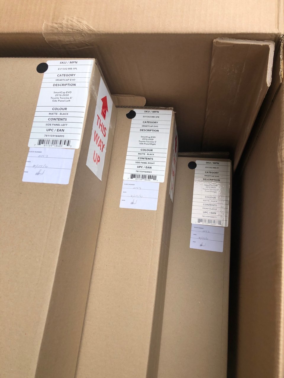

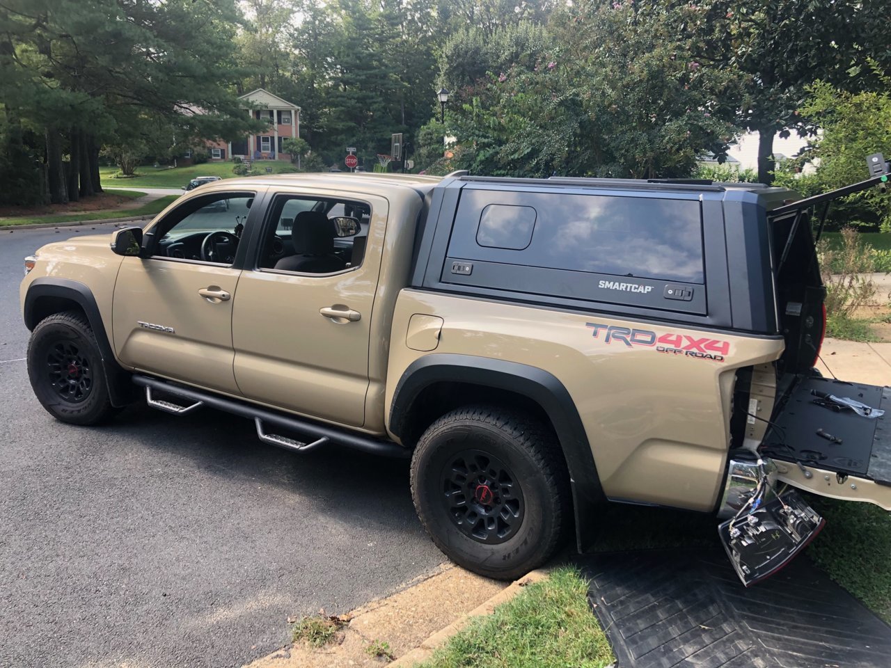

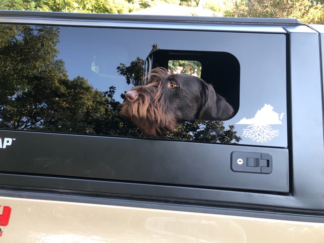

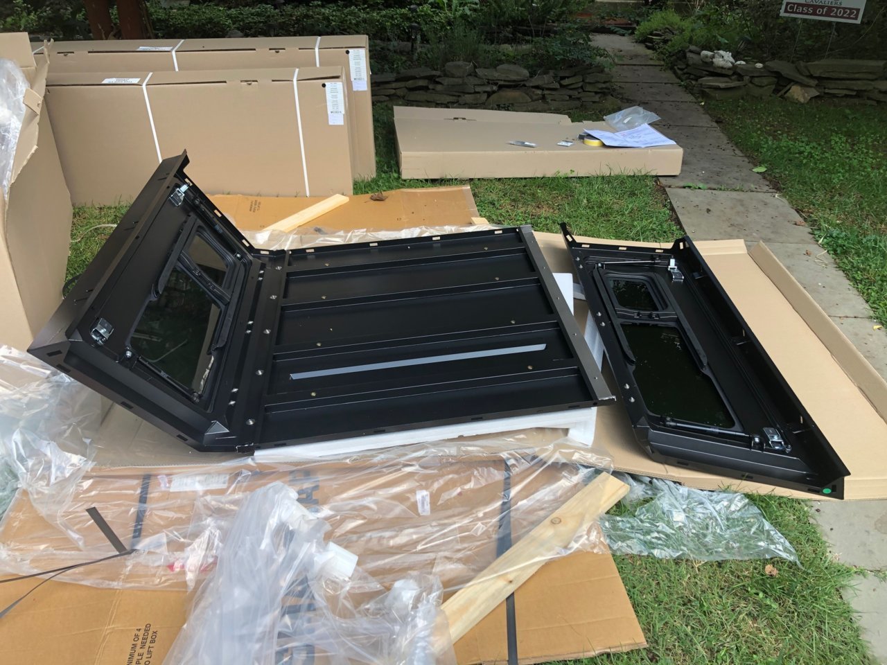

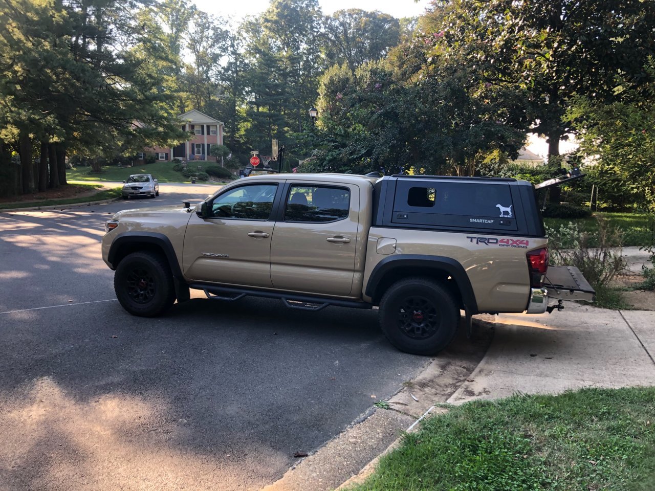

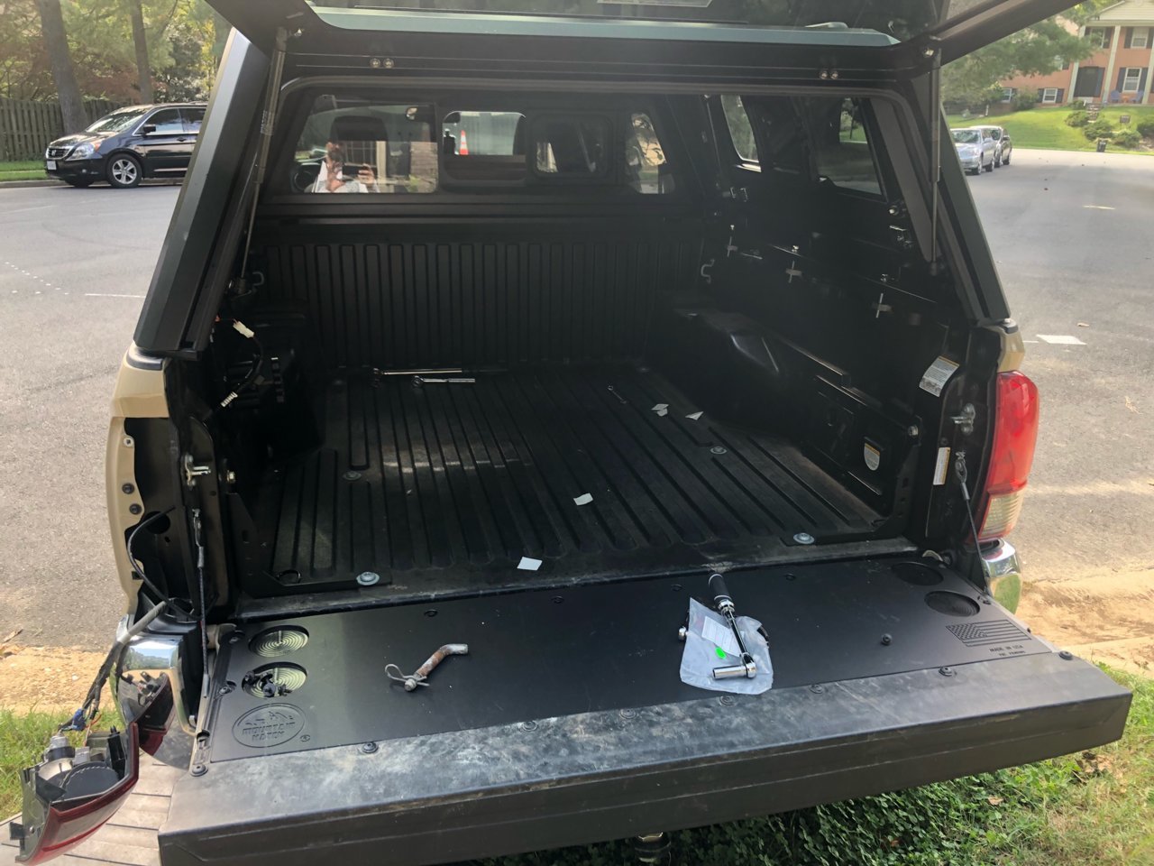

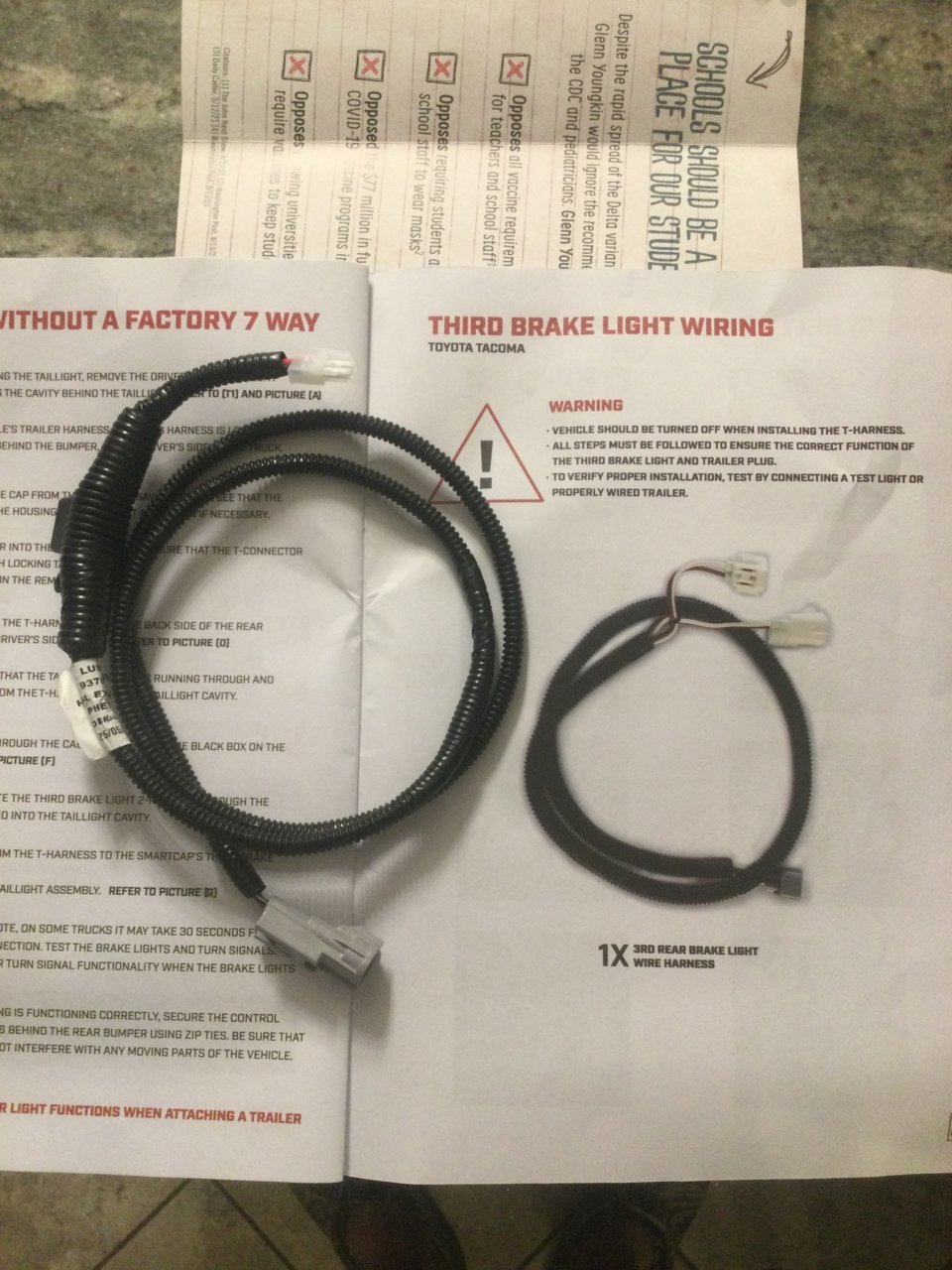

    Alright - I got it together and got it on my Tacoma. I tapped into the tail light and it seems to be working.
    The boxes came well packed and the pieces fit together fairly easily. I only needed a spare set of hands with the front and rear flanges to get them aligned and bolted together.
    Huge shoutout to Chris at @OffroadAlliance.com for helping submit a warranty claim on the missing pigtail for the 3rd brake light.
    The most important thing is that the pup approves (and Ripley does).

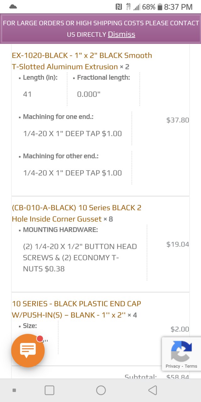

    What's the series / dimensions of these 8020 extrusions you used for these DIY bars? Looks killer!

    This is the item list to build them out
  13. Sep 20, 2021 at 3:26 PM
    #1573
    Nick1992
    Nick1992 Well-Known Member
    Jul 5, 2017
    #223177
    564
    Nick
    2017 Tacoma

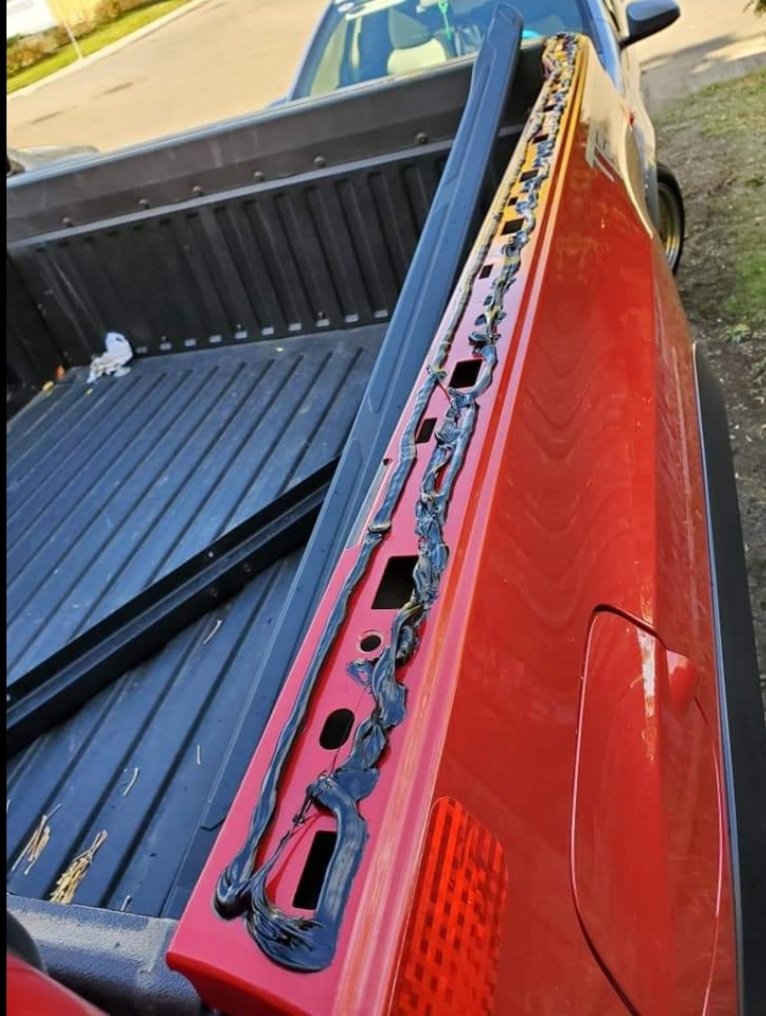

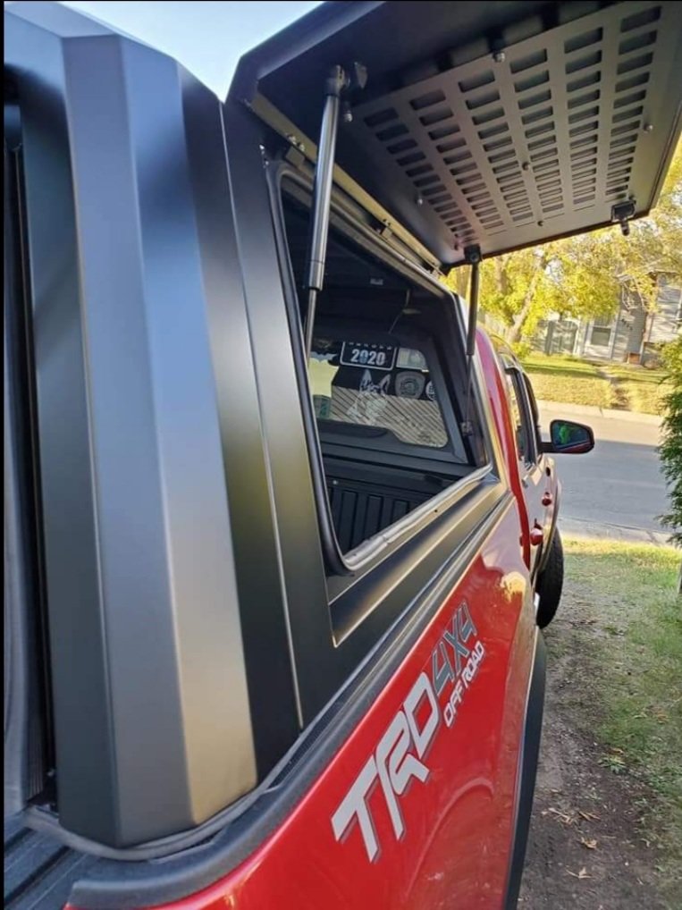

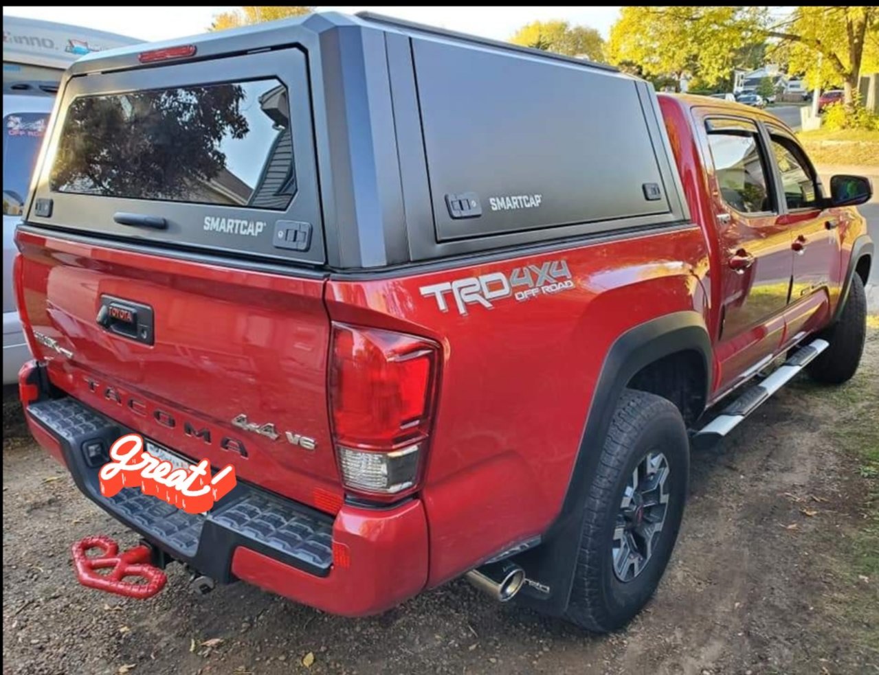

    Got mine on Friday!, installed on Sunday (EvoA Adventure)
