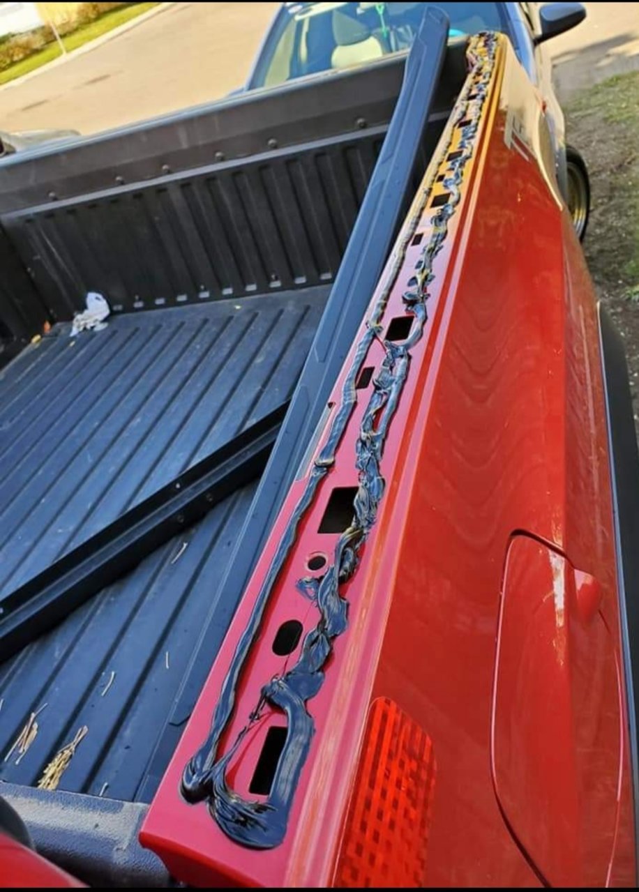

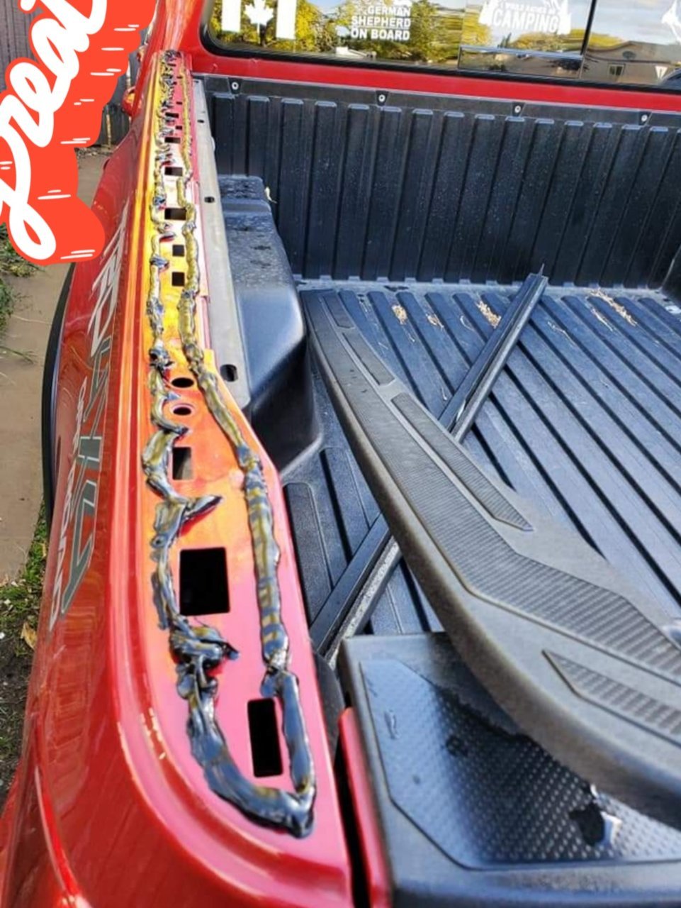

    Hi brother,
    For the sides you just need to un-snap the trim (left and right sides of the box). For the front, the metal header piece you need to unscrew (you will need a star socket). Instead of silicone I myself used polyurethane (you can find it at automotive stores, or maybe home depot might have it. Benefit of urethane over silicone is that it provides a seal without separation, silicone will). Then seal as much as you can, two tubes did the trick for me.
    https://www.amazon.com/Sikaflex-221...ne+sealant+sikaflex+221&qid=1632529029&sr=8-3

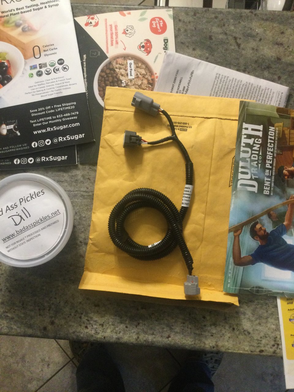

    Haha! I’m back in business! Thanks to Chris from @OffroadAlliance.com for submitting the warranty claim. RSI mailed me the missing pigtail and it landed today! It’s getting dark now, so I’ll pull my temporary splice and install it tomorrow morning. Thank goodness it landed this weekend - I leave Monday for a multi-week hunting trip out west

    Yes, the box trim pieces will unsnap quite easy, just don't need them...be gentle. Lay down the polyurethane then snap back the box trim pieces

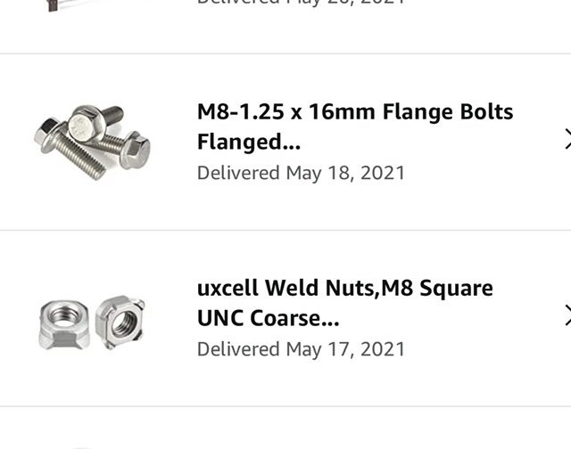

    I’m planning to get a Roofnest Condor XL. Btw how did you fit the Prinsu rack on the RSI? I need to do some research on that if you don’t mine sharing some tips. Also what’s the best way to seal the cap?

    And for the Prinsu rack to mount, I had to buy some weld nuts and different bolts that would slide into the t-track on top. Then I had to file the holes on the mounting brackets for the Prinsu so that the new hardware would fit through. Really easy! I just used a dremel to file out the holes.
    I added a pic of the nuts and bolts I bought from Amazon.
