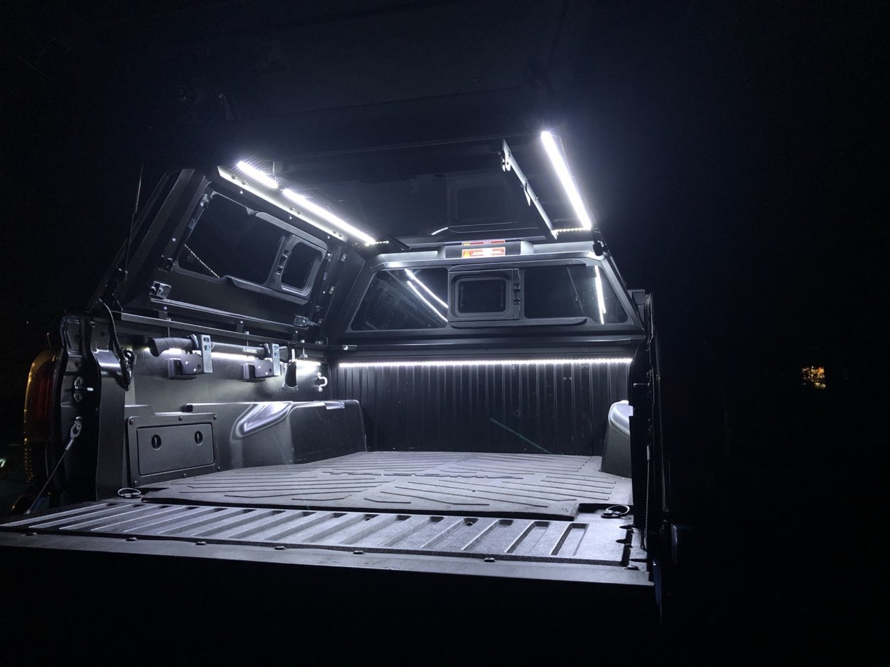

    I already had Matt Gecko LEDs for my bed that I put in a while ago. Once I got my cap I emailed Matt and asked him just for the RSI LED strips, didn't need the rest of the kit. He was happy to sell me just that. I wired in the lights with the bed lights on the same switch and circuit. I had previously replaced the switch with a sealed marine unit since the original one didn't last one new england winter without developing the green crusties.

    So you were able to just tie in to the Gecko power supply at the back of the bed without running another set of power cables to the battery? I wasn't sure if the original wiring from the Gecko bed lights was able to power both the bed and the RSI lights. If so, I'm ordering an RSI set from Matt.

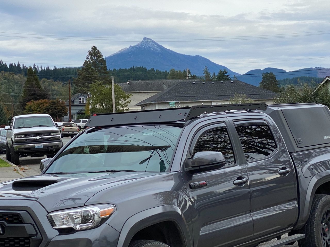

    I used m8 square nuts in the rsi tracks (like the ones linked at the bottom of this page) and 16mm length screws to mount the prinsu feet onto my smartcap. I did have to put fender trim on the bottom edge of the prinsu rack because my side doors on the smartcap were slightly hitting the prinsu rack when fully opened.
