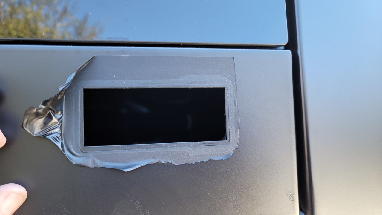

    So I took the plunge and pulled off the rsi smartcap full length stickers. Very happy. Still contemplating removal of the last one on the back. Went with the @Tacovinyl logo for a retro look....20201229_141342.jpg 20201229_141146.jpg

    Nice! Good to see someone else using the 4 wave decals! @Afilao sent me some test decals of the RSI logo in matte black that I'll throw on the back in a day or 2 when I finally remove that last decal (its a big one on the back.) I hadn't even contemplated removing the latches, was it complicated?

    Lock removal was simple just a Philips screw on the inside and simple sturdy three-piece construction.

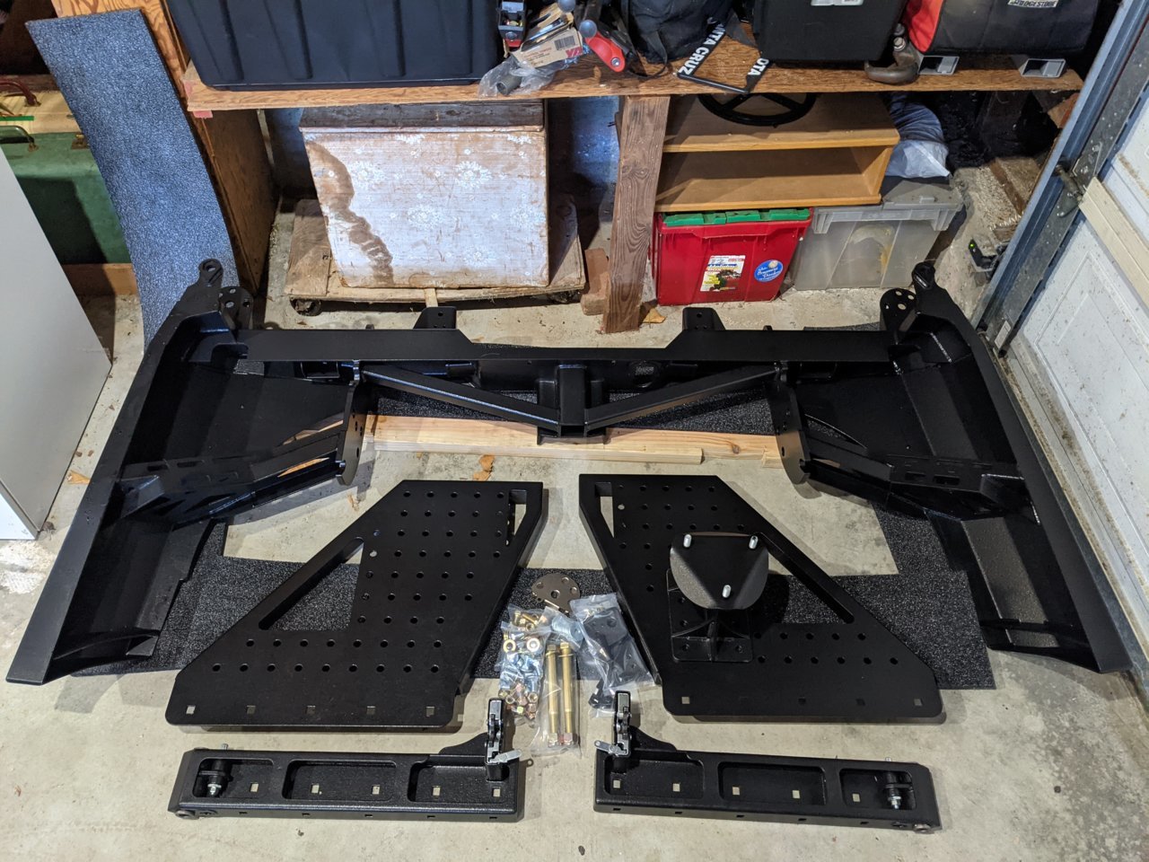

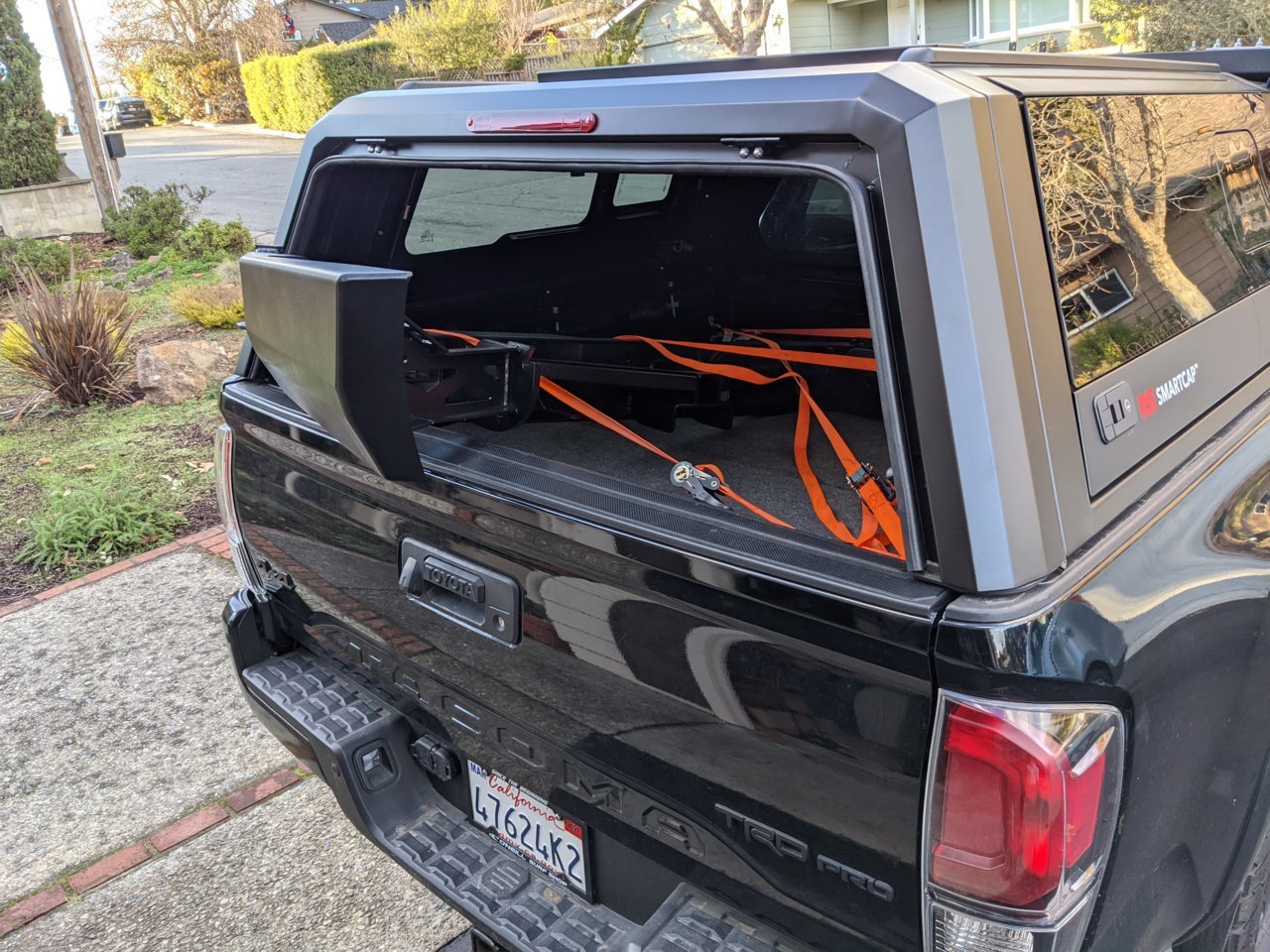

    @minium and anyone else wondering.
    It's super easy to remove the glass panels from any side. It's 4 nylock nuts on a flexible hinge. It also has a rubber washer so the mini T slot bolts don't fall out of the bracket. Pics below. There are little retention clips on the Gas struts on the top. Put a small flathead screwdriver in the slot and open the clip, the gas arm will pop right out. Went back on just as easy
    Easier with 2 people but wasn't too bad balancing on my head to get the nuts on hand tight.
    Excuse the new toy... er I mean protection and necessary spare tire upgrade.

    Thank you! You have great timing, around the time you posted this is when I had made the call to order mine. Should be off and running in 3-4 weeks. I got the impression it wouldn’t be too difficult just looking at some of OP’s detailed pictures, I’m glad you confirmed that! Post an update after you get that tire mount installed, looks like a beast.

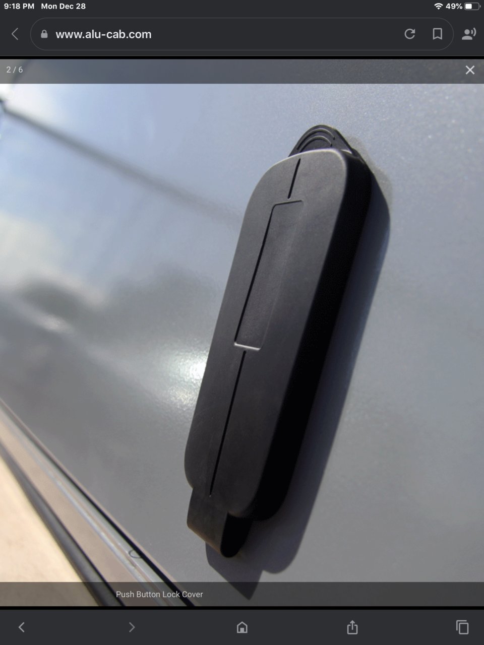

    I don't know if the locks on the Alu-Cab are exactly the same model/manufacturer, but something like that would be a nice option from RSI. I definitely had a problem last week with my locks freezing. Came out to a heavy frost and could barely depress the button to release the latch, and then it just stayed depressed and the latch wouldn't pop open. Fortunately I had a can of de-icer in the cab and after spraying them with that loosened them up after a minute.

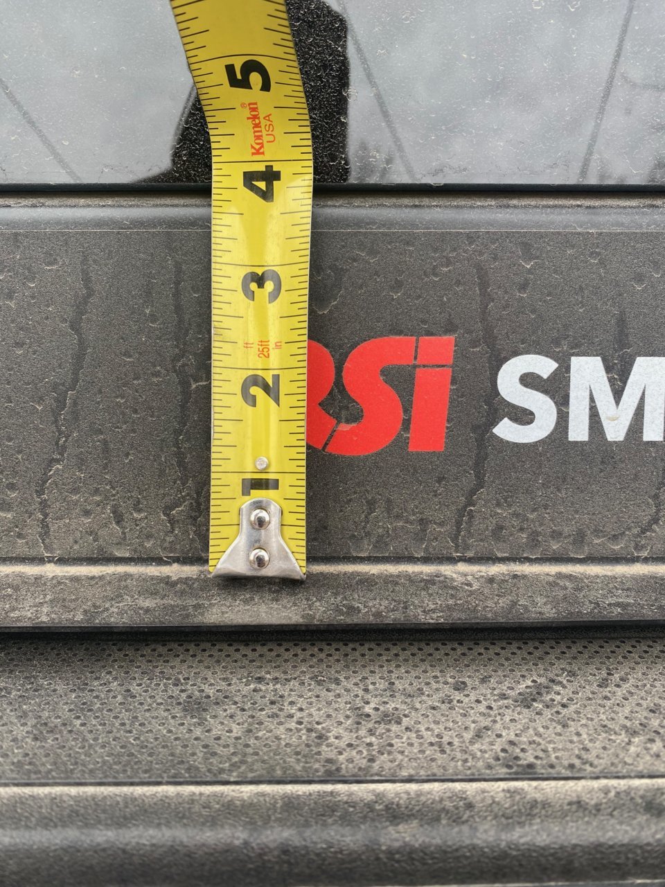

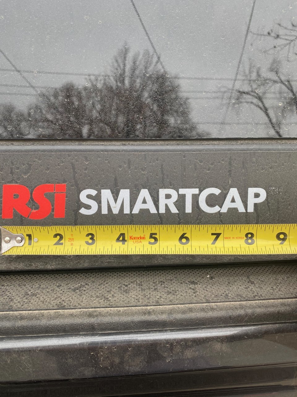

    @TopQuark I haven't seen the SB model in person, but from the photos here the LB seems to be a better fit. Mine is installed flush with the front edge of the bed and goes basically right to the end of the bed rails. The trouble is that the top of the tailgate curves out from there and the cap is straight, so there is a bit of a shelf left over, about 1.5". It's just designed to sit on top of the rails and the gaskets do the work of sealing it instead of an overlapping drip edge. Admittedly a drip edge would be more fool proof, and I guess if that bothers some folks there's nothing to be done about it, but I haven't found it to be a problem yet.
