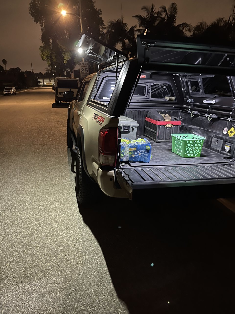

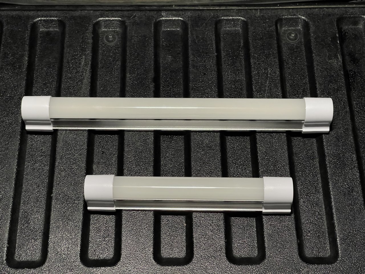

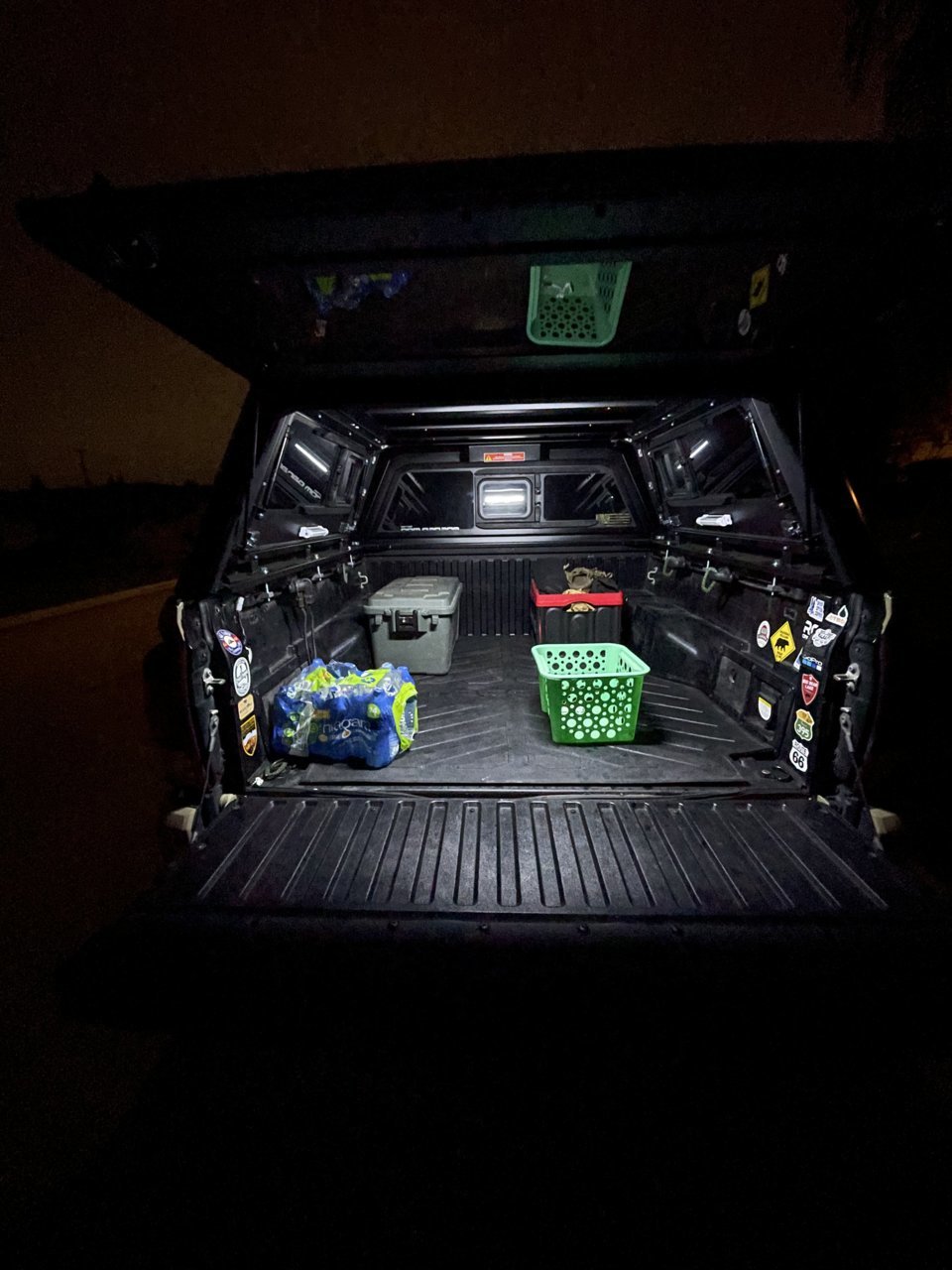

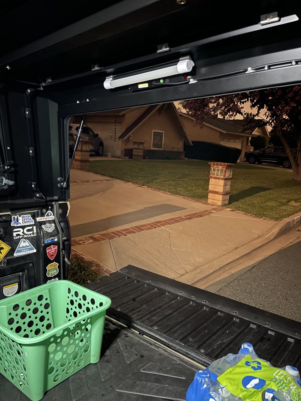

    Found some lights that seem to work just fine. I went with an LED light with a magnetic back so I can move the lights around when needed. I chose one large one to light up the bed and two medium size ones that are on the doors to work as scene/camp lights. It’s a relatively cheap option and offers tons of flexibility. I was looking into hardwiring lights but this seems to be a better solution for me. I don’t tend to use bed lights for that long of a duration and could use these lights in other scenarios and they’re easily rechargeable through USB. Here’s some pics so you can see how bright they are at night and where I placed them and links to purchase are below.
    50AE96F8-361E-4024-BA92-E6E06C51463D.jpg 98FB8EE1-891E-4549-B44B-0D58718CB10C.jpg 4685B1F3-2566-4D40-8C95-AA8C5E73EBEA.jpg C540050C-1F51-4114-87CD-71E1FE7D0133.jpg
    LARGE LETOUR LED Tube Magnetic Light... https://www.amazon.com/dp/B074QL8GGJ?ref=ppx_pop_mob_ap_share
    MEDIUM LETOUR Cabinet Light LED Tube... https://www.amazon.com/dp/B074QLJMW6?ref=ppx_pop_mob_ap_share

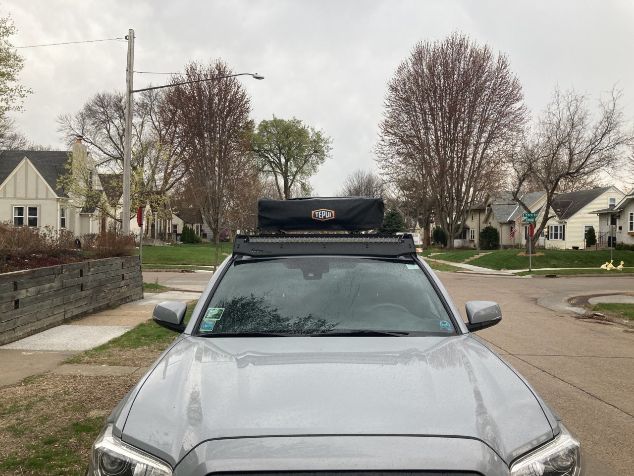

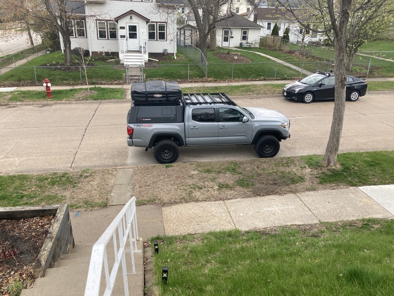

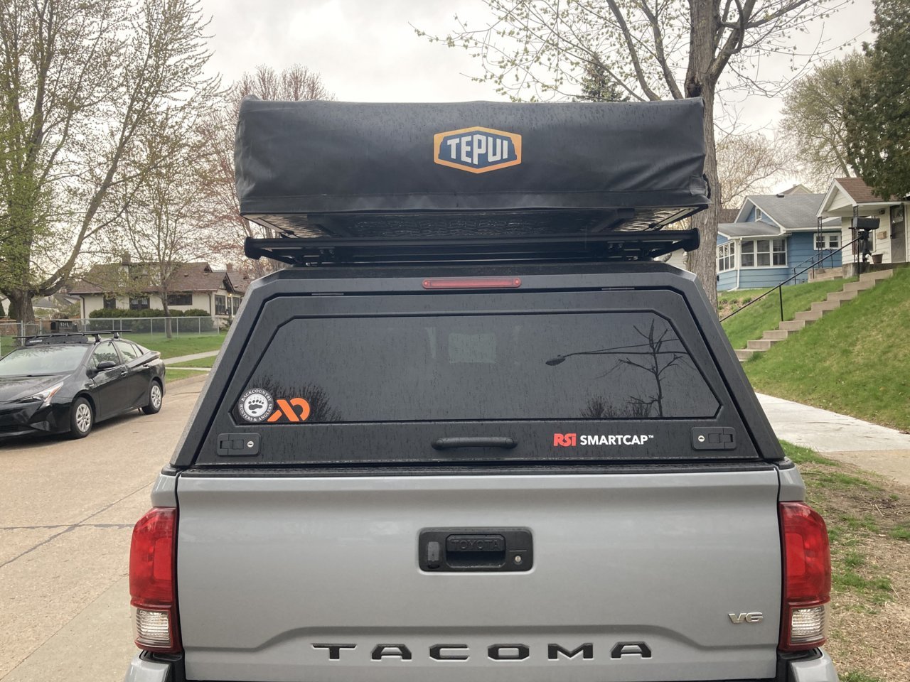

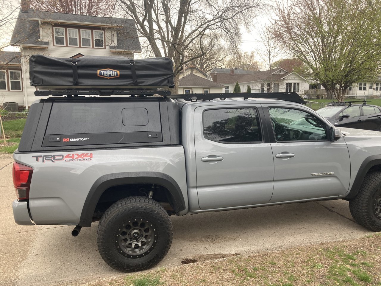

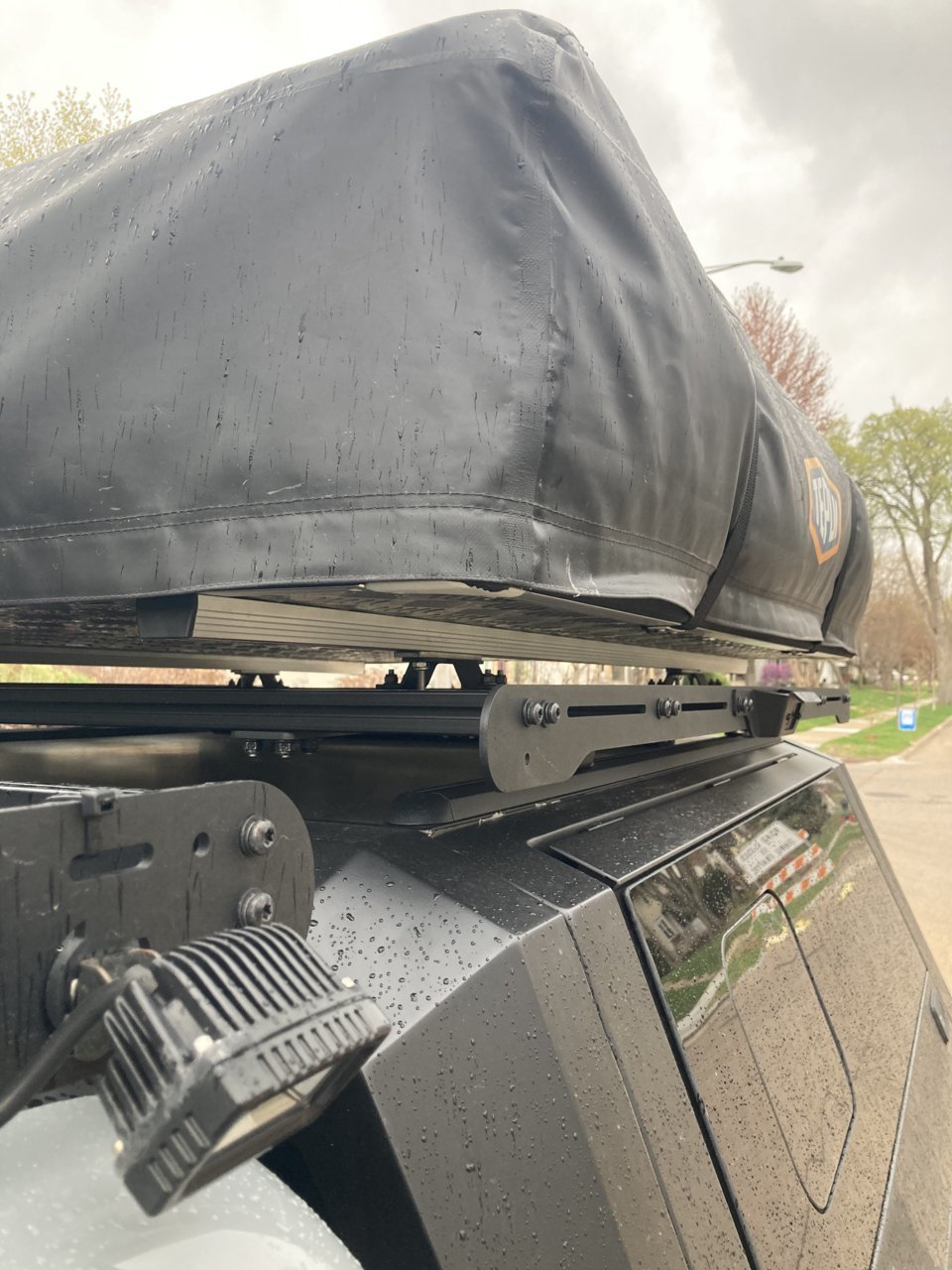

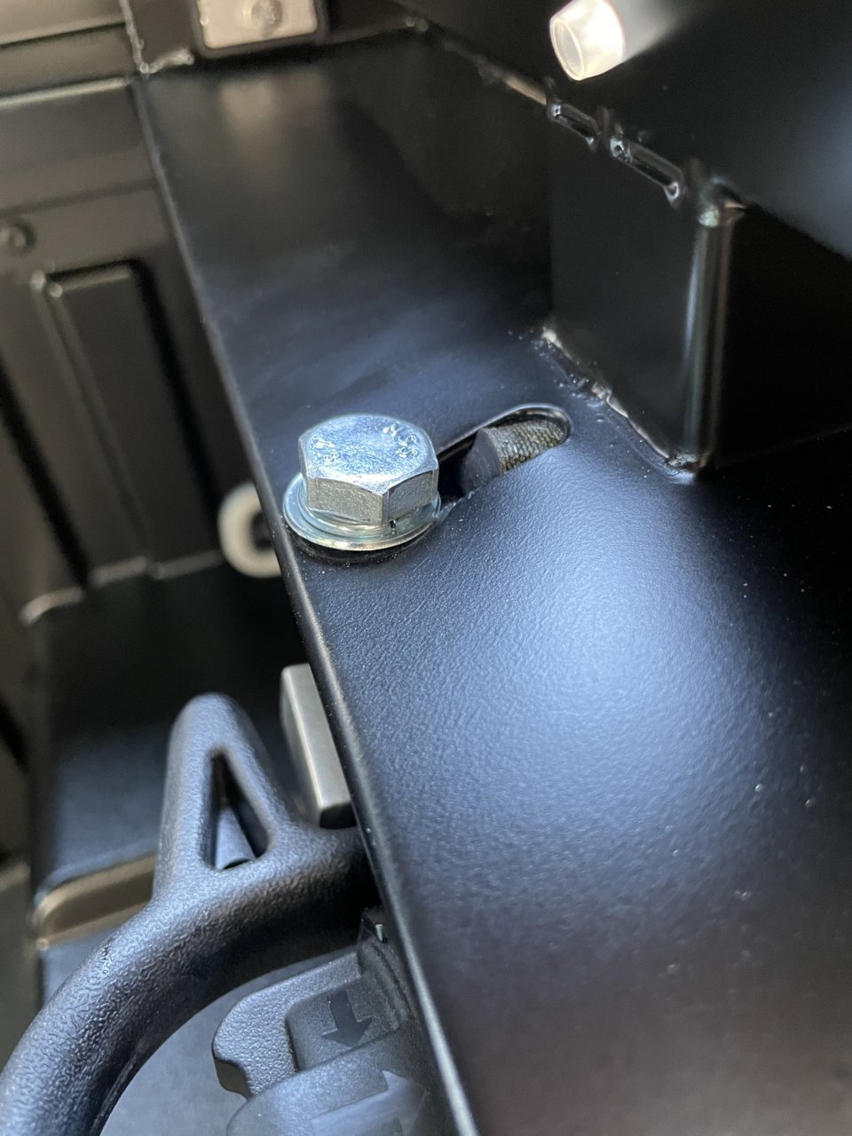

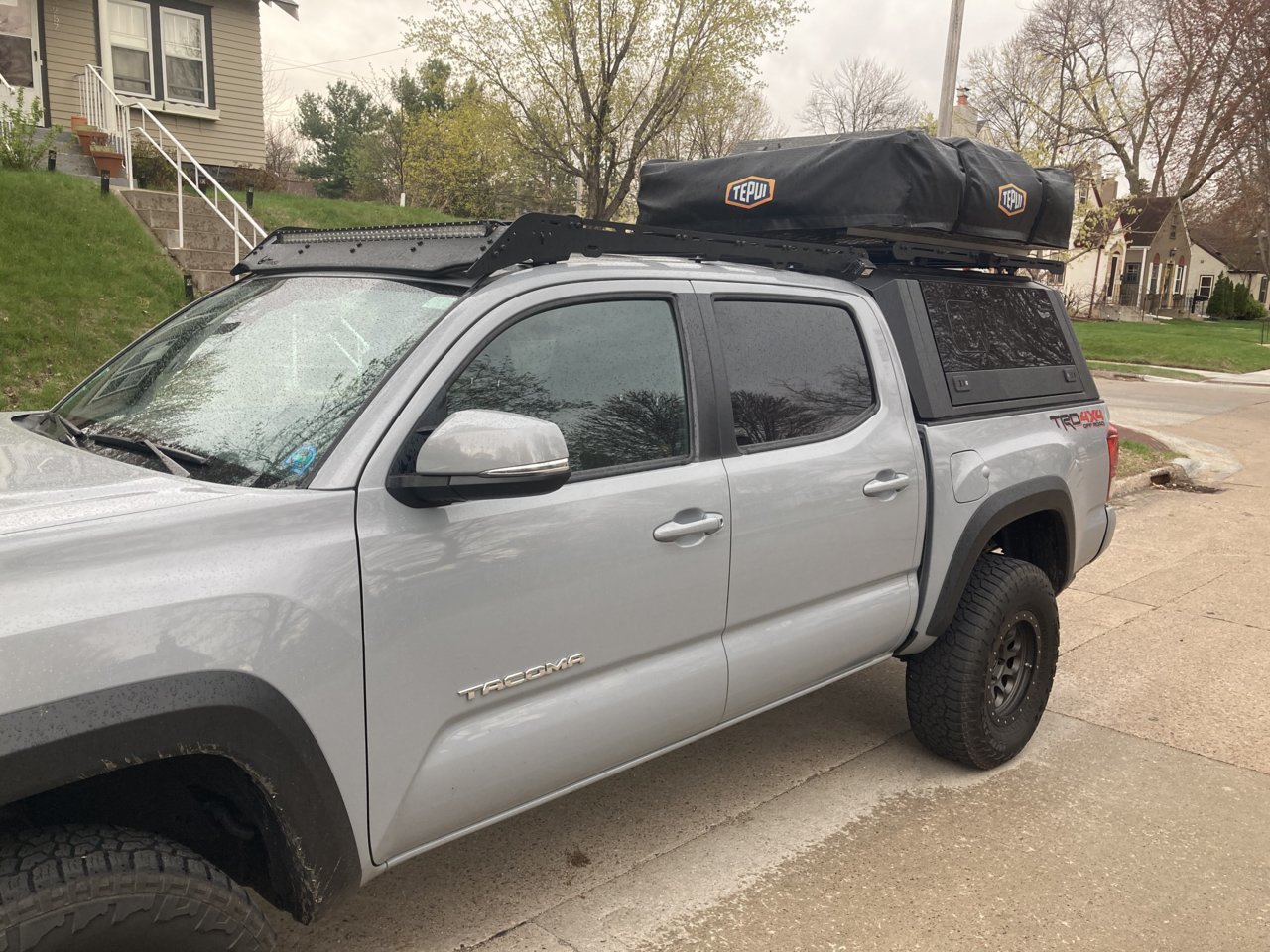

    I have a Prinsu rack on my Evo. Not an adventure, but the install was pretty simple, just have to make a few adjustments to some bits and pieces ( I had to drill out the prinsu holes to fit the slightly larger bolts that accompany the M8 Square nuts seen in the products section of this thread), I just used a dremel to widen the holes out a bit, took 5min per mount, then spray painted over the bare metal. I slept in my RTT over top of the RSI/Prinsu rack for the first time this weekend and everything held up perfectly (pictures below)

    got any more pictures? i want to do a similar setup but with the a. i have the same tepui tent but am considering going to a wedge style to reduce overall height. im in a cement too just wondering how it would look overall
  5. Apr 26, 2021 at 4:06 PM
    #425
    thebaker
    thebaker Well-Known Member
    Feb 14, 2009
    #13597
    2,507
    Byron
    NorCal
    Upgraded to a 3rd gen
    Never ending......$$$
    Looks good!!!
    Are you using the standard mounting feet that come with the prinsu rack? Does the rack clear the side doors when the cap is open?
    Im hopeing to get my prinsu mounted up on my EVOa this weekend.

    Looks sweet! I was worried about the difference in rack height due to the shell being taller than the cab but it’s not as bad as I thought. :thumbsup:
  7. Apr 27, 2021 at 6:58 AM
    #427
    Unitedgrey
    Unitedgrey Well-Known Member
    Feb 18, 2018
    #244860
    54
    Standard mounting feet for the rack to cab, and I bought the extended tent mount brackets, which are a life saver for getting just enough space to get a box wrench between the rack and the tent to tighten down all the bolts. I think I could have still got to them but it would have made a 20min job a 2+ hour knuckle-scraping nightmare, haha!
    The Windows on the side *just* clear the prinsu wide open, but you have to have the rack set just right since the topper is tapered slightly. Once I added the prinsu handles to the side of the rack to help aid getting the tent set up, they actually contact the window just before max opening, so I'm toying with either moving them or trying to put some protective plastic/rubber on the bottom to prevent nay scratching or damage to the glass. May also consider switching to those woven paracord handles for the same reason.

    Here you go!

    Do you remember what length bolt you used to attach the prinsu feet to the rsi rail?
  10. Apr 28, 2021 at 7:01 AM
    #430
    Unitedgrey
    Feb 18, 2018
    #244860
    54
    I used M8-1.25 x 16mm flanged hex bolts, but I also bought 20mm's - I think the 20mm were just a bit too long, I would love to find some 18mm, I think 18 would be the perfect length to get all the way through the nut + 1-2mm, but not too long to hit the bottom of the channel. If you find any, let me know!

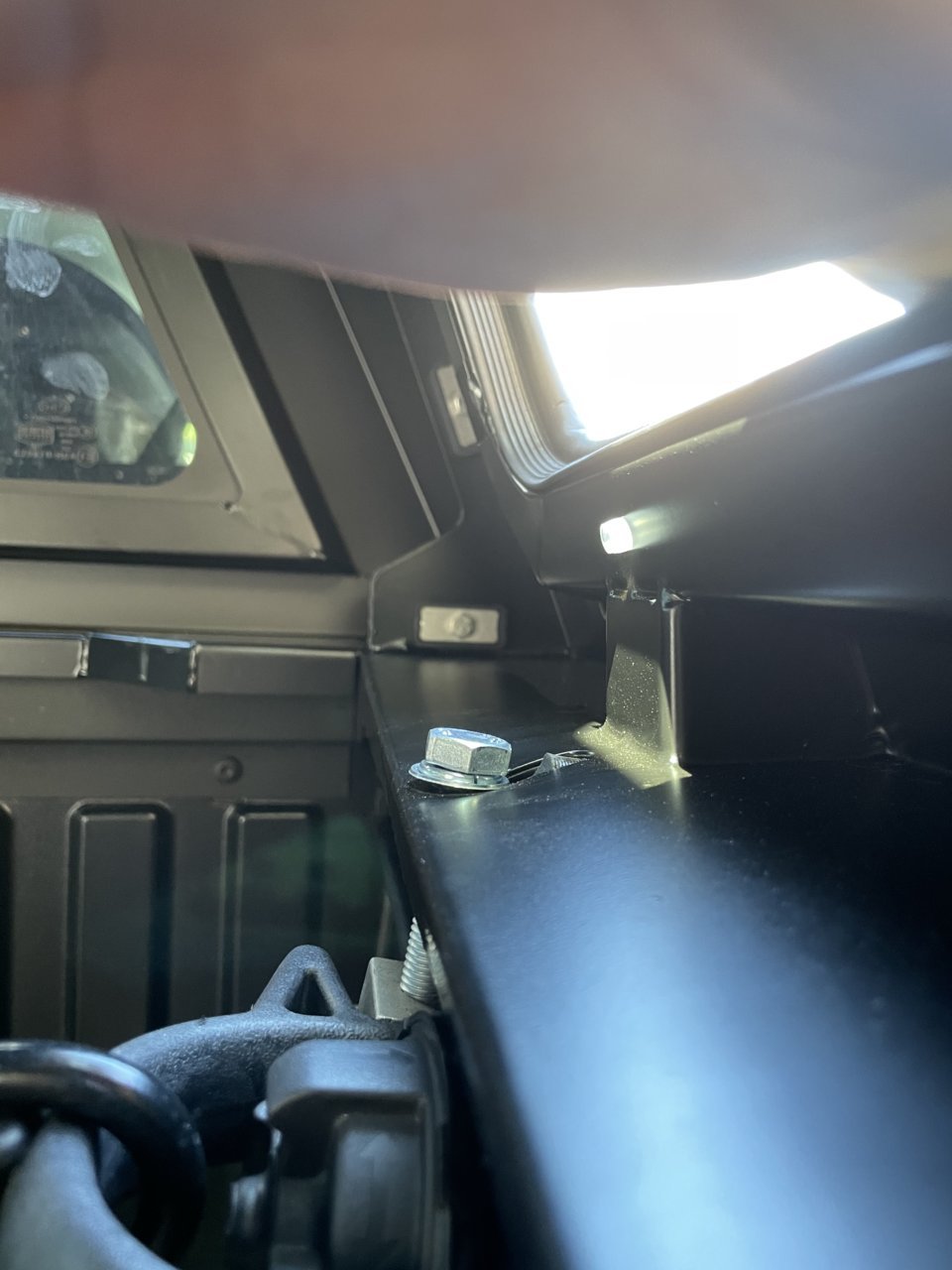

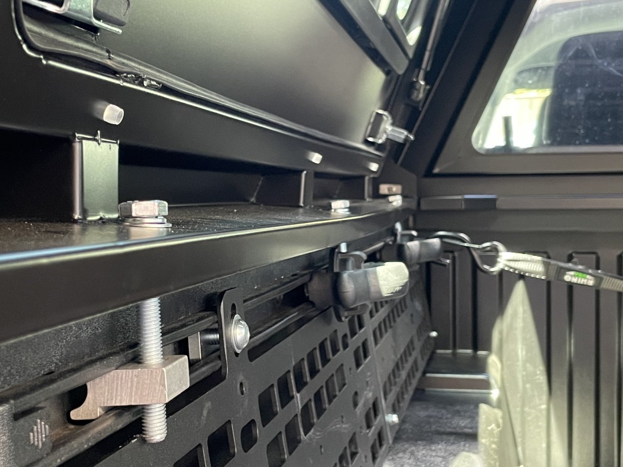

    Did you get this figured out? Mine does not look like that. I’d move that bed rail attachment point out of the way first.
    Look at the last 2 pics in my album: https://imgur.com/a/CJAEGe8
    I can send more, but your’s looks weird to me.

    I should have taken a couple before I put the handles on, but now they don't quite clear. When the rack is installed you get very little room, probably 3/4" on each side between the door and the rack, but that's all you need really! I still plan on buying paracord or other slim handles for the toprack and moving the Prinsu handles to the cab rack.

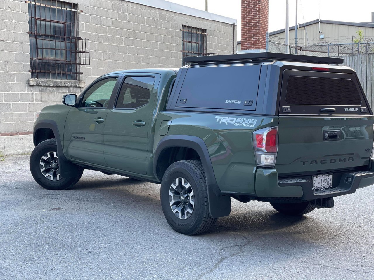

    Just got this bad boy intalled!!! OMGG ITS BEAUTIFUL!!!183464326_472330203853910_1873731930635473966_n.jpg 183828749_5524083854328506_7863272057936020916_n.jpg 183141688_1988338004655148_1576037897293992276_n.jpg
