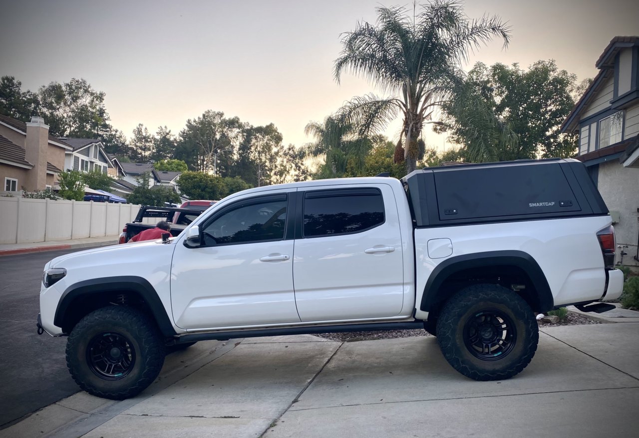

    Arrived, assembled and put on within 6 hours from delivery. Can you tell I’m that excited? LOL

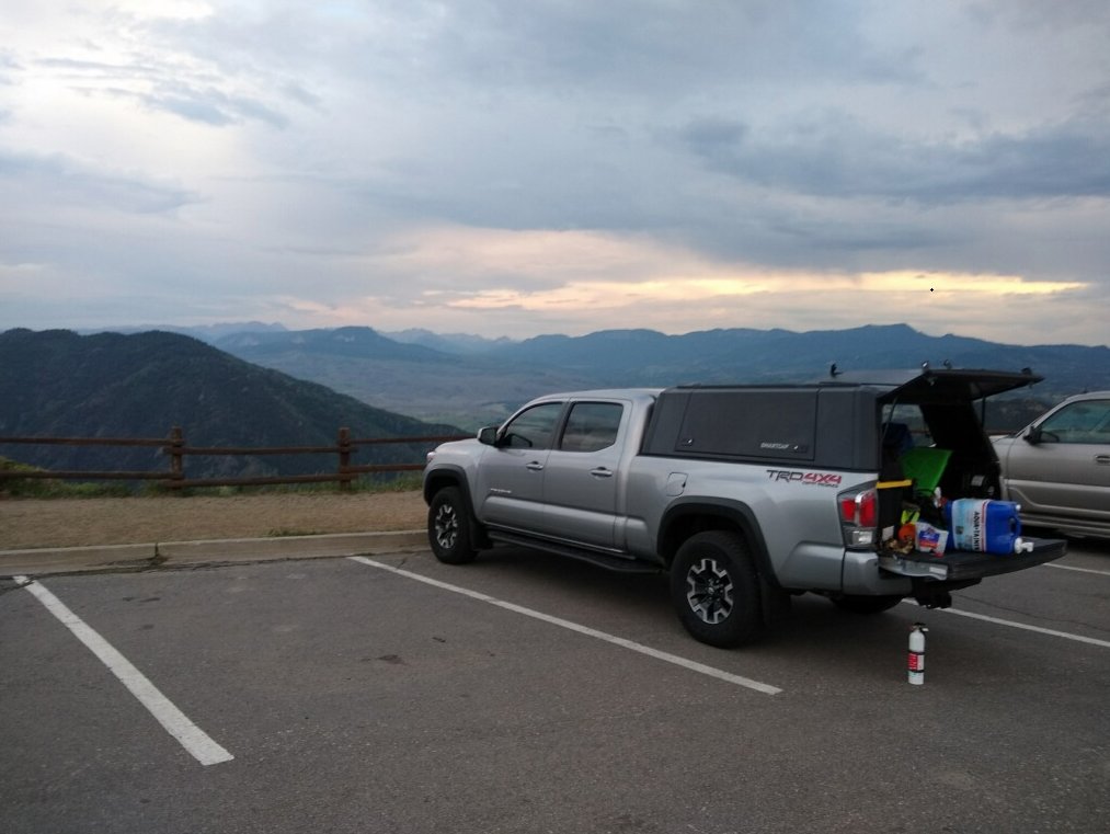

    Does anyone know the size of those threaded inserts on the inside of the cap? My son and truck are in Colorado and he was trying to rig up some netting and lights, hence the question.
    The fun thing about getting out on the road camping, you soon discover things to be done!

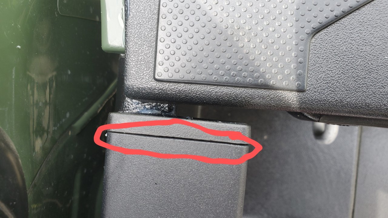

    So I believe I found the source of how water was getting in. I think water was getting in through the seam below.
    I lifted each corner of the cap using a bottle jack and placed some more butly tape along the full length of it.
    I did both sides and then spray the snot out of it with my hose. Doesn't appear to be letting any water in now. But we won't be getting at rain for a while, or so says the forecast.

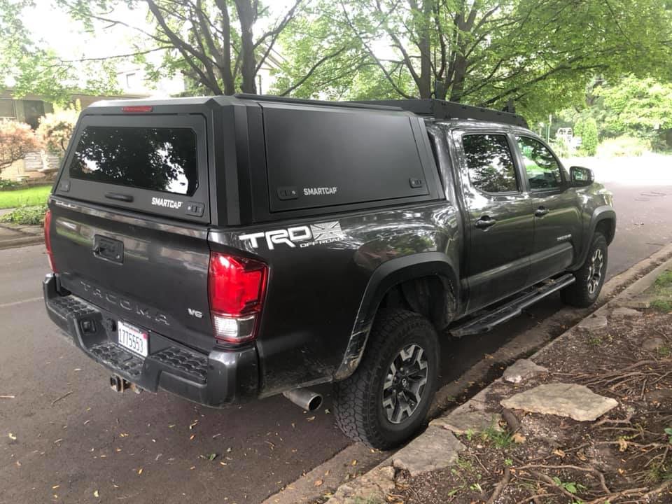

    226735318_10159483204159907_742994154916_2faf5bc4dc571c0e764b2ecc9ac06d842a6bbd9d.jpg
    Got mine installed today (Y)

    Is that stock tint on the back window?

    yes.

    It looks dark... must be the shadow. Either way, it looks NICE

    mine is tinted from the factory also appears very dark particularly when the cap is all sealed up.
