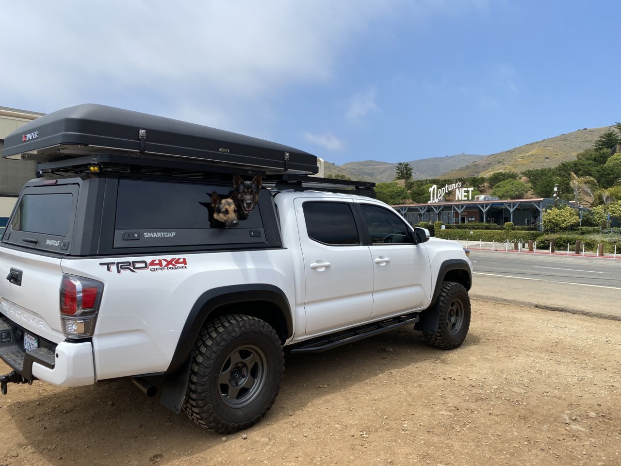

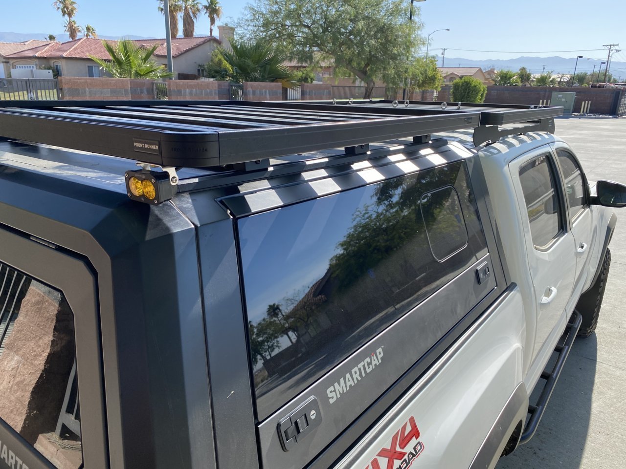

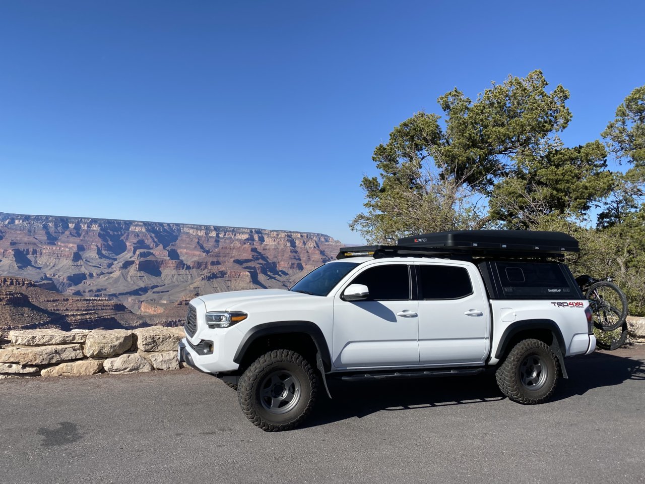

    Went with the front runner over the prinsu because the prinsu would not sit remotely close to even with the cab rack. Front runner is the only one I found that is really close but not even which allows the Ikamper to overhang on the cab rack but not rub against it while on the trails due to flexing. This setup allows me to take full advantage of the weight limit on the RSI.

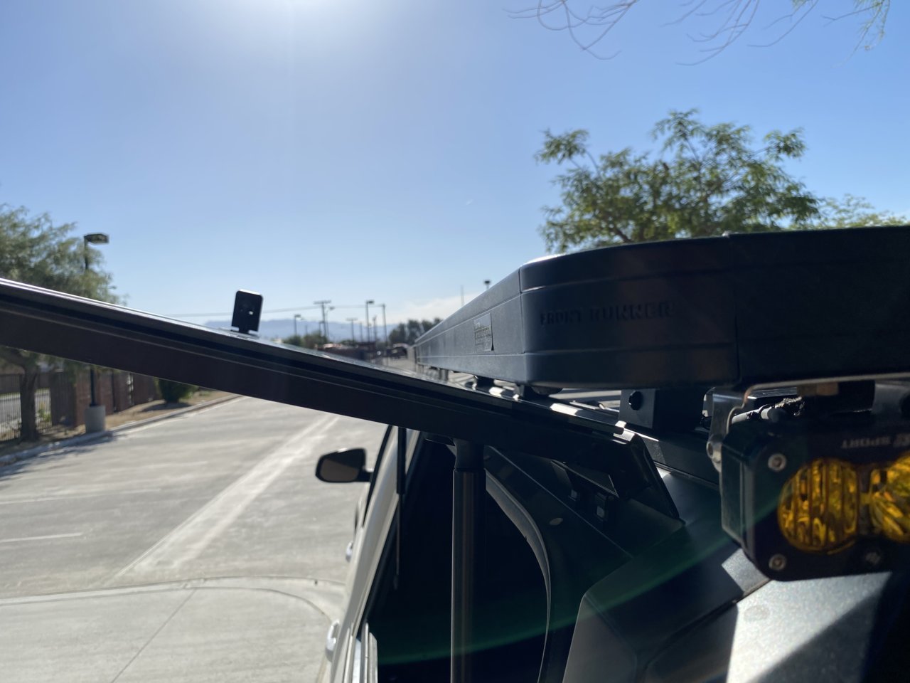

    Question, does anyone have experience resolving wind noise from the light bar on the front runner racks? F213FCA7-F95D-47AE-97D3-656BA96A1D92.jpgAD6D7361-35A7-42D9-9553-1867E893DB06.jpg81120C66-4B35-4253-9E88-D8A3DA9AB097.jpgF41AA29E-58C6-4009-A28F-9951FC536FB3.jpgB803A72C-A890-4D22-A69C-88D3E667D618.jpgF82D9F63-95C0-4CD0-8EEB-55A81D08B122.jpgAC872CF7-A8DF-4CF9-A0A0-281883C3356B.jpg

    I got the load bars but wasn’t happy with the setup with the Ikamper because of the weight limit on the bars. I almost ordered another set of load bars to double the capacity but I went with a full platform instead to distribute the weight better and to match the cab rack.

    Temporarily take some cardboard, and use painter's tape. Tape up a damn from the roof to the top of the front runner rack. Go for a test drive.
    My guess is the wind around the open light bar is creating the noise, so simple blue painter's tape and cardboard should tell us if that is the case.
    I expected wind noise from my solar panel, thinking I would need a "D" shaped leading edge. Zero noise with the flat edge and gap under the panel.
    update:
    Looked at their website, which shows a design change to the front panel. The light bar goes in front of the panel. https://www.frontrunneroutfitters.c...005-curr-40-lbar-ssport-roof-rack-kit-bp.html

    here you go:5F5F89C7-6959-49FD-AF31-1056E875E7F5.jpg
    I was thinking the same thing regarding where the noise is coming from, I’ll def try the tape with cardboard. I’ll keep updating this until the noise is resolved. The link you sent is for the Slimsport rack. Mine is different, I have the slimline 2. The lightbar mounting is complete different.

    I did this at first, the 2.0 brackets work but they are only rated at 220 lbs. If you don’t want to go full platform, you can run another set of load bars in the middle to give you more support.
    The alucab mounts won’t work with the front runner load bars because the bars don’t have side mount channels. You can only mount stuff from the top and bottom channel. The alucab bars work but it’s very low profile and the Ikamper 2.0 brackets won’t work because they’ll hit the roof of the cap. You can essentially get the alucab low profile bars mounted up but the tricky part will be mounting a tent to it since you’ll have very little clearance from the bars to the roof of the cap and basically no clearance to the roof rail mounting points once the tent is on.

  15. Jun 9, 2022 at 12:46 PM

    Heard of people using door edge trim on the fins.

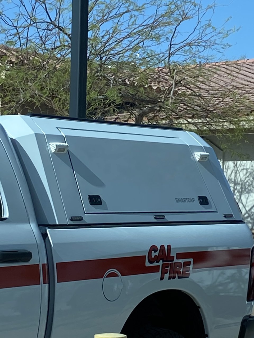

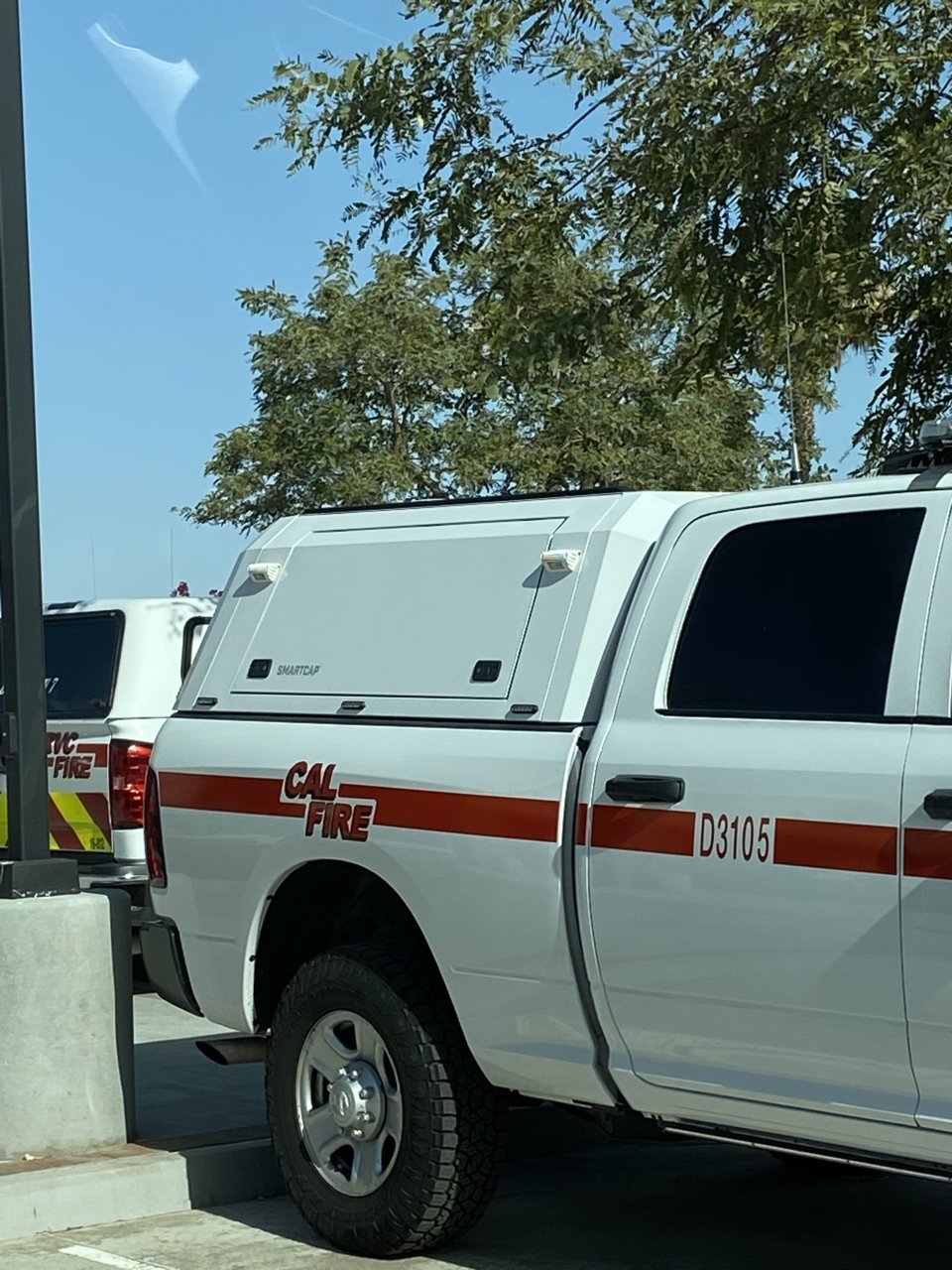

    Thought this was interesting, CAL FIRE moving into smart caps. 89BD0A7A-4D66-4BFB-9881-C0BC12553D23.jpgF5F389B7-21C0-4DC5-A5C7-841C8B4FDDB0.jpg991D9020-EBAC-4AEB-9A99-7C23B3EFCC1A.jpg
