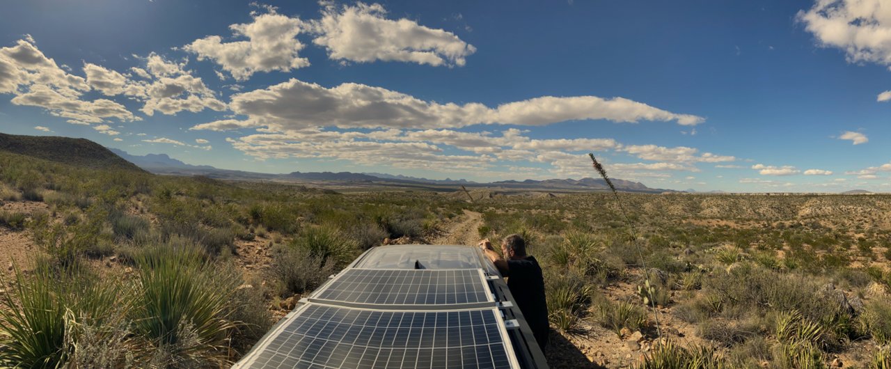

    I'll try to get a photo with those side panels up. They are "gull-wing," so you can not open side panels if RTT overlaps the sides.
    I had initially left my aluminum brackets long so it would have room for an awning mount. I interfered with the panels being open, so I trimmed them.
    I did not realize the top rails tapered toward the rear.
    I'll try to get up there with a tape measure to get the size of my solar panels so you have a sanity check. Another heat advisory day. 108F, 60% humidity,
    25 mph winds. Not getting much done, but I need to get out of Texas and into cooler weather to go camping.

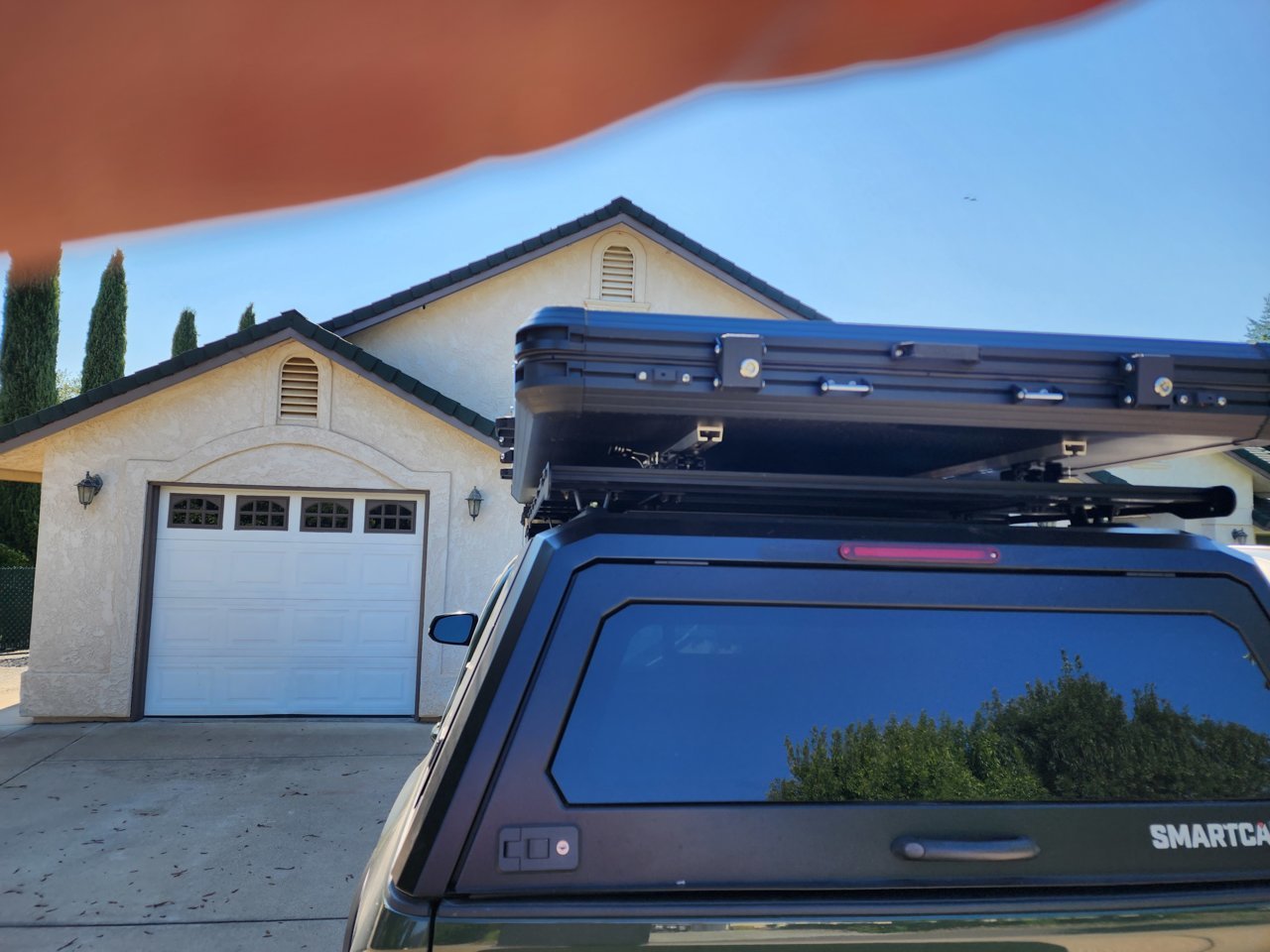

    I have a 52" tent mounted on a prinsu rack with front runner quick release mounts so it sits up a little higher with no touching of the sides when open. Here's a few pics for reference.

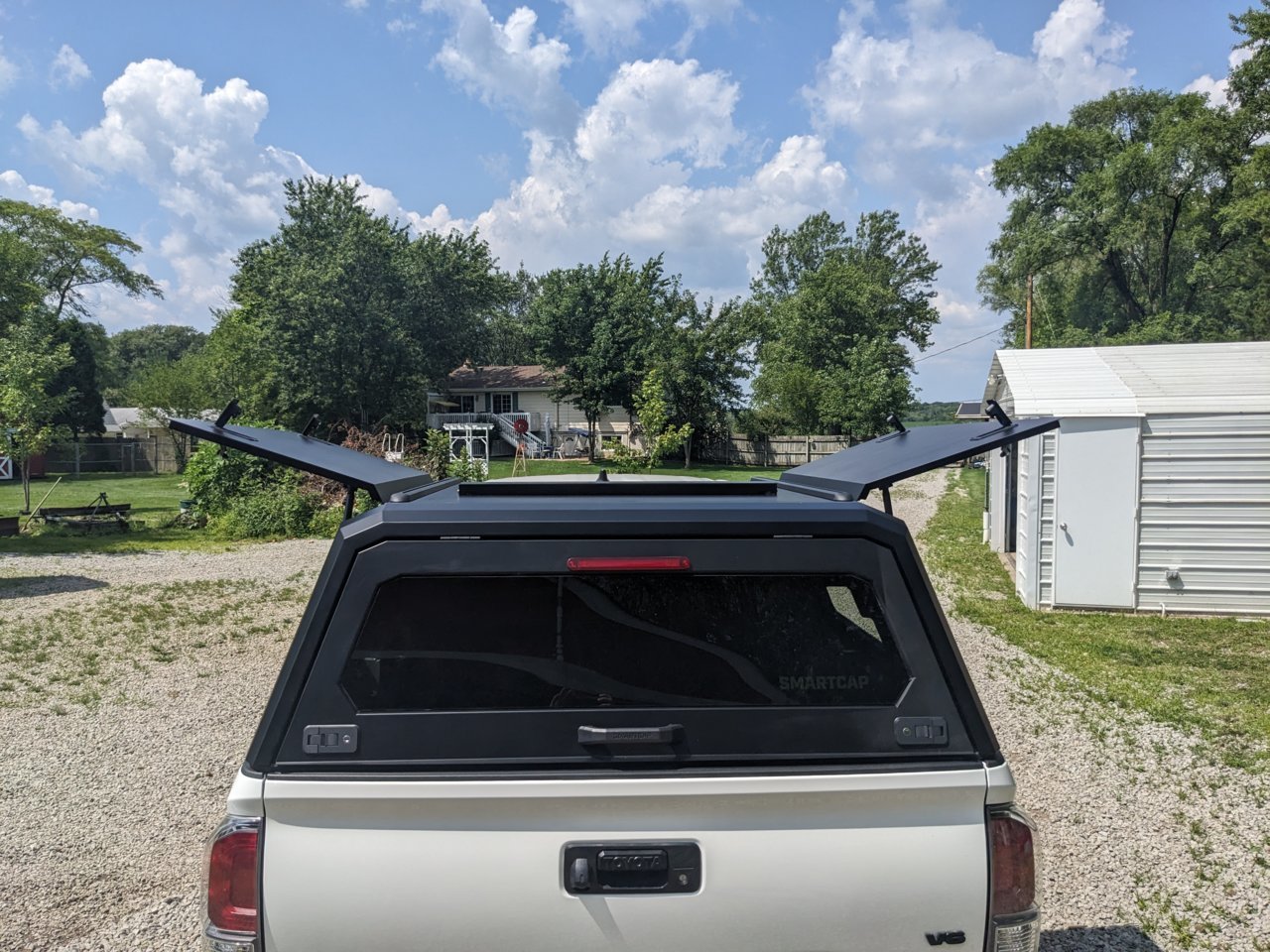

    Here is a photo with the gullwings open. I had them open to measure my roof rack crossbars so I could cut them to size. I JUST got 56 3/4". But that is at a height of about 3" rack towers. So depending on how low your tent sits to the roof tower mounts/rack, you may lose or gain a little bit. I believe I read 52" is the safe zone.

    Is there a way to adjust the doors so that it limits how much it opens?

    Not unless you add your own limit straps.

    I'm sure you could attach a strap or chain the the door. Nothing RSI has designed though.
