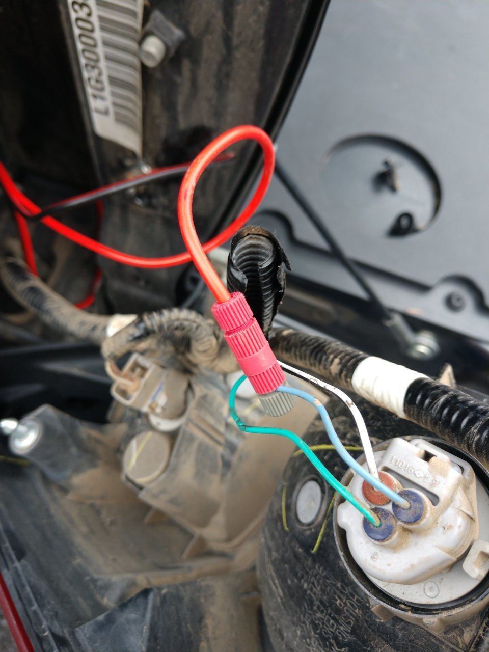

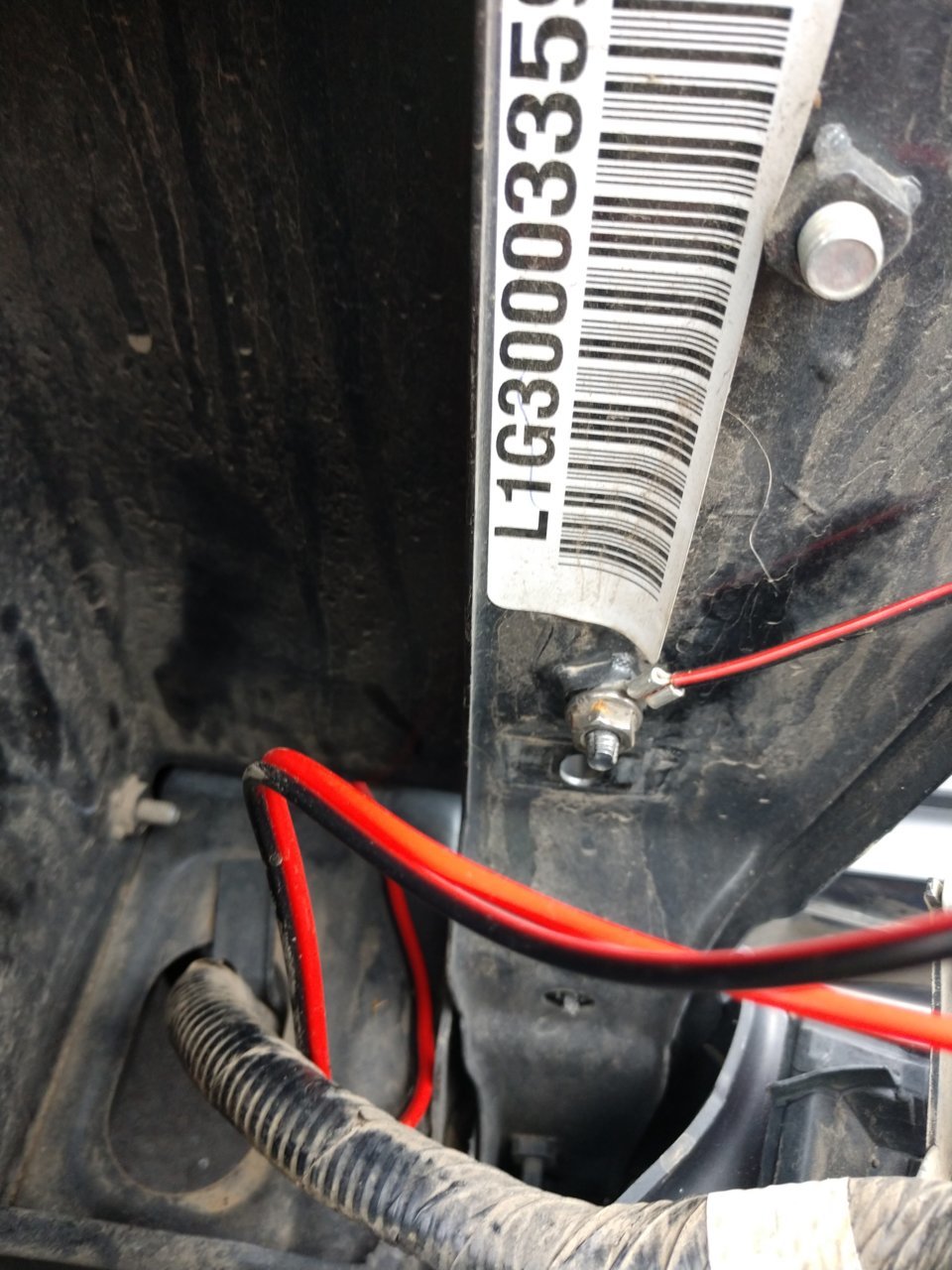

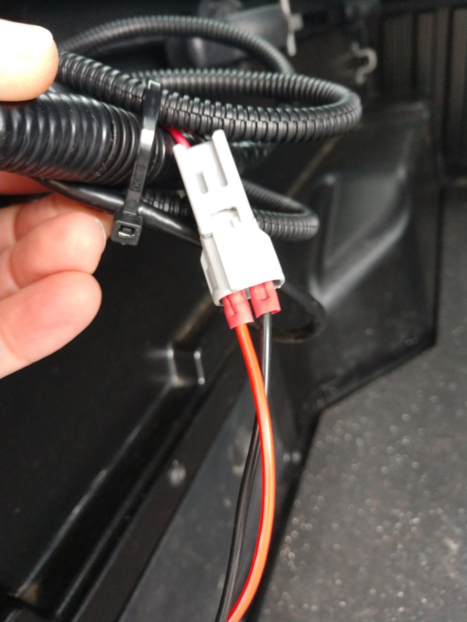

    This is what I did as quick fix until RSI supplies the harnesses.
    Plug neg/pos into what comes with the cap which has the fuse inline.
    Use a Posi-tap to tie into the blue wire on brake light bulb.
    Ground it.
    Hope this helps.

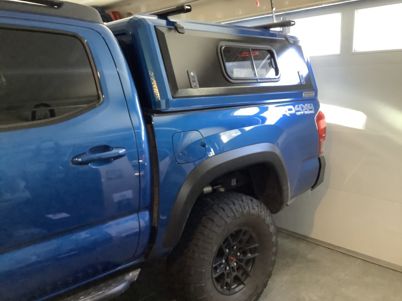

    So I have an awning I’d like to attach directly to the rails but haven’t been able to figure out what hardware to use. Would love some input.

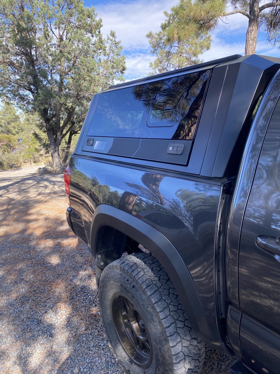

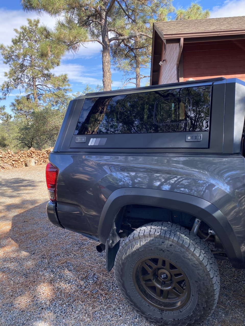

    To be clear, they don't "block" the RSI logo. I had to remove the vinyl sticker that said RSI on it first. The 2 larger black stickers toward the front of the cap were there from the manufacturer and I didn't remove them. The greyscale decals I put on the back are from @Tacovinyl - they're what he calls "4 wave" stickers on his website of the same name.
    I've been thinking of looking in to having one of the guys from this forum print a straight black RSI logo or do something more creative (and less annoying) than the red and white "RSI Smartcap", but the time and effort required just isn't there for me yet.

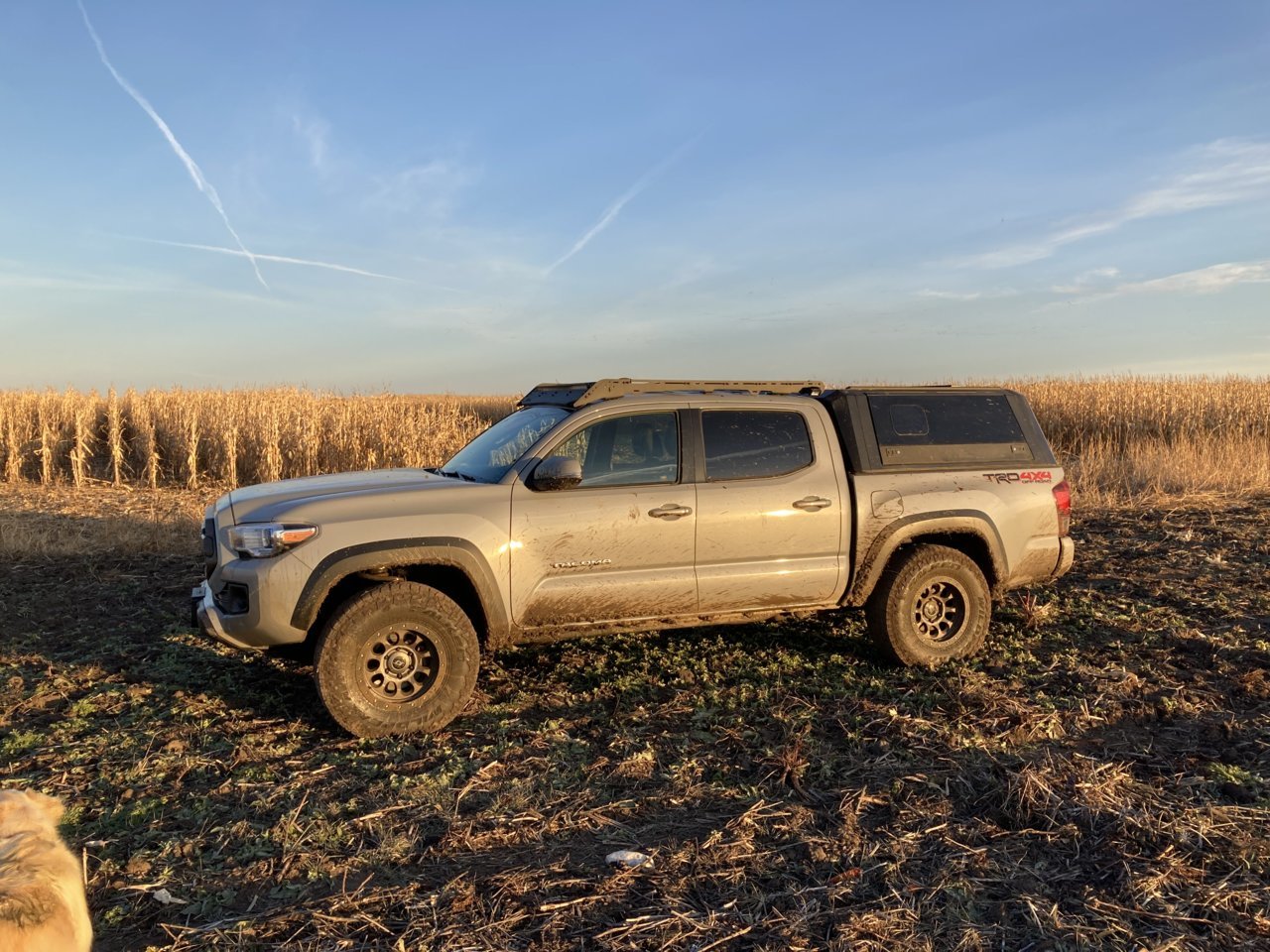

    Got a chance to test how dust-proof the RSI is over 4 days of pheasant hunting in SD - the topper did a really nice job, and being able to open the side panels to access the coolers was a huge benefit!

    Has anyone looked at limiting the windoors from opening so far? I have an awning I want to mount but want to keep it as long profile as possible but the windoors open above the rails
