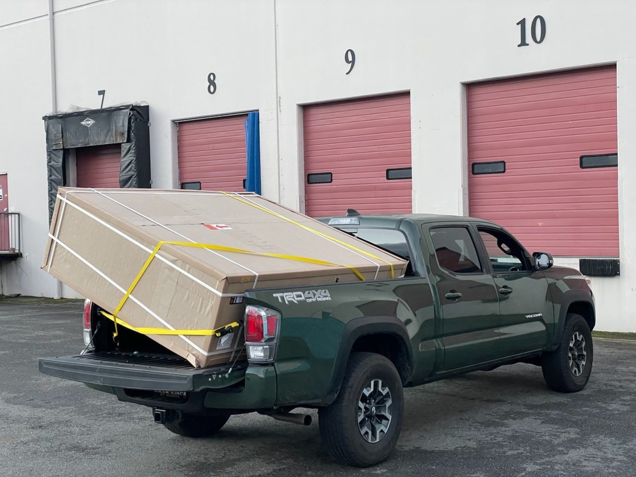

    Forgot to mention one more important downside of the Alu-Cab over the RSI SmartCap -- the fact that it doesn't come apart and is welded. I mean, I'm not sure how to the leak-proofing in RSI works, but on the flip side, there are very few leaks in the Alu-Cab.
    But yeah, transporting or placing the Alu-Cab isn't very easy. This is what it looked like in its box:

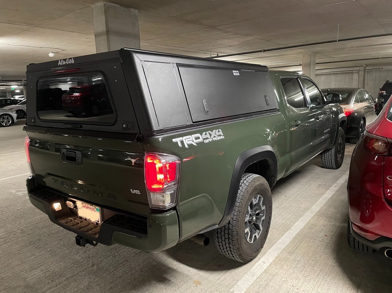

    green long bed ftw! (there actually aren't that many pics of long beds w Alu-Cabs that i've seen.) and a UT alum, no less.:headbang:
    yeah, the various window options are what kept me looking at RSI/RLD, as much as i like the Alu. i suppose if i wanted to wait for a special order from SA....

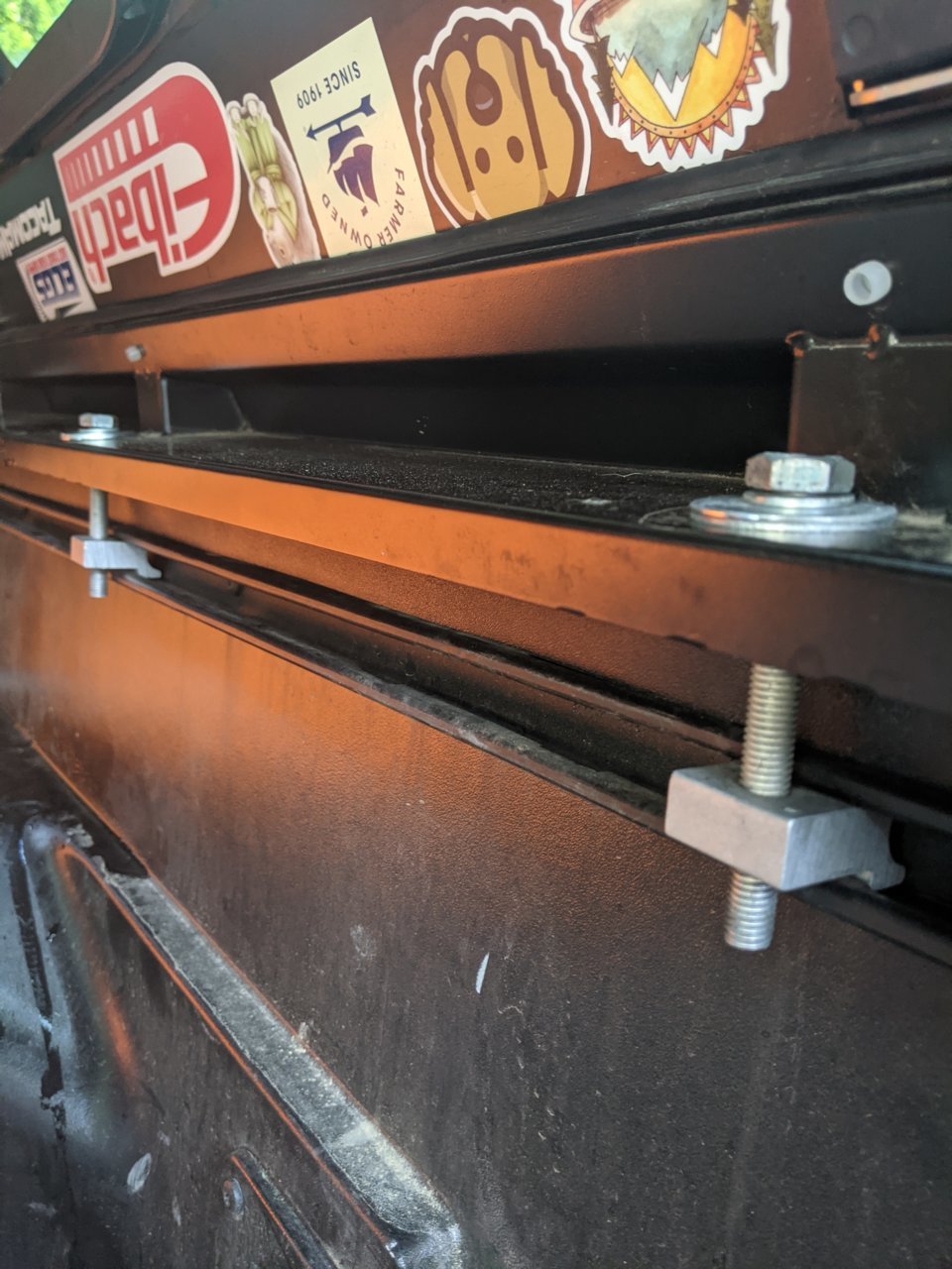

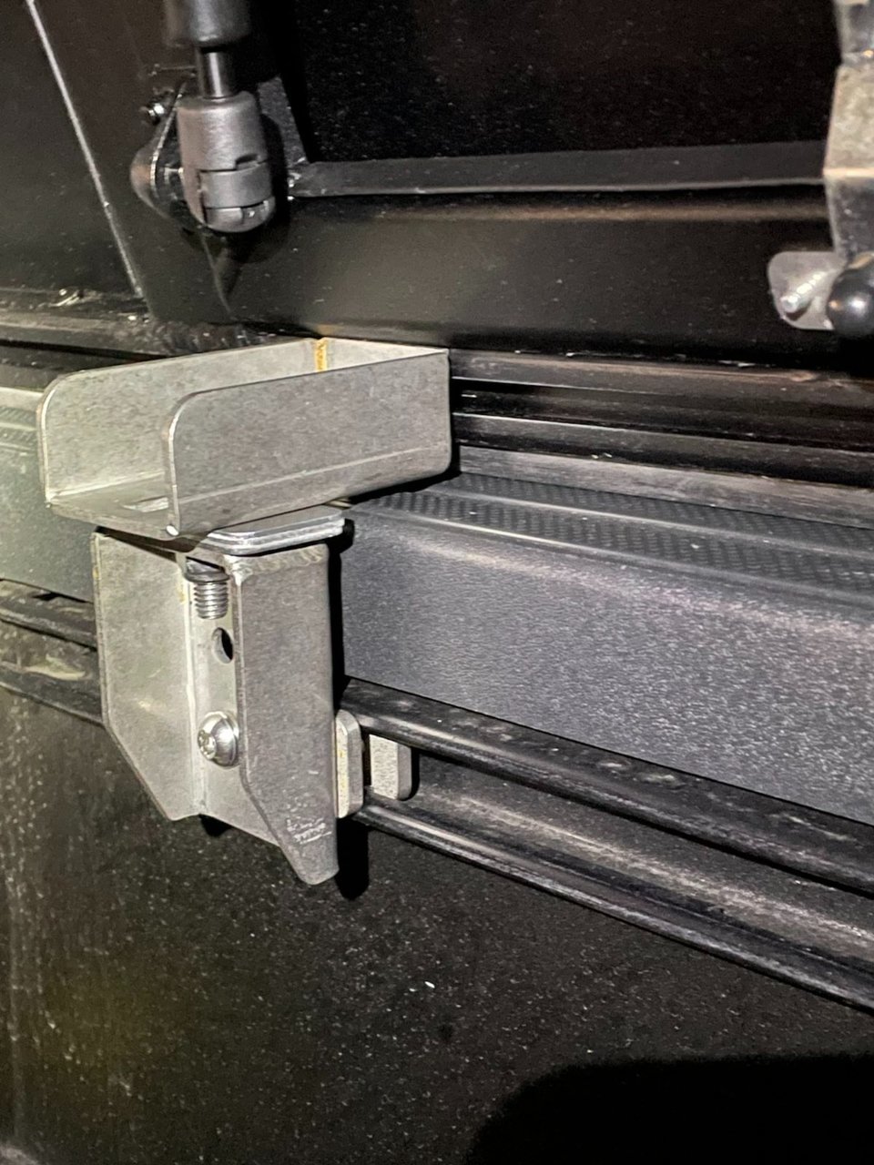

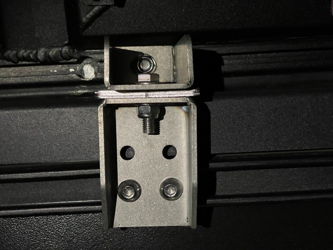

    I helped a buddy install an alucab and thought the mounting brackets were overly complicated. Below are the brackets for my RSI

    One more point on the Alu-Cab: Pay heed to the note that says "Mounting bolts must be regularly checked". I found that one of my mounting bolts was basically loose to the point of being screwable with my fingers. Tightened them with a 1.5ft breaker bar. If anyone knows a torque spec on the mounting bolts, I am all ears.
    Granted, I remember now that I had only used a short ratchet on them, and therefore the torque was not great. But even as yet. The mounting video on YouTube from TinyRigCo recommends using a thread tamper indicator paint (e.g. https://www.amazon.com/gp/product/B07Q84FX6K/) so that you can easily spot loose bolts. I think this is a good idea.

    I'm curious, what prevents lateral movement along the length of the vehicle with this mounting system? In other words, what prevents the RSI from slipping back and forth upon braking / acceleration?

    i have no idea what the torque spec is for those bolts, but i really don't think it wants a breaker bar's worth. :anonymous:

    The bolts are torqued to spec and then the friction between the rubber bulb seal and the bed caps keeps it from sliding.
