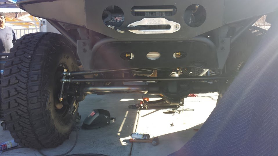

    So what's the deal with high steer arms and ackerman. Doesn't look like the arms you used account for that. Any thoughts?
    If it doesn't matter I'll save a boat load of cash and buy 4wheelsupply arms.

    Also maybe this is stupid and I could probably find the answer elsewhere but since you're here... are those just standard misalignment spacers on your steering linkages? High misalignment not needed (for draglink)?

    The arms are from Currie Enterprises and come with the axle complete. They have been running this setup for years with great success on the Rock Jocks and so I'm not one to mess with success. Been using the same setup on mine for over eight years now.

    Yes, those are standard misalignment spacers. Just copied what I had on my truck which has been working perfect for over eight years.

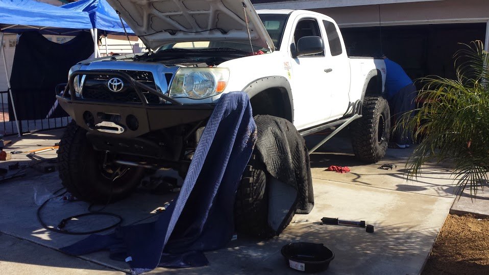

    For sure it was very interesting hanging out with you guys. Thanks for the invite wyatt. I never realized how much fab work goes into making these truck sas geezes.
    I need to sell my organs to jump on Beast makeover. There was some much :drool: yesterday.

    Took some pictures yesterday.
