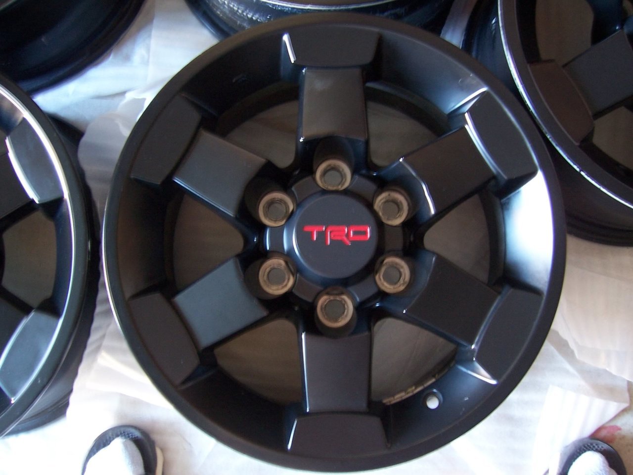

    Just bought a set of FJ trail teams and need to know which lug nuts I need. The dealership sold me acorns as that is what the computer said I needed but it appears they should be the shank type with a washer. Any thoughts?

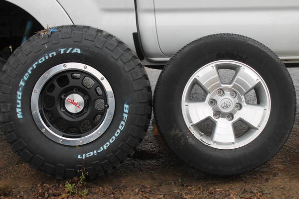

    I settled on these cheapos from pep buys but I wanted the black mcgards from summit and may upgrade eventually. Spline drive because of the smaller hole for lug nuts. This was for the beadlocks btw.

    The TRD Beadlock wheel ^^^ uses acorn style.
    ^^ the FJ TT requires OEM shank style lugs.
