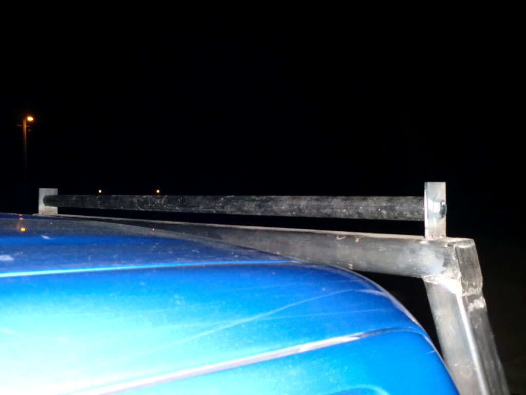

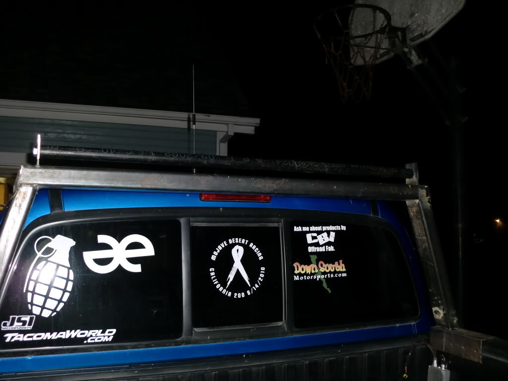

    Hey all. I have redesigned my bed rack. It follows the cab lines and sits at roof level. It will have a light bar up top as an option. There will also be a paired set option for those wanting a full rack. It bolts to the bed rail system using 3 1/2" bolts on each side. The weight is transferred to the bed sides. The tubing is all 2x3, .120 wall rectangle tube. Let me know what y'all think. I will have more images later this week.
    UPDATE 3/8/2011
    Light bar installed and capped ends. The corners on the light bar tabs will be ground off at an angle for those who are wondering.
    I will get some better pictures on thursday in the light.

    I think two vertical bars would look good. Looks good as is though.

    Edit: Image shack sucks:
    I was thinking something like this. More of a headache rack I guess. I think it rounds out the look personally but as your product, certainly go with what you feel.
    Also it's much more work but a thought might be to notch your tube at the top and plate it so that the third brake light is visible. Again, just a thought.

    I was actually thinking about notching and plating for the brake light but one of the main purposes of this would be to be able to run a roof top tent if I wanted to. So I want it to support as much weight as possible.

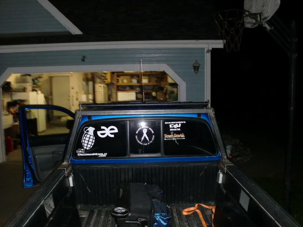

    Please excuse the messy wiring. Lol

    holy freaking lights!
    looking good btw!
    did you ever think about making the top bar be able to fold back? or put a rack around the lights. like the demello prototype?
