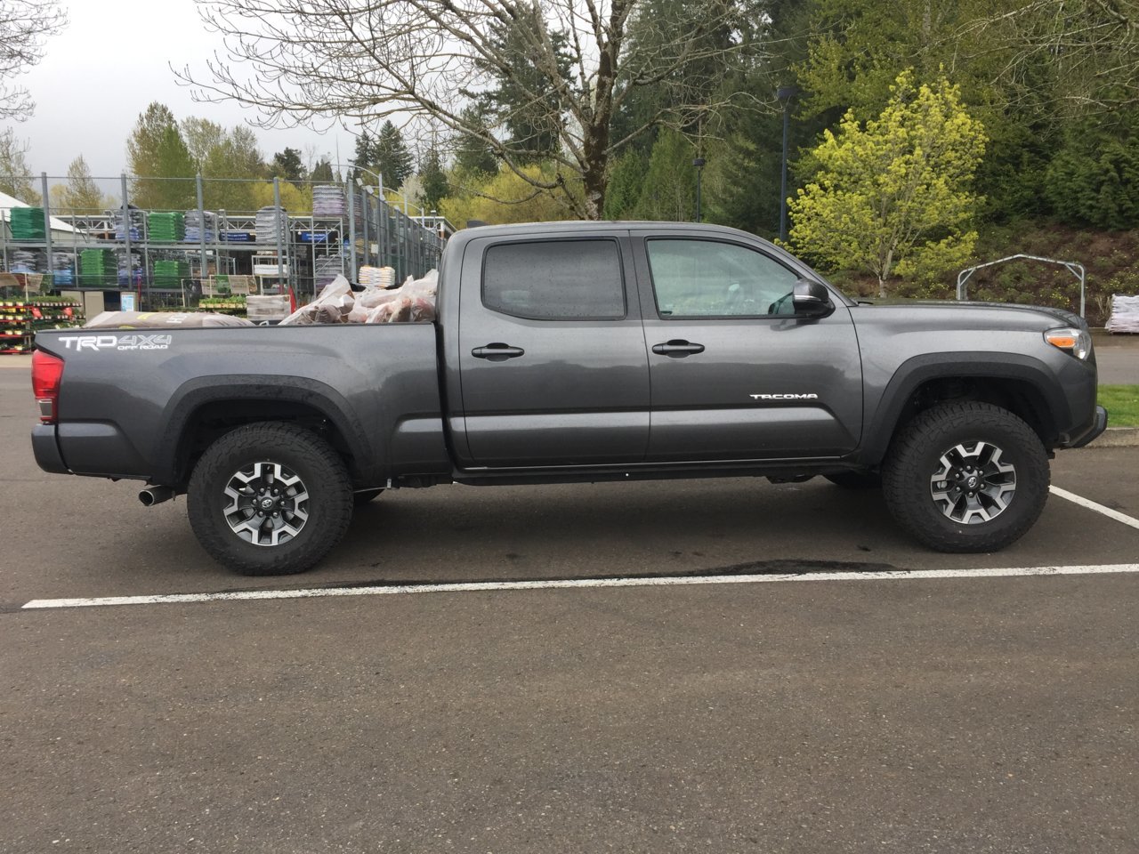

    How much does the RTT weigh?
    I calculated the rear end drop on my truck by placing large ice chests and 5 gallon buckets in the bed and filling them with water.
    The drop was about 1/2 (.5) inch for every 200 pounds added.
    I think it was at about 660 pounds and the drop was about 1 3/4 inches.

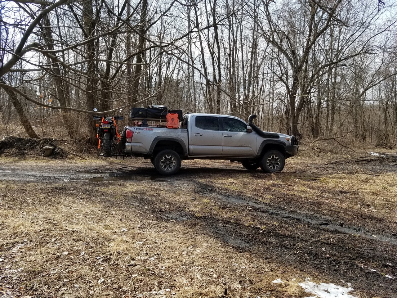

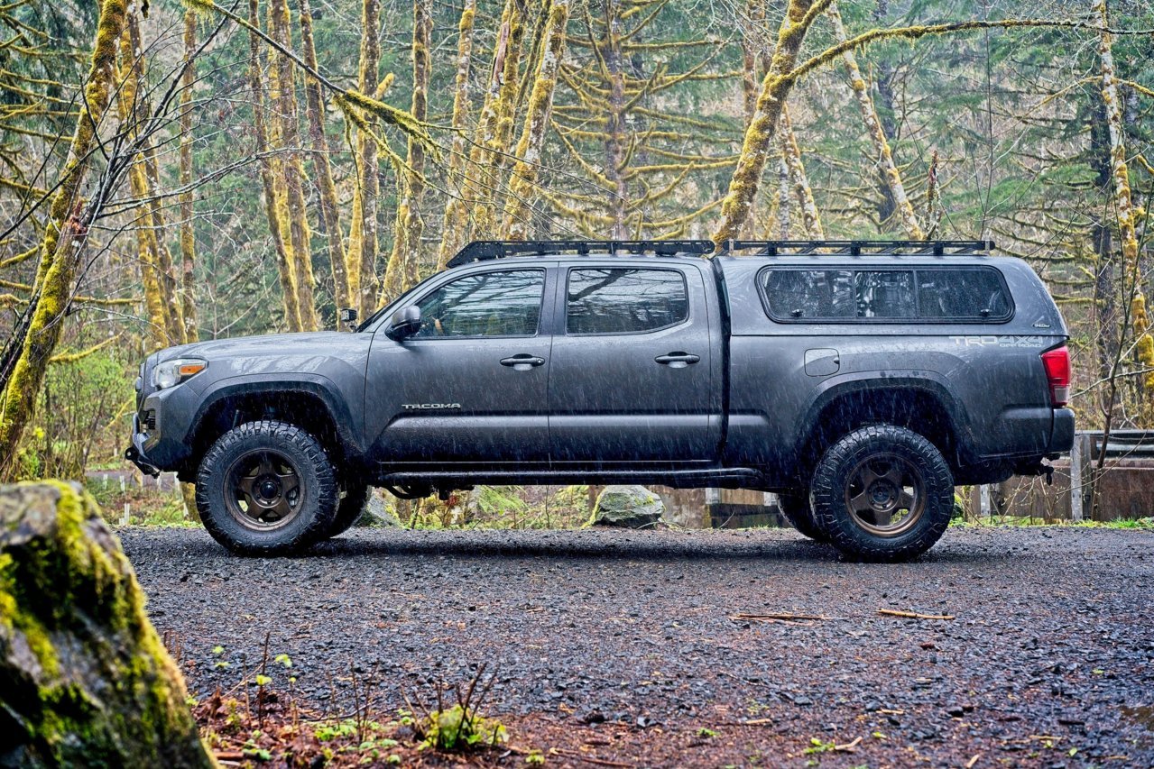

    Yes, get the Dakar HD for rake which will compensate for the RTT and gear. Here is a pic of my truck on Kings without RTT:

    That picture alone cinched it! My back end isnt as heavy even though I have a cap and a cabrack with a rooftop RTT, and sometimes put a Honda Trail 90 in back with a single Dakar AAL. Your rig looks like it handles the wxtra rear weight very well.

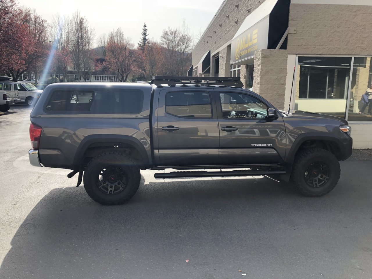

    This is on stock rear leafs with canopy AND decked system...
    After a wheelers 3 leaf AAL ... cheap temporary fix until I decide on full suspension but I am finding Dakar’s are the way to go.

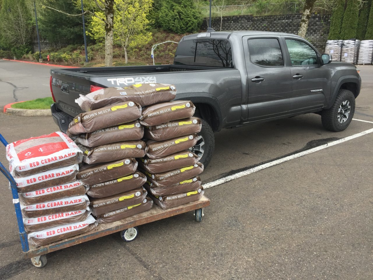

    Yesterday: 894 pounds of mulch and bark dust in the bed. Gas tank close to empty. Rear end drop 2 inches.
