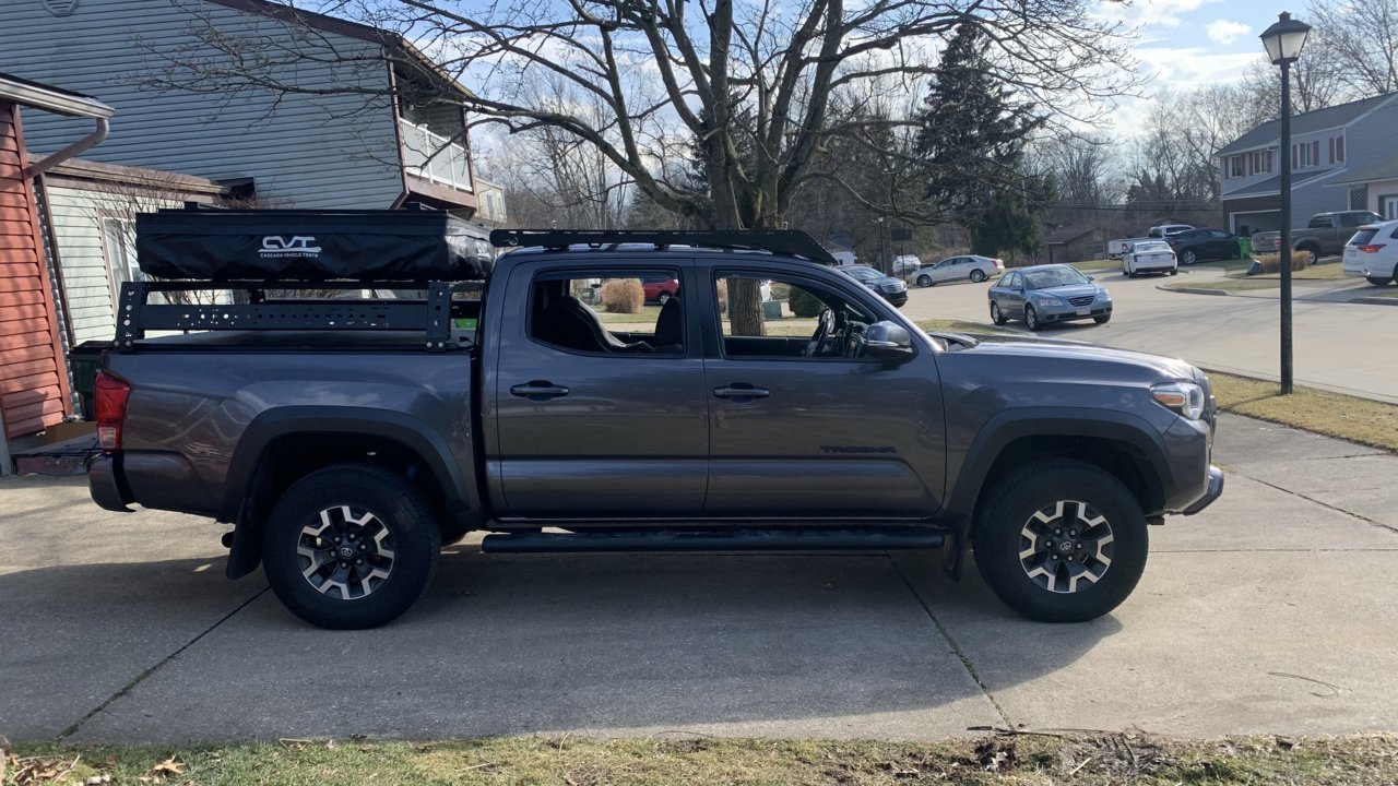

    2016 Toyota Tacoma, Off Road, 6 speed manual
    KB voodoo bed rack, CVT Mt Shasta RTT. No bed stiffness. Stock suspension. Stock wheels and tires. No problems.
    Cliff69[OP] likes this.

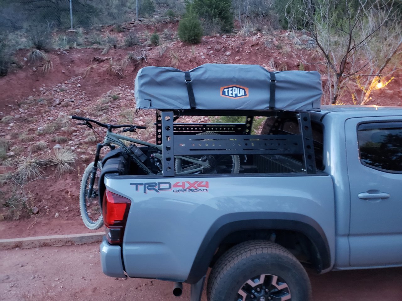

    2019 TRD OR DCSB cement
  8. Feb 14, 2023 at 2:56 PM

    Nice Bike man! appreciate it
    mrtonyd[QUOTED] likes this.
