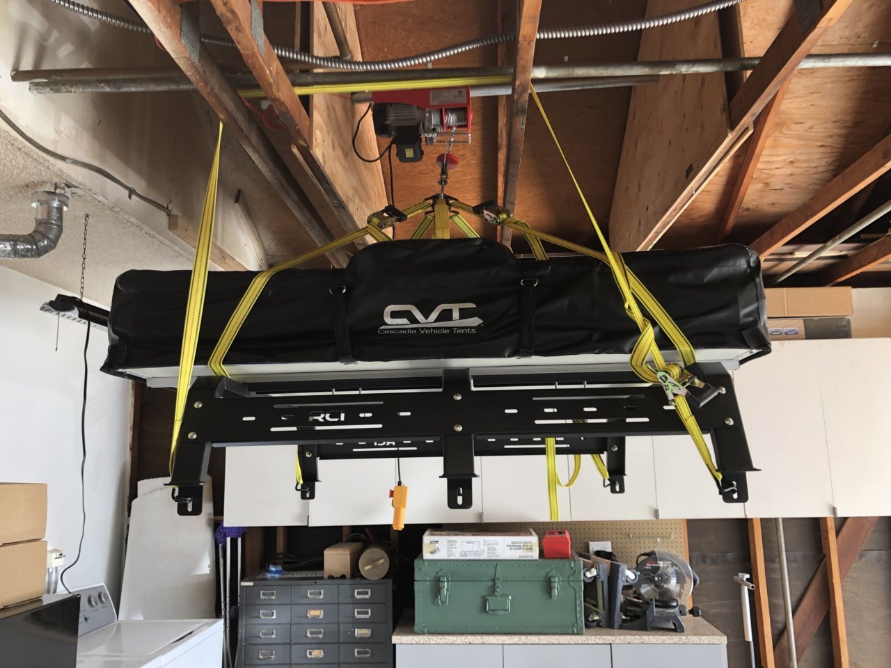

    Anybody have a good hanging solution for rtt winter storage? Looking for more of a pulley system that will give mechanical advantage instead of a winch since headroom will be minimal.

    Check out Harken Hoister. They aren't cheap, but the kit includes all you need save a couple lengths of 2x6.

    Picked up a hoist off of Amazon along with some heavy duty straps. Used an extra strap on each side as an added safety measure, however, probably isn’t needed because the hoist is rated at 880 pounds. You can get the same hoist from Harbor Frieght. You’ll need to be able to hang the hoist, but it was fairly simple to fab up. Now I back the truck in, click a button and lower it down on the truck with ease. Can do it myself in less than 5 minutes.1357DC9C-FF64-40E0-A018-B20BBF2769BA.jpg

    What hoist is that from harbor freight?

    This one.
