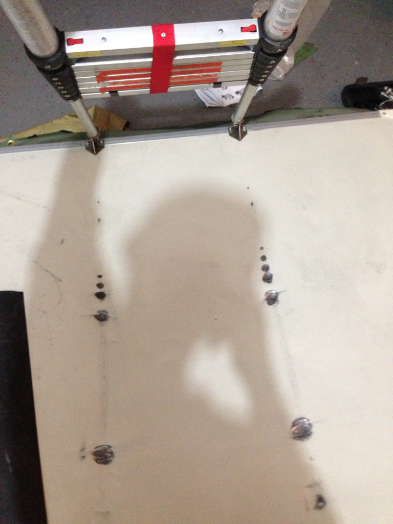

    So I got a little bit of work done on the RTT today
    Added these vacuum line covers to the bottom of the RTT mounting bolts
    And one of them switched out and used eye bolts and a Bolt pad lock (keyed to the truck key). I had to rotate one of the eye bolts because the Bolt pad locks only come in 2" shackle lengths.

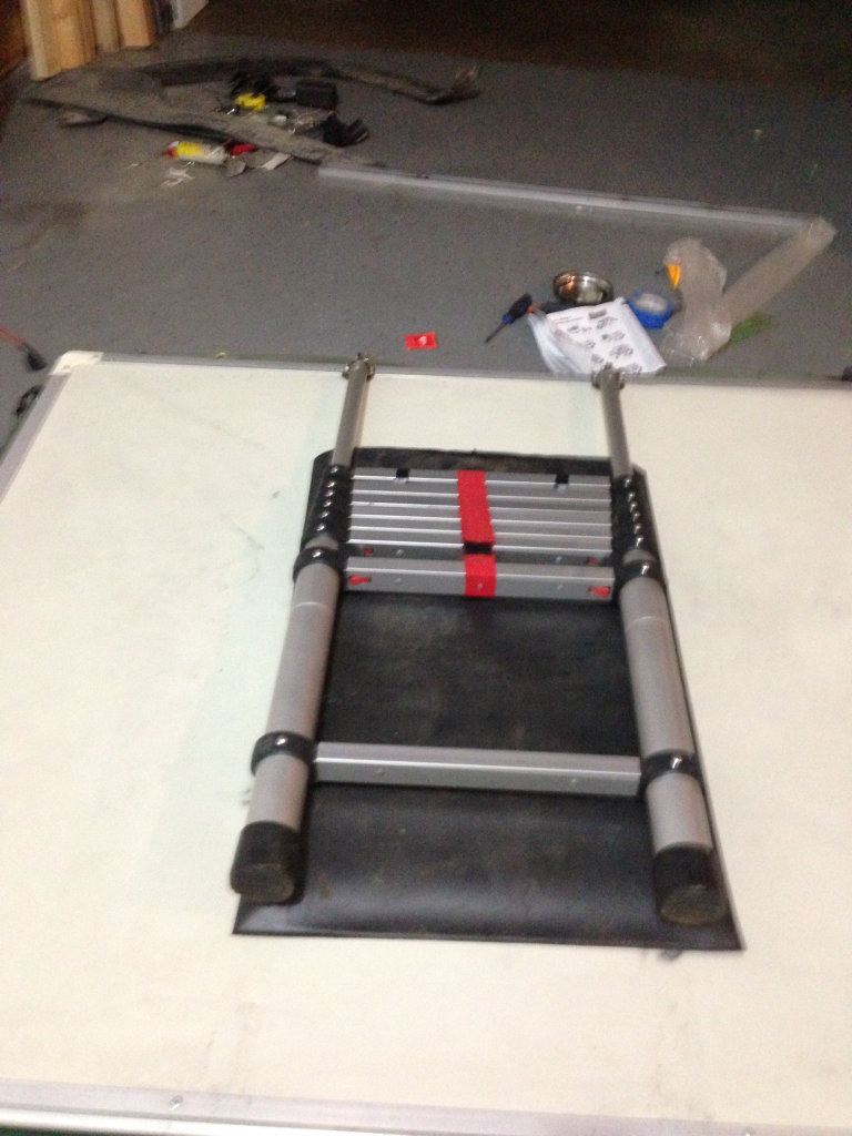

    Added some protection to the RTT cover when the ladder is extended
    before:
    after:
    another shot

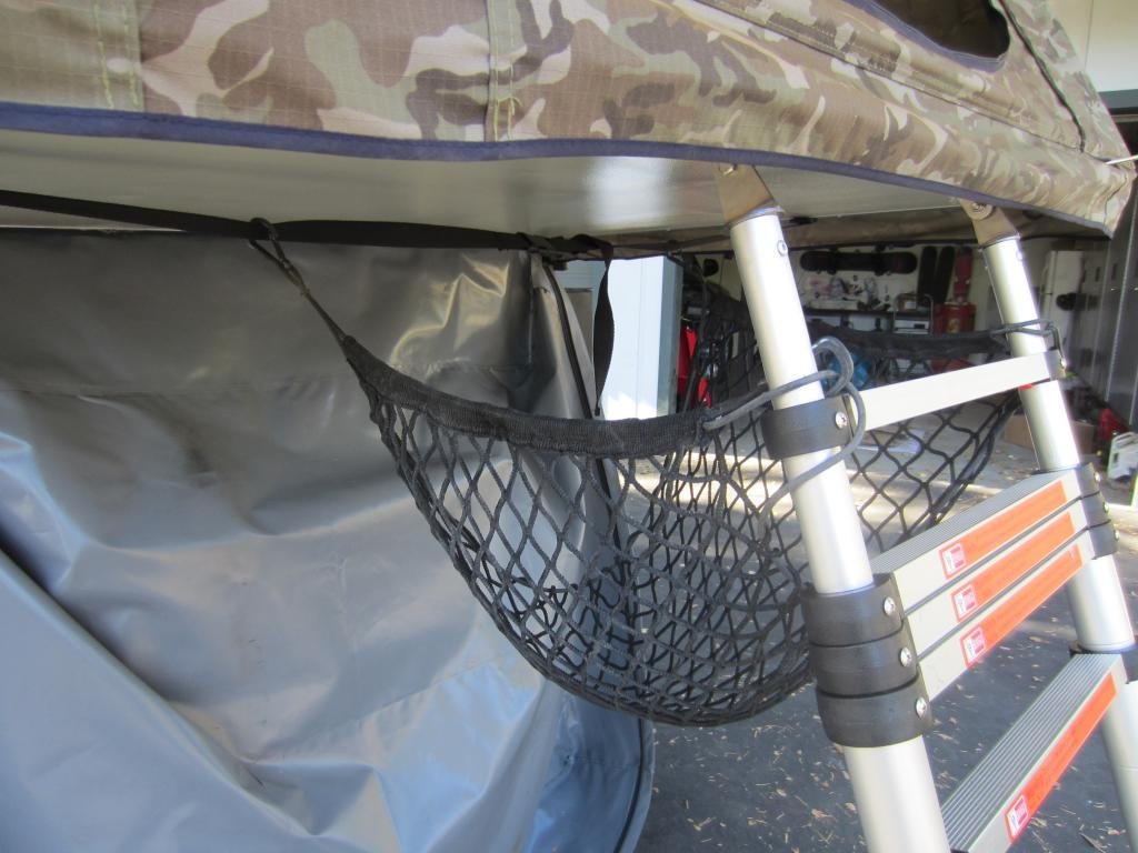

    shoe holder

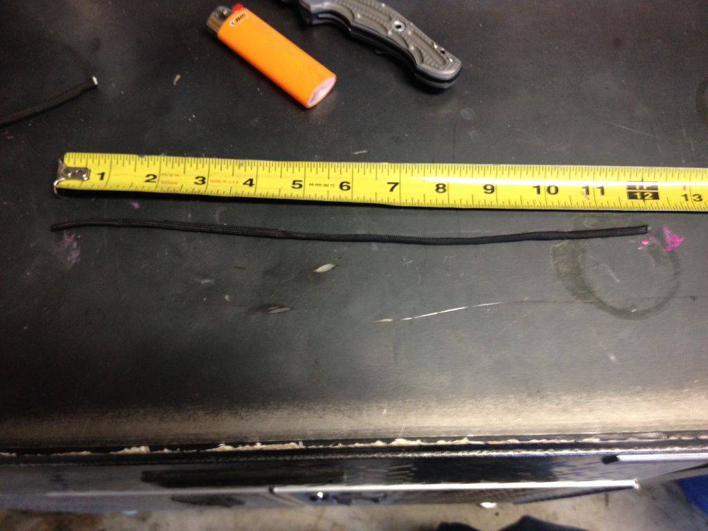

    Also I found I was always hanging misc stuff off the the rainfly rods, and they aren't exactly in the right spot. So I took some 550 cord and tied it into a single knot. The knot fits perfectly inside the aluminum tracks used for the annex.
    12" of 550 cord

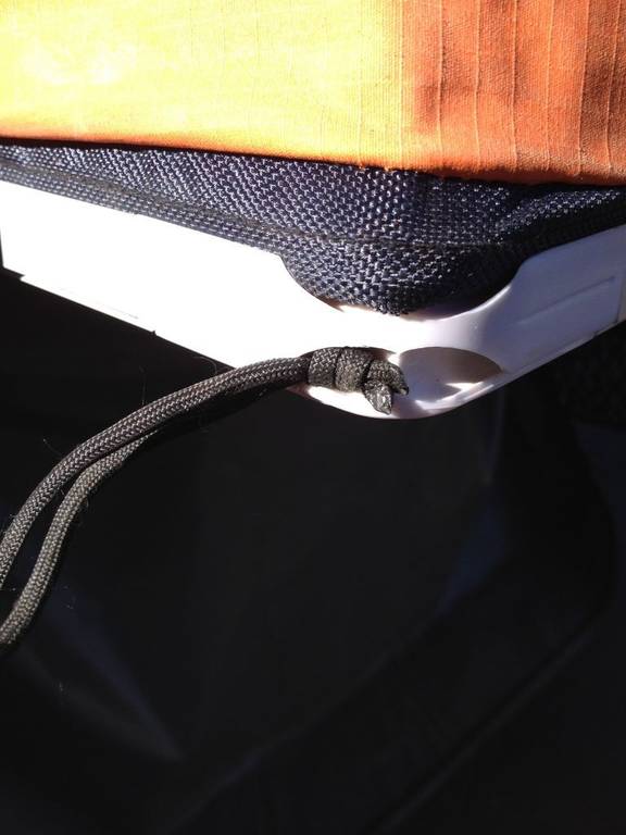

    Tied into a knot
    Got the knot as tight as I could with the help of a vice
    Slide it into the annex channel and give it a little tug
    Slide them anywhere down the channel you need to hang something. No need to remove them when folding the tent up. They are out of the way and don't interfere with the cover.
