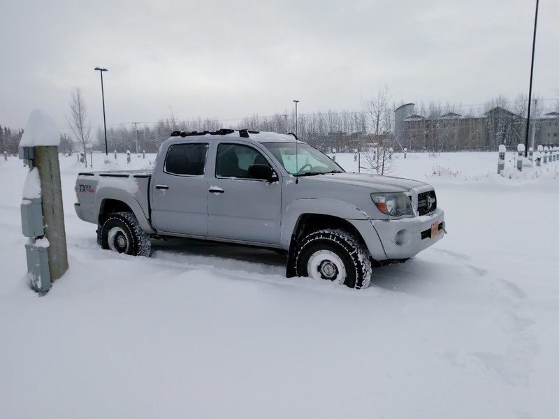

    ^ Anyone have any photos of the Front Runner Load Bar Kit mounted? I'm leaning towards it but I'd like to see a couple photos if anyone has them.

    Not the best picture but it's one of the only ones I have without stuff up there.

    Thanks! What do you think of it? I got my tacoma a couple weeks ago and I've been going nuts on trying to figure out a roof rack configuration. I didn't realize until today that this one existed. I like the 'permanent' install of the factory but it just seems pretty weak. I don't need to go all out overland or anything so this looks like a happy medium and about the same price as tower/rail combos from yak, thule, etc.
    I'd mostly be using it for canoe/kayaks and occasionally a cargo basket.

    I'm very happy with it. It's much more solid than the factory rack and mounts to the same factory location. The bars are actually straight and flat unlike the factory bars.
