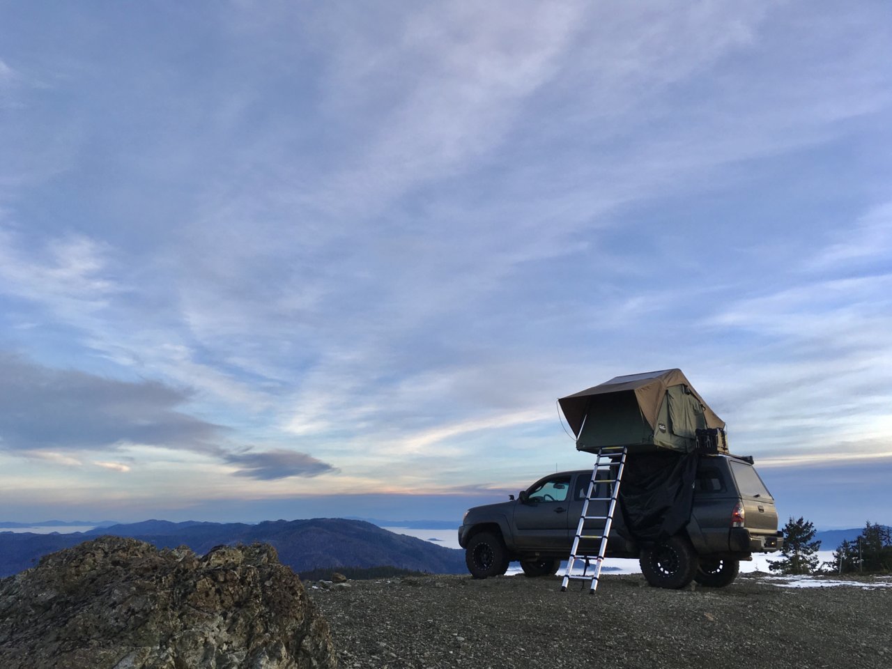

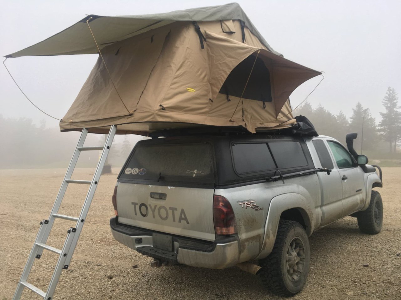

    Yup. Not worried about the shell as much as the bedsides. Stiffeners are a good investment.
    B72BF8FD-471C-40F9-A34B-BF78CF48F7AF.jpg 50E48016-95B5-4D36-BFD7-6DB706D7AF71.jpg

    Love your set up. Any issues?

    Thank you. No, it’s been great. I’m 5’9’, so it’s kind of a workout for me to get the tent zipped open and closed, but throw on a longer zipper pull and some rock sliders to stand on and it’s all good.
