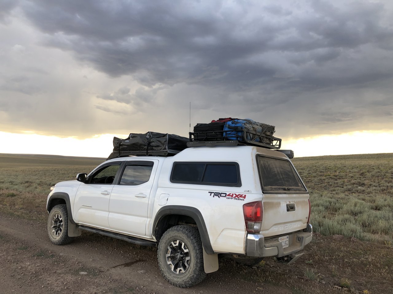

    Prinsu cabrack, as my ARE MX shell top is too uneven for an RTT, otherwise I would maybe put it back there:C7E6836B-98F4-426C-AE92-58EAB8867E15.jpg

    Looks great with this setup!
