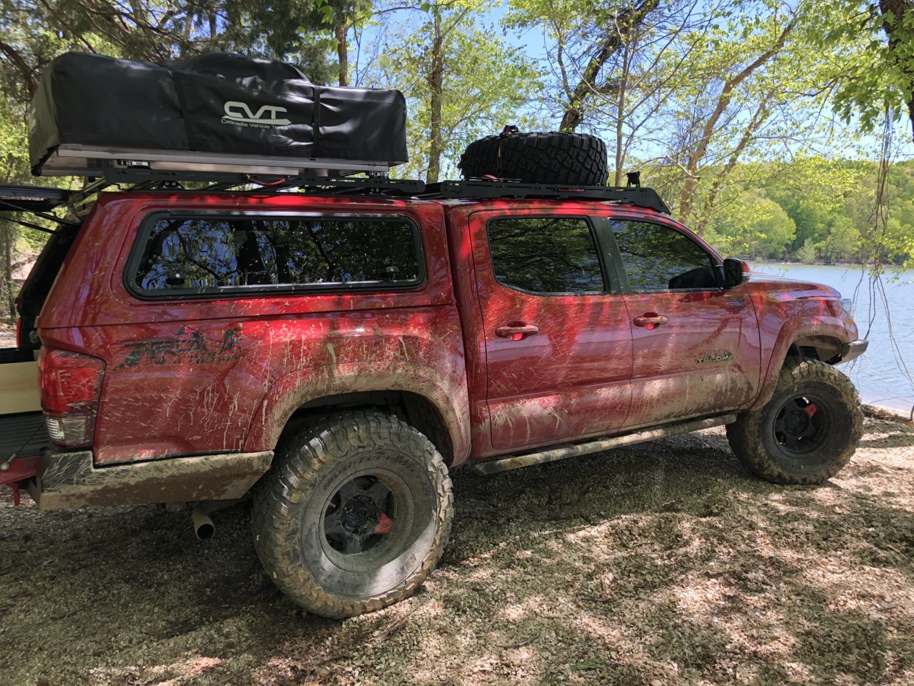

    I'm seeing a bunch of racks + RTTs in here....did y'all buy reinforced canopies?

    Some brands make “heavy duty” upgrades. That’s what I got

    I got a CVT Mt Rainier (~200#) on a long bed with a ARE Z series, no reinforcement. Have had no issues in the 2 years I have had it.

    My SnugTop Rebel has the sportsman package that reinforces the roof and its weight capacity. I've been thinking about adding bed stiffeners too. I had to upgrade the suspension to account for all the weight too.

    I don't doubt any of y'all that have done/are currently doing it in the least, but it's always been my understanding that a camper shell isn't near strong enough without the rails/reinforcement package to hold the weight of a RTT with people actually in it. I would love to be wrong; I have a basic Leer white long bed cap that I've been contemplating selling so I could run a bed rack and keep an RTT off the cab of the truck, but I'm always fearful it will cave while night while I'm up there with the wife lol

    Not sure where I heard it but somewhere told me around 200# dynamic. I have 3 sets of feet on the prinsu rack distributing the weight. I have taken the tent thousands of miles on and off-road with no problem. I always assumed the weight ratings are going to be a bit conservative, to avoid people looking for warranty work when they throw a ton of weight up there.

    I just ordered a Leer 100XR - dealer stated weight limits of 200 dynamic and 600 static (I've seen others state 700 static). Bed stiffeners have been recommended if you go with this combo. Have a lifetime structural warranty if you order new as well.

    I honestly think an occupied RTT is too much weight to put on a camper shell. I think my Leer is rated for a max of 250 lbs. and the weight of the Prinsu itself will eat into that limit.

    That's definitely one thing to consider when buying a shell. I ordered mine with the sportsman package so it's reinforced with a weight limit of 500 lbs.

    I have a Leer shell I picked up second hand, installed Prinsu rack, ~180lbs tent, have slept two adults (~300lbs) and three kids (~150lbs) on top without issue several times, also thousands of miles driven with just the tent itself. I don't believe I've ever heard of any horror stories of shells collapsing ever. But with some research I found that some manufacturers (A.R.E./LEER) generically say their static load shouldn't be above 200lbs evenly distributed, but come back to say that the shell can handle the weights of whatever aftermarket rack you may use is capable of holding. Which for Prinsu, 600lbs Static and 300lbs dynamic.
