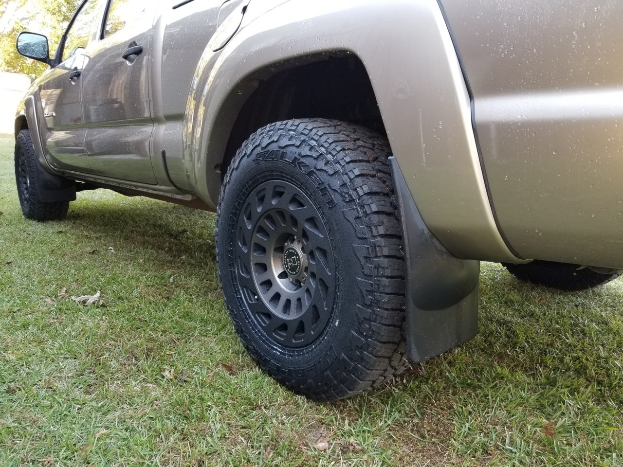

    Finally getting around to upgrade my wheels/tires. 2006 dclb 4wd. Lookin' at Black Rhino Madness 17x9 wheels +12mm offset with Faulken Wildpeak A/T3W 265/70R17. Will they rub? I'm stock suspension right now. Looking at getting them from Carid.com and they won't guarantee the fit. Thanks for any info or directions to another thread!!

    Thanks. I looked, searched, and looked more but couldn't find exactly what I was looking for. I did find a few tire comparison tools that were helpful. So I took that information and measured off of my current setup. Looks like it will fit my truck but will be close in one area. Worst case is I have to add some thin spacers I think. I'm going to pull the trigger on them today probably!

    Minor rub on mudflap when turning. Very minor trim to flaps and ok now.
    17x9 Black Rhino. 265/70R17 Faulken Wildpeaks.
