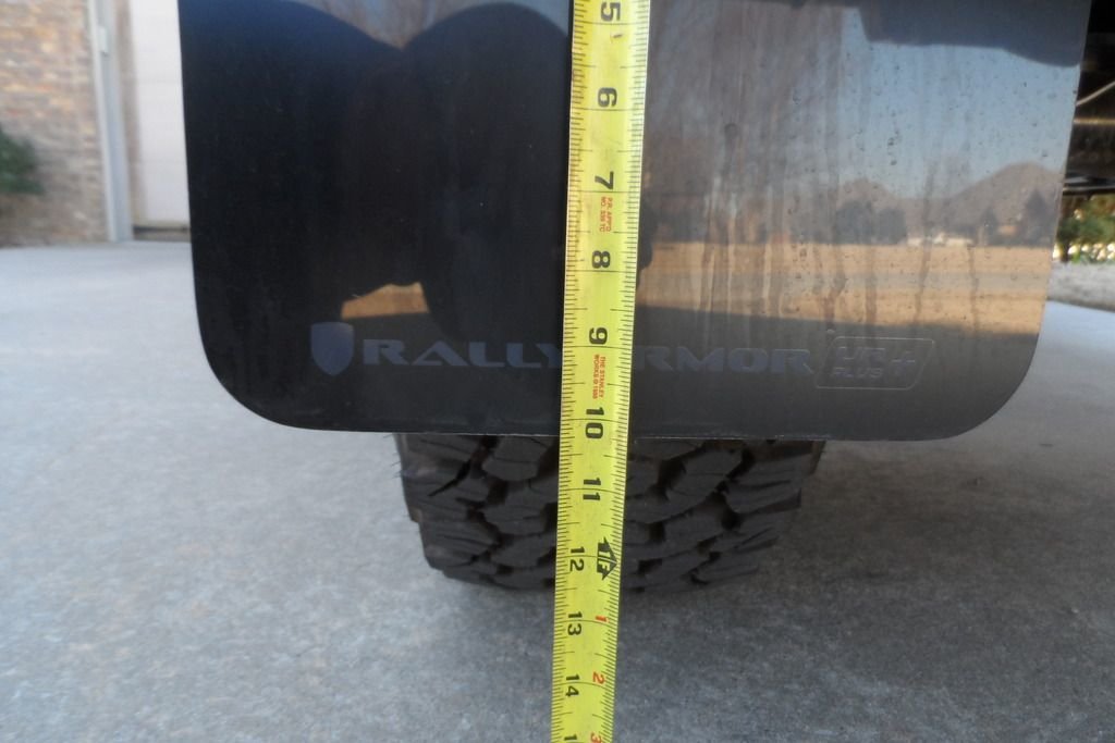

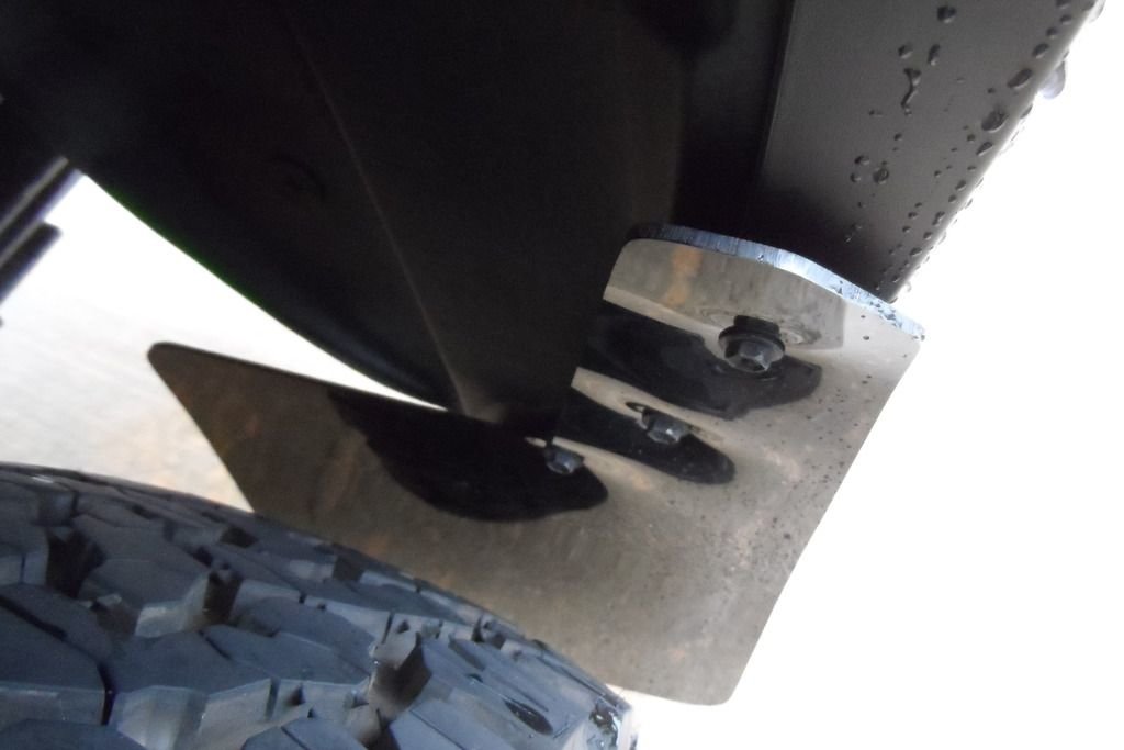

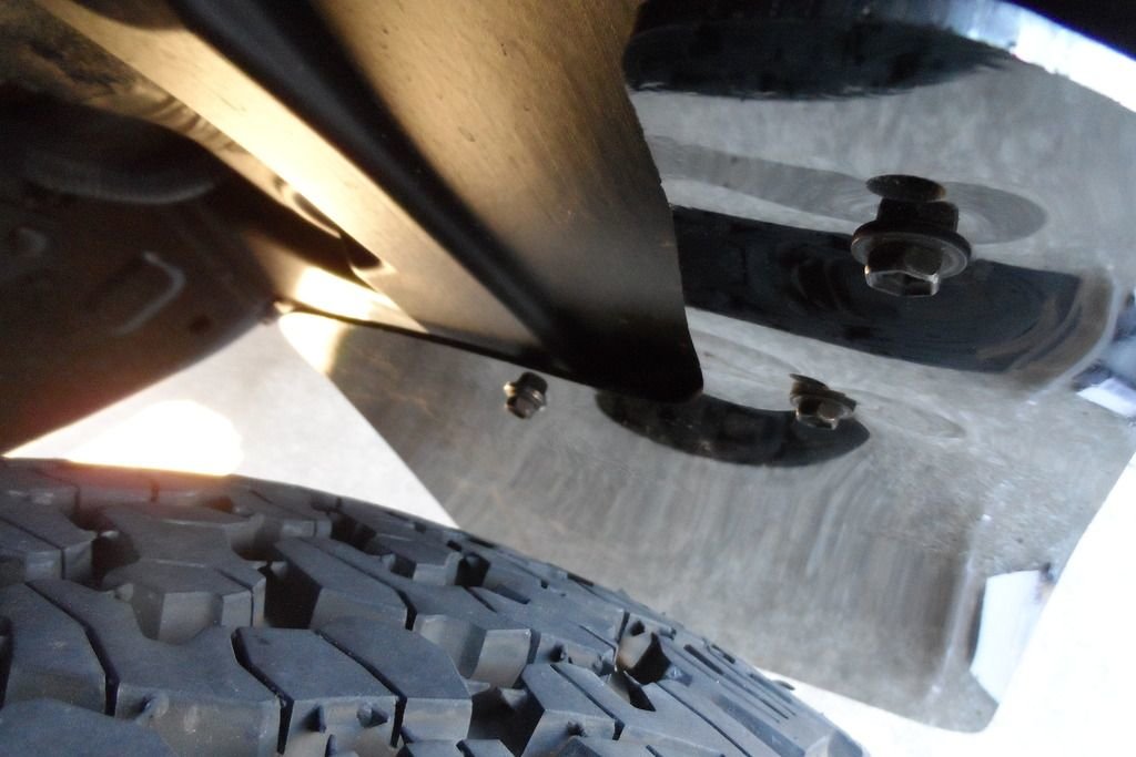

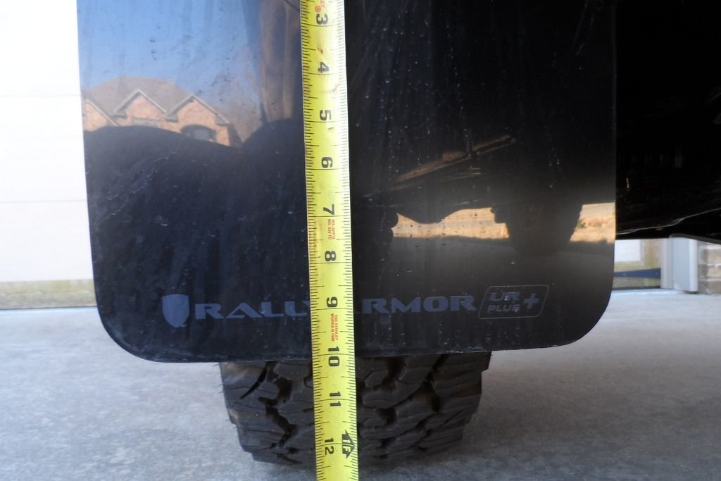

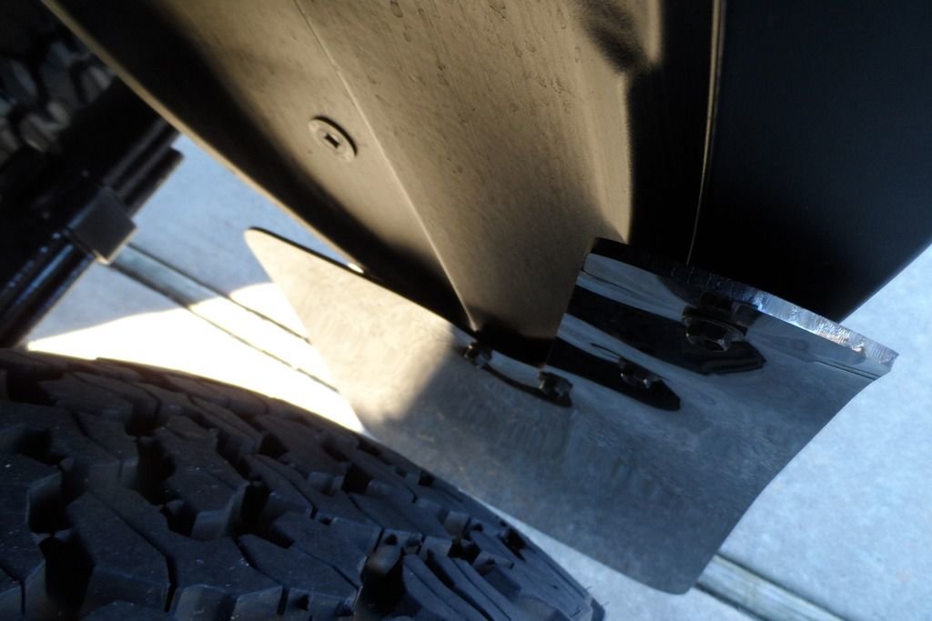

    Oversized...
    I found just using the stock screws wasn't enough for floppy flaps. Having these, holds them off the wheel a little more and straightens them up; inside doesn't hang closer to the wheel than the outside.
    View from the rear; U/J-clips are center of photos.
    Front
    arcticrobot[QUOTED] likes this.

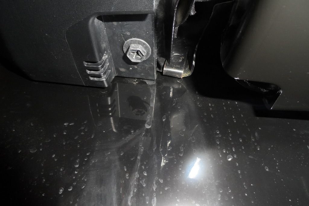

    With marking...
    I traced templates of the Rally Armor flaps and used those to help me find screw holes.
    I oversized the holes a bit as well, to have room for adjustment.

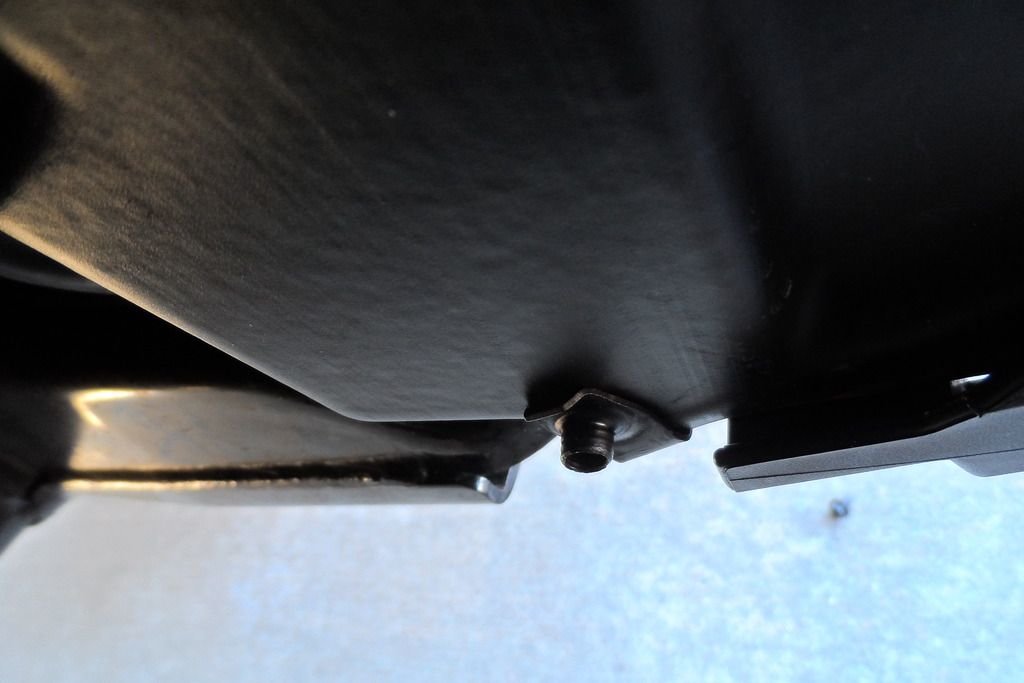

    I went back through my emails and found a write-up I did for several people who had asked...
    "I used some thick paper material and traced a rear and front flap for templates. Driver-side is just a mirror image.
    The key is locating the first screw.
    The top fender flare screws are 7" from the bottom of the flare and the same distance in from the outside, on both front and rear. This made figuring out protrusion and hanging length easier; especially since I wanted mine to hang the same off the front and rear flares.
    You'll notice in my pics how the top holes in the front and rear are in the same location.
    I left the screws installed to mark the holes...
    Front
    Rear
    They are really flexible and required additional inner support.
    Here's what I came up with.
    U-clip front
    Front before
    Front after
    U-clip rear
    Rear before
    Rear after
    Drill pilot holes and gradually step up through bit sizes; it will leave cleaner holes. I think I drilled mine to 1/2"; this left some wiggle room for final adjustment."

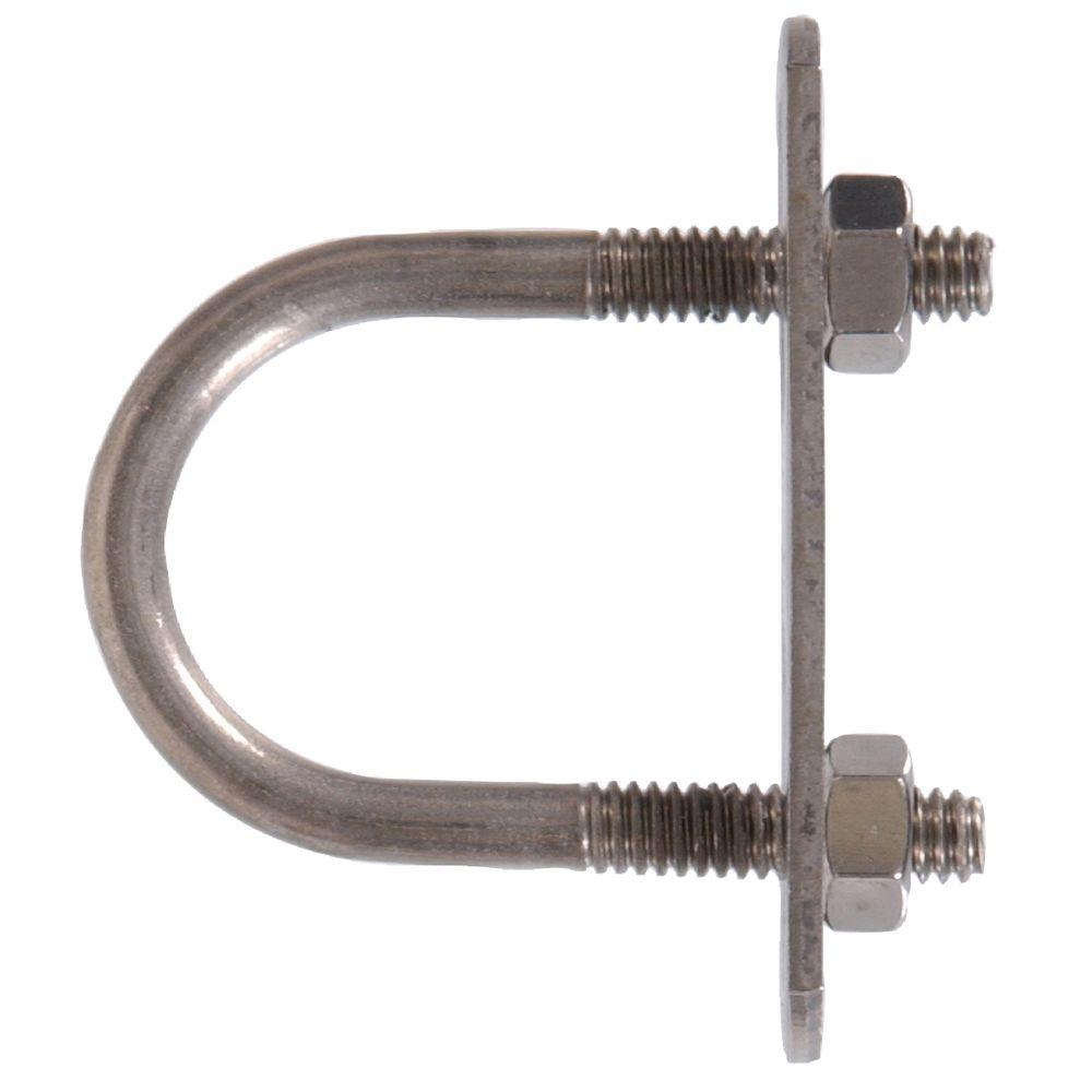

    I used the same process as splitbolt. I got my direct from RallyArmor, not a fan of the big evil Amazon. I mounted my rears a little differently. I bought those metal C bolts from home depot and bent it to fit.
