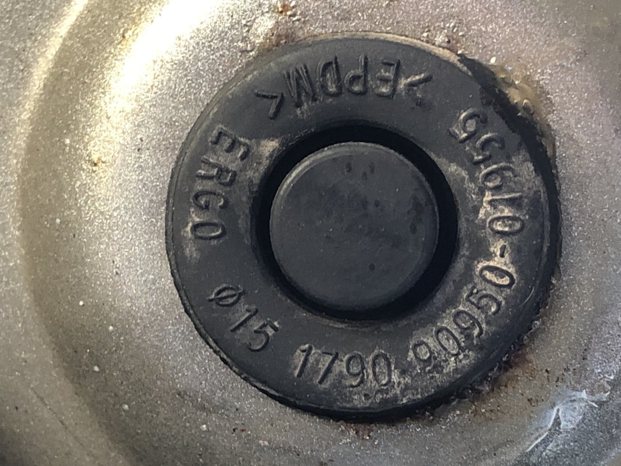

    Just thought I would drop this post here, as others may be looking in the future, and I couldn’t find anything on the 3rd Gens.
    Applied Fluid Film to my 2018 yesterday, and lost a body plug from the rocker panel. Fortunately, the part numbers are on the actual plugs, as I had a heck of a time finding them otherwise. Just in case someone needs that info and they can’t read the microscopic print on the other plugs, the data from my plugs is below.
    The part number for the plugs on the outside of the rocker seam is:
    90950-01956 (18mm diameter)
    The part number for the plugs on the inside of the rocker seam is:
    90950-01955 (15mm diameter)

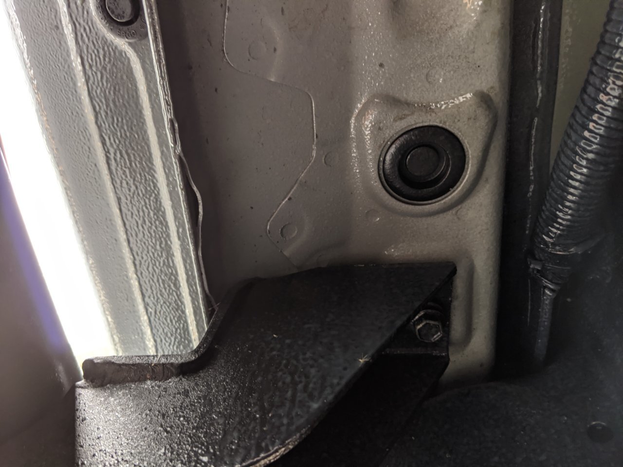

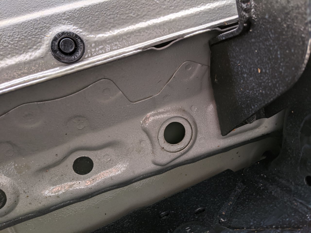

    Hey guys, hate to resurrect an old thread, but anyone know the part numbers for the other grommets under there? I had mine undercoated with Woolwax and looks like they forgot to put one back in. Want to get that hole plugged ASAP, definitely before the winter and salt season starts and gets in there.
    Here's a pic of the opposite side to see what grommet is missing:
    And here it is missing on the other side:
    Unfortunately it doesn't look like the part number is printed on those ones.

    Pop it off, the part number should be on the other side of it. I had to order a replacement one (same plug) awhile back and the number was on the plug

    Thanks guys! Hopefully I can figure it out with these tips. I'll probably pop the one out too just to verify.

    I pulled out the one that was there and it looks like the part number is 90950-01959. Now hopefully they have them in stock at the local dealer!
