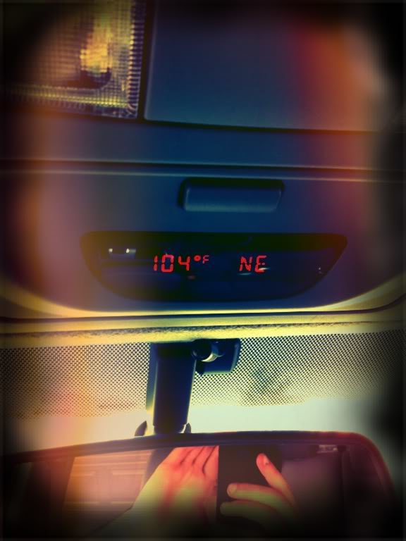

    I think we're on totally different pages here. 85 is lovely. This picture was one of the cooler days this summer where I live.
