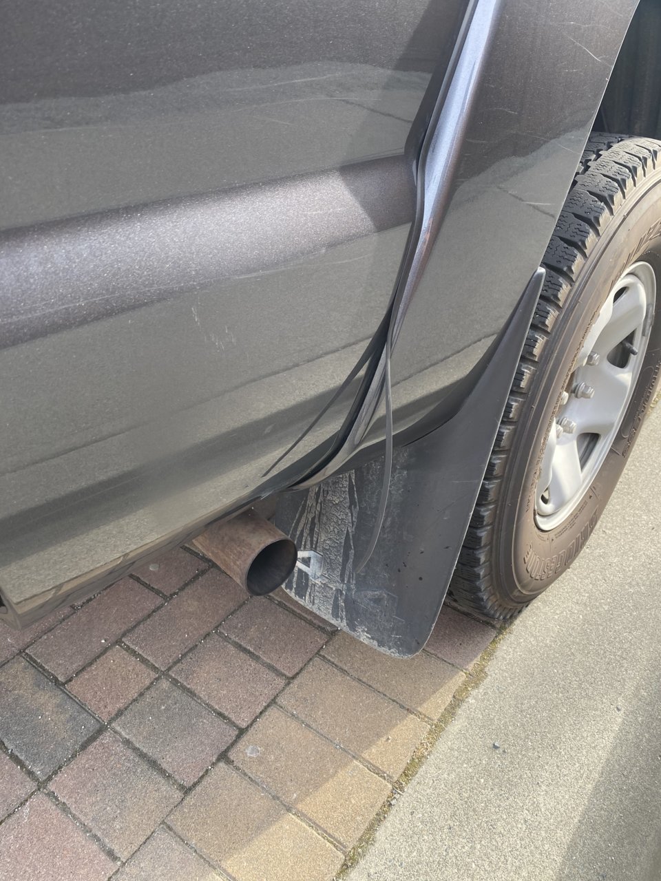

    Hello,
    Looking to get the rubber seal around my rear fender fixed. Anyone know the best way to re-attach it again?
    Cheers,
    Devin

    Looks like its ripped. When I removed my flares it looked like that seal was glued or taped. Might have to replace it all together. fender flares are easy to take off and put back on.
    https://www.amazon.com/dp/B00FWPHRBS
    Might have to replace the little clips too cause I snapped a bunch of em when I did it.

    They’re just held on with two sideD tape. You can just put them on with the tape that’s already attached. Or put some time in and remove it(the two sides tape) clean the little black strip and put a very thin bead of weather strip adhesive and install. Option one is much easier.

    I used small fine tip painters brush and used contact cement and applied on seal and fender contact area . I left the 2sided on and it held so far .
