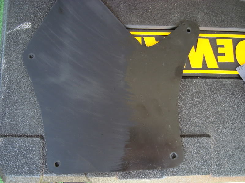

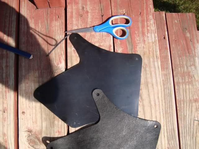

    Neoprene was the solution I chose, because the other stuff was too thick. It is was tougher than the crap on the truck. I bought enough for 4 pieces. Material thickness was 1/8". I think they turned out well. All for $18
    I traced w/ a pencil and cut with scissors
    Then I hit the shiny side with emory cloth and drilled the mounting holes

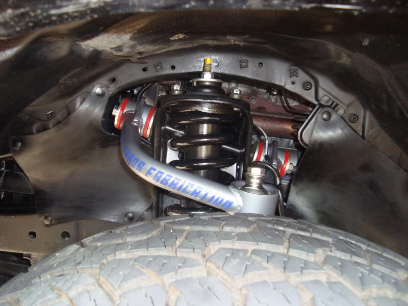

    Here they are mounted

    looks sweet man....did you reuse them clips or did you buy them new????

    I reused the clips and pulled the hole over it.
    BTW, do you guys know the part number of those clips? They are not the ones like the grille & mudflaps. The online parts schematics do not list the part number.
