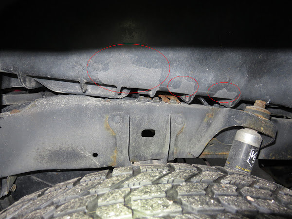

    I think the cracking still happens even when it's done "properly", just the onset of cracking is delayed. The corrosion continues underneath... After a while the coating drys to a dull gray color. You can see the coating overspray on the bed plastic:
    uBzMYfpURqP4HQHu2rp7SGYksyKr7qA1jcCFSz1w_336e4640305a613270363ccae6b20acb509671b8.jpg

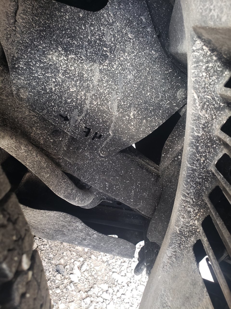

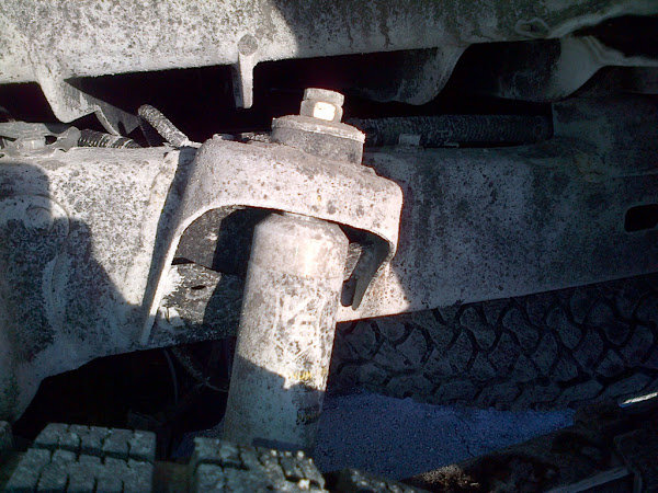

    Note my area sees a lot of road salt. This is what the frame usually looks like for 4 months each year. I go through a touchless car wash with underbody sprayers whenever the temps go above freezing.
    bYEj6gIE01sKOiD_va-U5oGnqCa5EYcUXclP7bFc_388a396e9f6d602145ebb022d817e1f528364b55.jpg

    Yea, i was looking at those spots on the inside of your bed earlier and was thinking if that was the coating. I mean it shouldnt just disintegrate only after 4-5years, seen other cars with that shit and it looked good. Thats pretty bad man, you got some kind of warranty right?
    If this happened to mine like this i would be furious. Mine still looks pretty solid and its black after 1.5 years. I will be keeping my eye on it though.

    Fuck I'm glad I don't live in the rust areas. This shit looks like a fuckin nightmare.

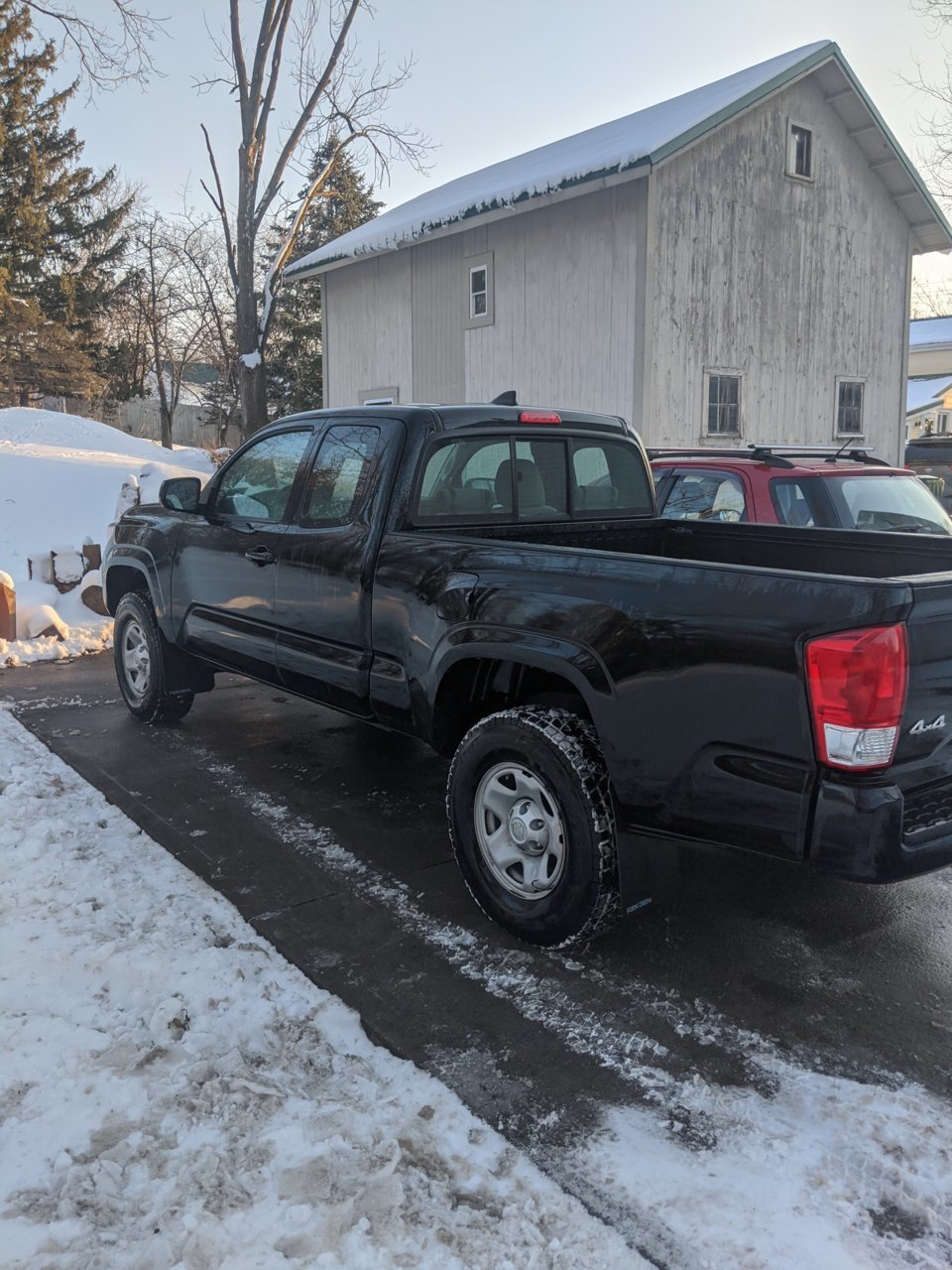

    Today it's above freezing and I have a hot water spigot so the taco got de-salted:IMG_20191221_154206.jpg
    Tomorrow is supposed to be above 40F so I'm going to do a mavcoat/fluid film touch-up.

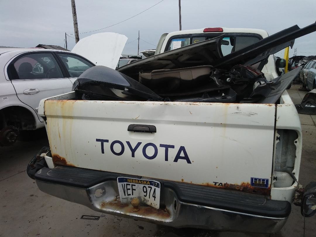

    i would not go as far to say that body panels do not rust on the old tacos, pic from the local salvage yard a few months ago from a truck that 'slipped through the cracks' of what happens at the end to a truck on the western fringes of the mid west salt belt...

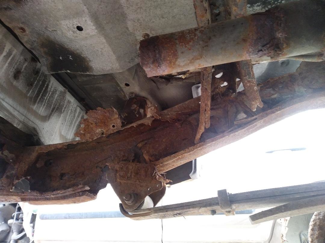

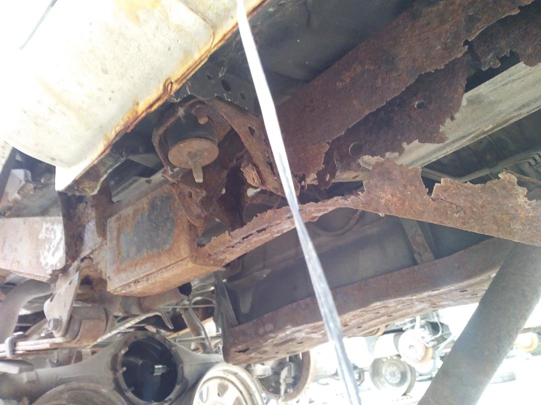

    and this is what was underneath of this 3.4 single cab, abandoned on the side of the road with a window sticker notice to 'please remove vehicle from the road' ...
