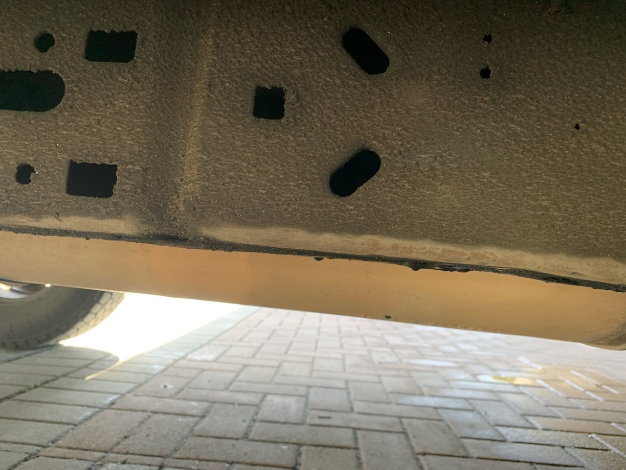

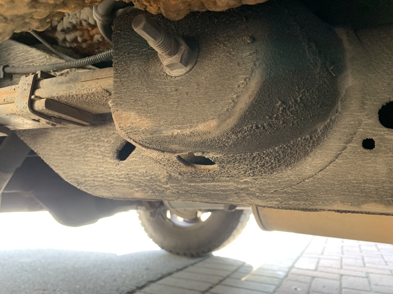

    At work We have a fleet of about 55 Chevy express vans that get “tar” like undercoating done. These vans get abused and never get the undercarriage rinsed. I’ve been there for 10 years, some vans are 15-20 years old. Not a single rust issue on any of these vans. I’ve never heard our mechanic/manager/president mention anything about rust issues.
    I think folks that say moisture/salt or whatever else “creeps in” behind the undercoating and creates “pockets” have absolutely zero experience with rubber undercoatings and are just echoing the same BS that others are saying.
    They key is, to get it done properly when the vehicle is new. I had vulcanized rubber applied on my frame and bottom of my cab, 99% of it looks like new except for some rock chips and I can guarantee you nothing is “creeping in” behind the coating haha.
    It’s a rust preventative coating that will not let anything rust underneath it.
    This is the pic of my vans frame, looks great if you ask me. Never rinsed the undercarriage and zero maintenance/touch ups.
