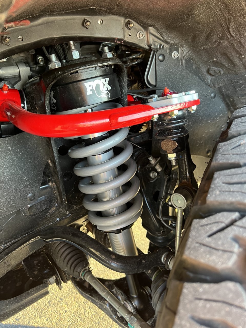

    Can you get a picture of the cams?

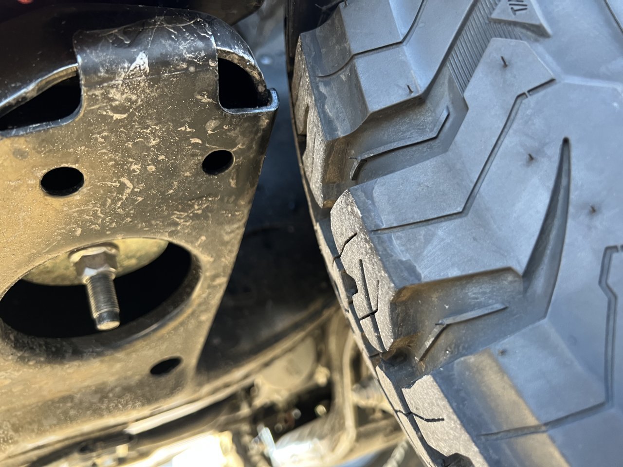

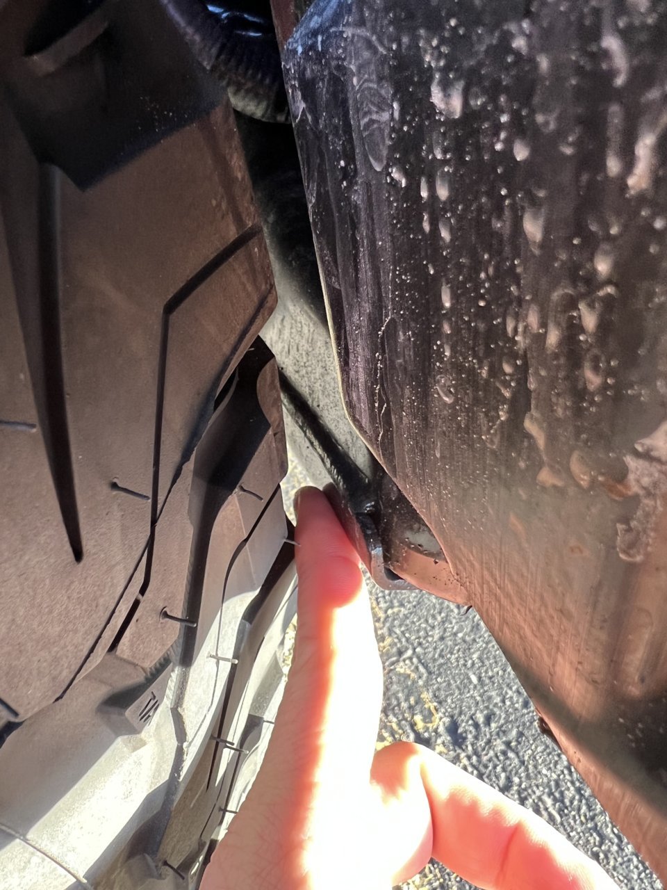

    It was rubbing on the wheel well and I did some trimming. But yes it rubs cab mounts at full lock or when turning with compression.

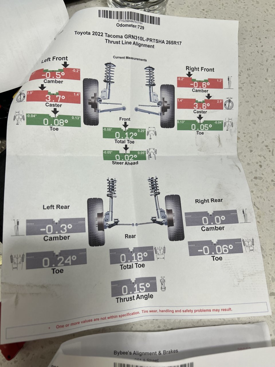

    Care to share the new alignment sheet and some pics of your setup?

    Your camber is still out of spec. Did they do anything at all? Take it to a different shop to get aligned and see if you can get your money back from the first one.
    Your caster is out of spec as well, but many of us, including myself, run with more caster than spec and don't think it's an issue. Camber on the other hand can lead to uneven tire wear and handling issues.

    They said that the camber was the best they could get.

    That's nonsense. I'm guessing what they meant is that it's the best they do with the camber when the caster is maxed. If that is the case, I suggest you let them do a normal alignment with no constraints. I'm pretty sure people fit 32's without doing anything special. The talk about moving the wheel forward in the wheel well using an alignment usually involves 33" and larger tires.
    If that is not the case, it sounds like something is messed up on the truck. Hopefully that is not the case.
