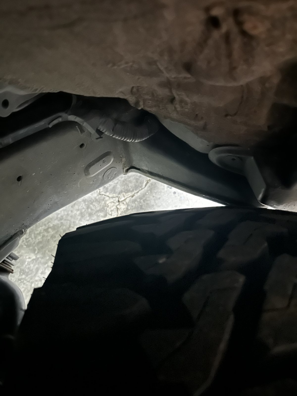

    Hopefully these are clear enough.

    I would try pushing a touch more caster with an alignment but I'm willing tp bet it's chopping time

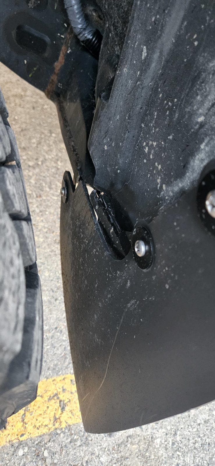

    Definitely not 12.5's only way you will see me on a 12.5 wheel is in a 35. 295/70 or 285/75r17 is the sweet spot on these trucks if you want a big tire with the least work. Even then I'm debating gusseted spindles.
    I wouldn't truly count on the alignment working. With spc ucsa's good alignment and 285/70 on a 17x9+1 I cleared the cab mount but you can see where it touched the mud flap

    what mud flaps are these?
  13. Mar 24, 2024 at 5:03 PM
    #33
    Veet-88
    Veet-88 Well-Known Member
    May 21, 2015
    #155792
    1,794
    18 Tacoma DCLB sport
    Rokbolkz XL
